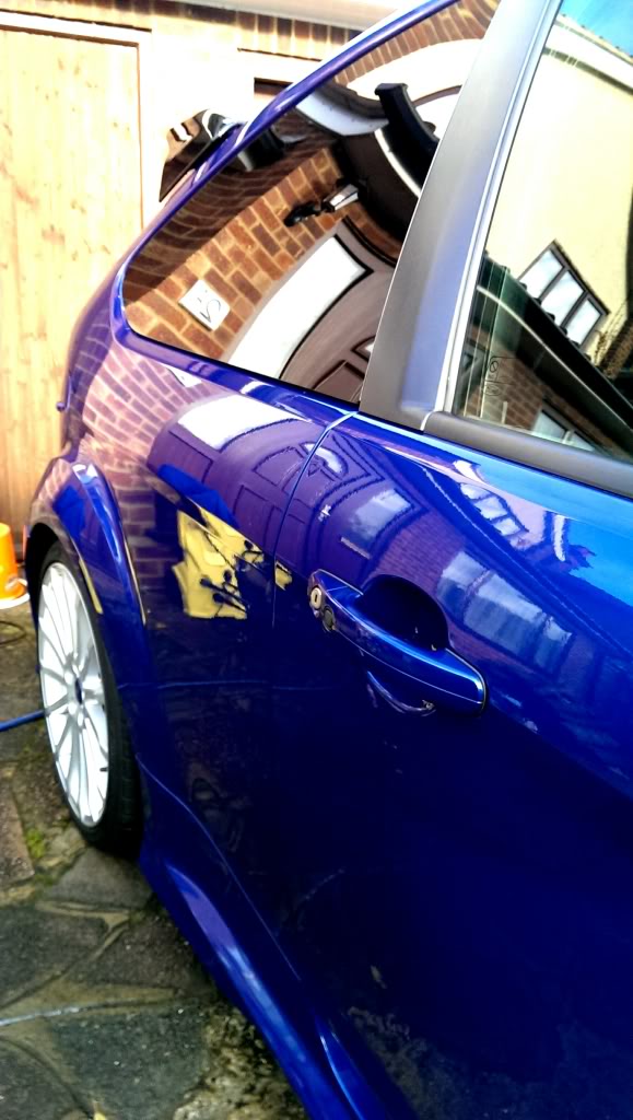

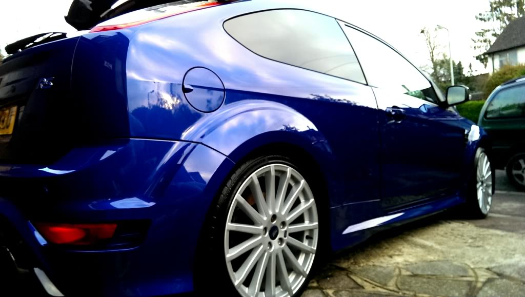

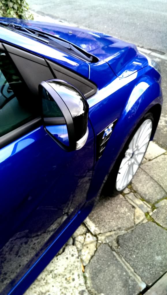

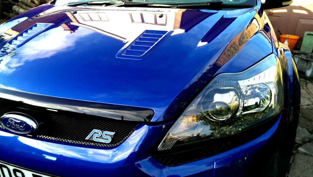

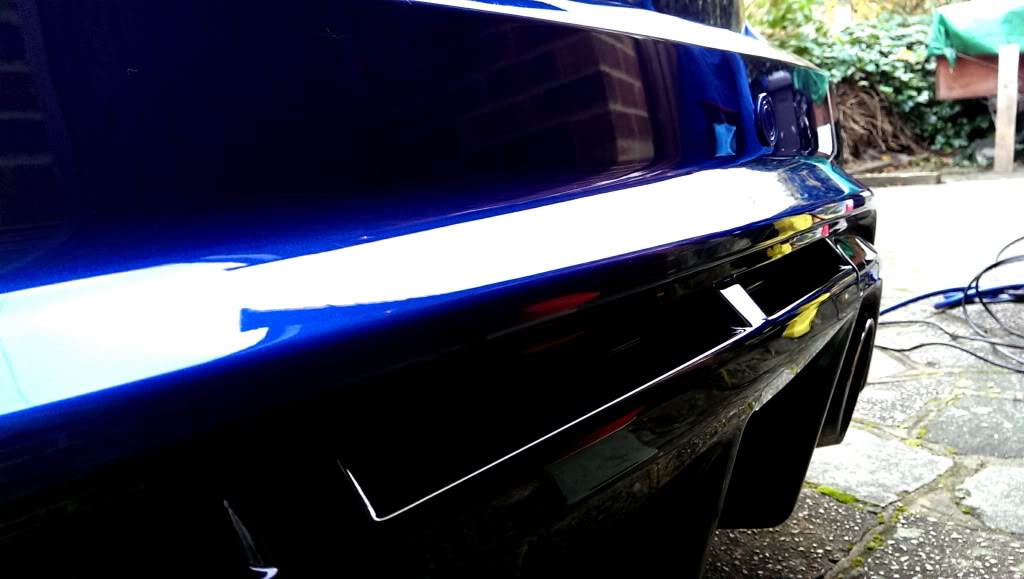

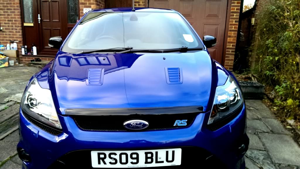

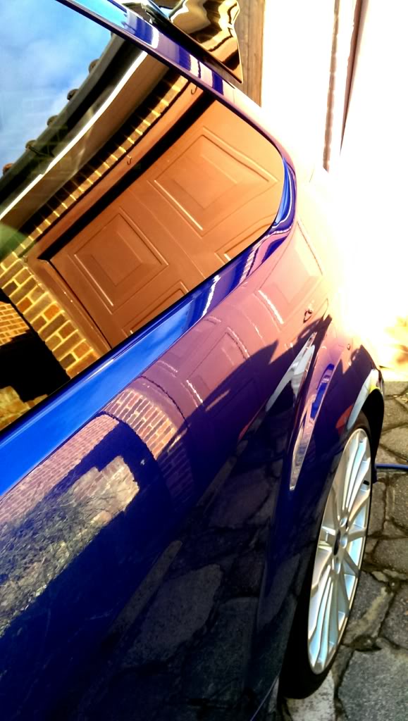

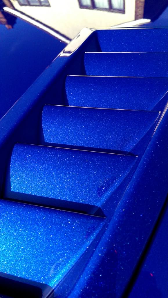

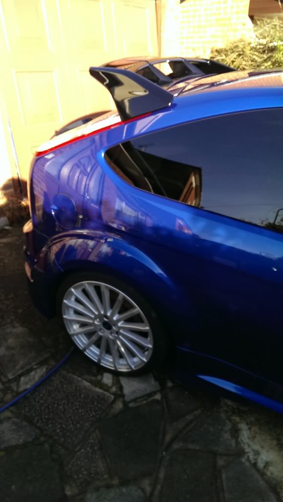

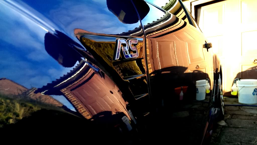

I absolutely enjoyed every moment of today. Was a pleasure to meet Guy & his father, nice people :approve: So, Guy dropped her off at 8am this morning, finished at about 3pm. The car has been looked after really well, but could do with paint correction as we discussed which will hopefully happen in the spring as I loved working on this beast! :eek:

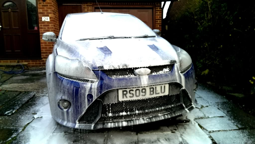

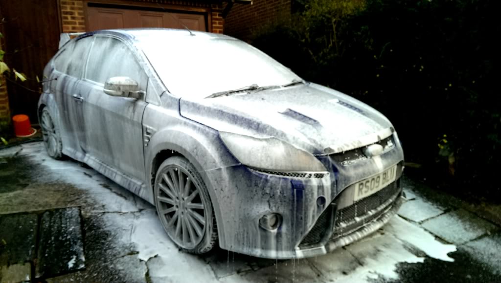

So the process was -

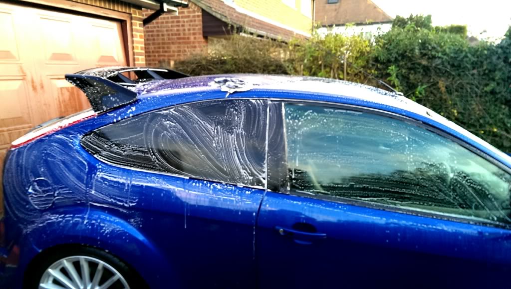

Snow foam mix with btbm

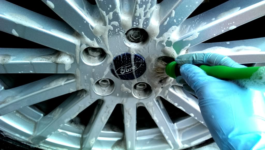

Wheels/tyres cleaned with Imperial (Really liked this, although smelt just like Smartwheels?)
G101 for the arches, nooks & crannies
Washed with Carpro mitt & btbm
Iron X all over, not much to report on there.
Oblitarate lower panels
Clayed with Megs bar & DJ lube
Snow foamed again
Washed
Towel dried
Windows cleaned with 3M
Hand applied Tripple with a mf app x2 Coats as I wanted max coverage
Z6 wipe down
Autofinesse Illusion applied - Love it, gave such a deep glow to the finish
Z8 wipe down
Tyres dressed with Perl
Trim's dressed with Dressel - This worked best on textured plastics imo, perl was far better on the rubbers
Door shuts polished with Tripple
Hopefully Guy will get some Hydro2 to use for his maintenance washes, this stuff is awesome & really does add that bit extra.
Cheers for the pleasure Guy :D

Thought you preferred them with black bonnet grills?
Why do people wipe down with Z6 after applying a cleaner/glaze? Is there more to Z6 than just a detailing spray or something?
Gally
Adds gloss. Hence layering Z2 etc. black bonnet vents should be burnt to death!
