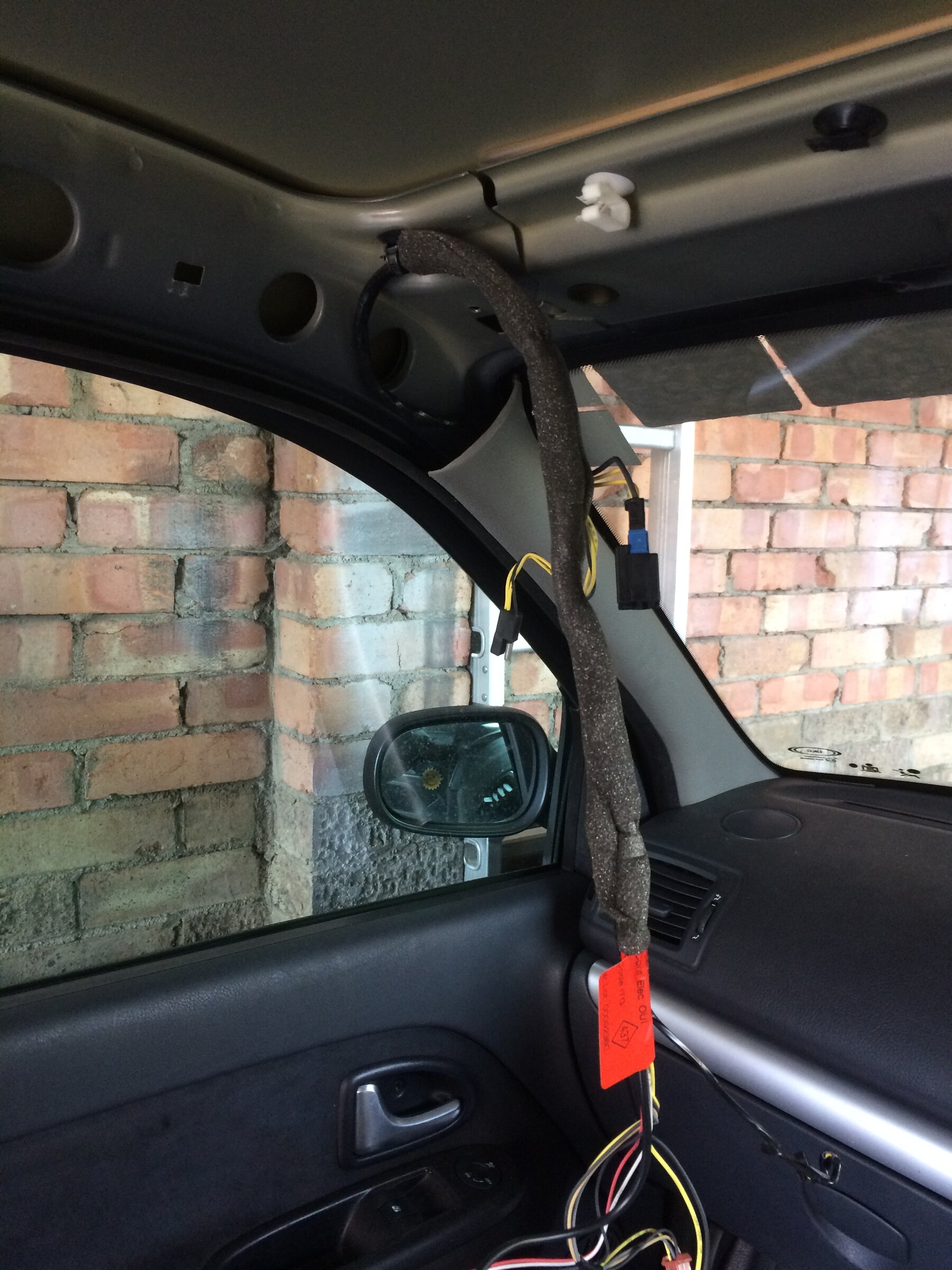

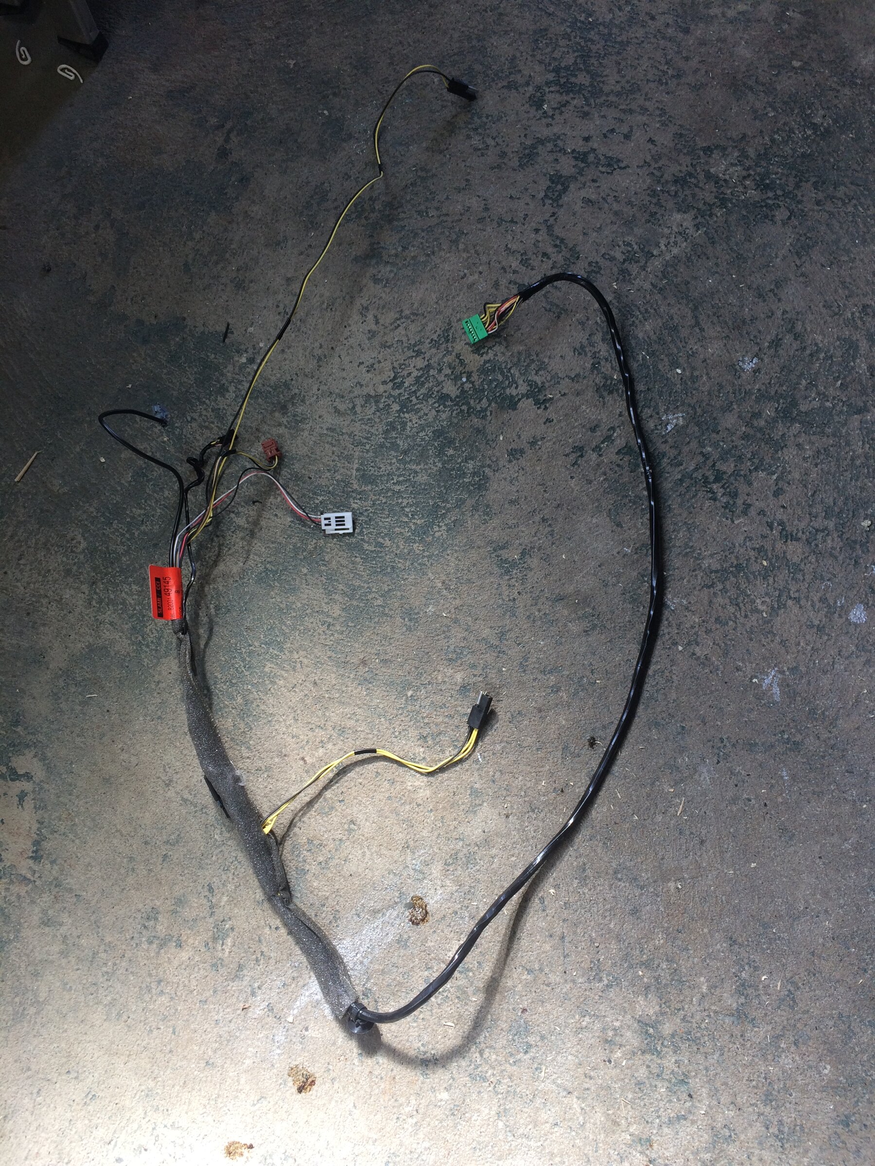

A question for those who have a bit of auto electrical knowledge unlike myself. I’ve removed the roof lining and obviously I’m left with the wiring for the interior light and vanity mirrors...
Question is.. can I follow this back down to the corner of the windscreen and cut it off? Or should I tuck it away behind the plastic cover on the pillar to avoid warning lights on the dashboard?

If you actually follow that loom down into the dash you will find it plugs into the main loom just underneath by the tweeter. Im not saying you should do this but if you gave it a slight tug it may just come un plugged. Else pop the dash off to un plug it.

Cheers mate. I’ll be able to try it soon. Any resistor bodge possible?
I've seen that having the rain/light sensor unplugged can bring just the SERV light on.
You'd have to try it...
Tried it! You were right. Serv light on. I don’t have access to ren clip so unless a simple solution comes up I’ll probably butcher that bit of the loom and reinstall the light/rain sensor.

If you know anyone who has a multimeter, you could get them to test the resistance of that whole section, on the plug that splits at the dash.
Then just buy a resistor of that amount. That should work in theory.
