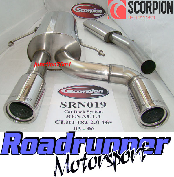

My genuine Renault 182 Exhaust rotted away and needed replacing so I bought a Scorpion one, its far too loud for my liking and I need one which sounds quiet, like the Original one. I can't afford the original renault exhaust as its over £800!

My Current Exhaust is the Scorpion SRN019 and i've read that the Scorpion RS192 is nearly as quiet as the Genuine Renault Exhaust.

Does it have a centre box and two rear boxes?
If it doesn't have a centre box, then it will be loud.
If there is no centre section, an option might be to get one fabricated in at a decent exhaust centre.
It's not unfortunately. It's quiet, but a long way from standard in my opinion. Best bet is going to be a second hand standard system, or a system with extra silencers built in, somewhere custom like AAS or Prospeed.

This is the one I have:

A single box is generally always going to be louder than a twin. What made you pick the "imola" one?
