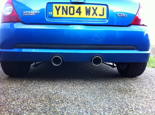

hey ppl, just fitted a ktec supersport system to my 182 today and cant fault it, although i am having problems lining it up propperly. the std system never sat right either which drove me mad!!
any tips?
i have already replaced the rear mounts as they were badley perished. its the drivers tailpipe that sits back futher and the whole system seams to point to the right

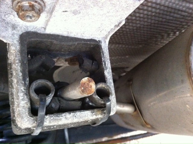

Even with sockets in place, this happened to mine:

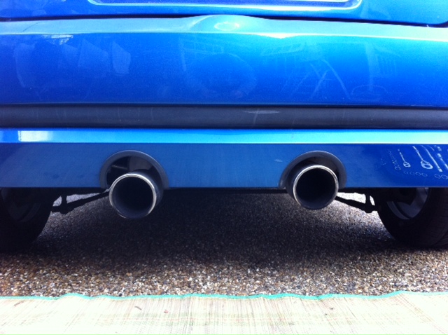

Resulting in:

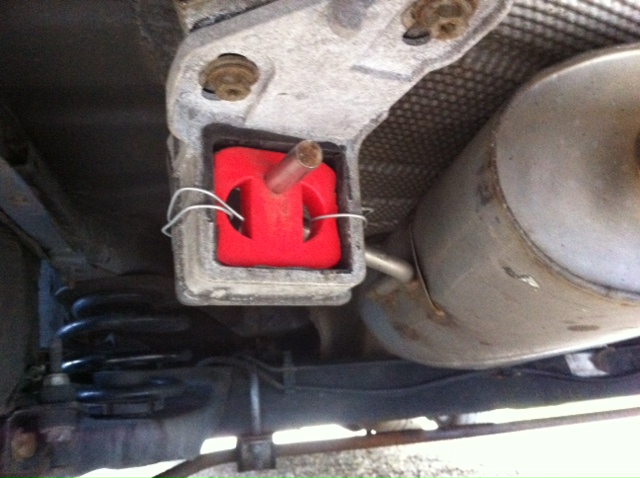

Get yourself two of these - http://www.ebay.co.uk/itm/POWERFLEX...arts_Vehicles_CarParts_SM&hash=item3f0f1ee640
...and do this (the wire is temporary, I couldn't find any cable ties at the time :D)
So now I have this...
There is still plenty of play in the system, and it's now aligned and I know it won't move or sag again :D
