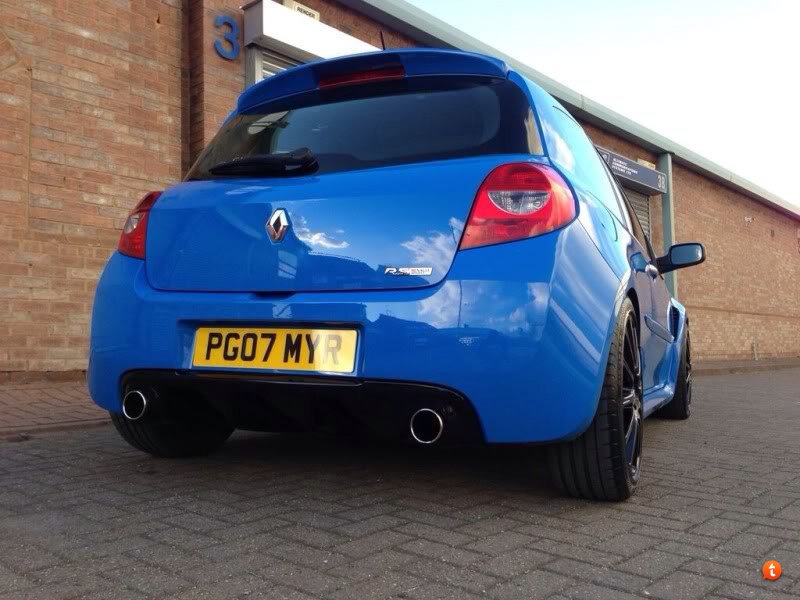

As some of you may know i have just picked up my 197, it has a 200 diffuser attached so would I be right in thinking that i need a 200 exhaust fitted so that the tailpipes do not melt the diffuser? or does it not matter either way?

On my brother 197 with 200 diffuser, the previous owner had some exhaust trims made up which stick out of the bumper.

Sorry probably should have made it more clear.. i already have the 200 diffuser on my 197 with the standard exhuast... im looking at getting an after market cat back and was wondering if i needed to get the 197 or 200 system...

when i had an exhaust on it i had a 200 exhaust, the only differance in a 197 and a 200 exhaust is the 197 system has slash cut tips.

But yes, a 197 exhaust (slash cut, not extending out of the diffuser) will melt a 200 diffuser... The exhaust gasses being trapped in the diffuser can't be good either

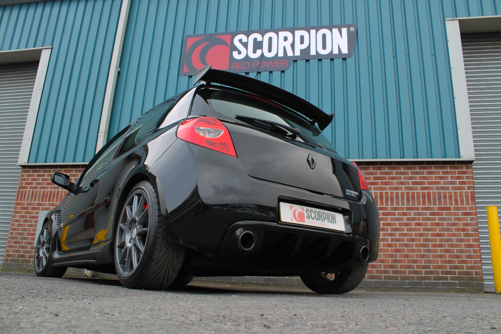

For any one interested I seriously recommend scorpion exhausts for 197/200 the sound is epic, just need a map now to adjust to it, will post videos soon
