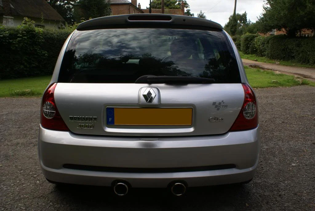

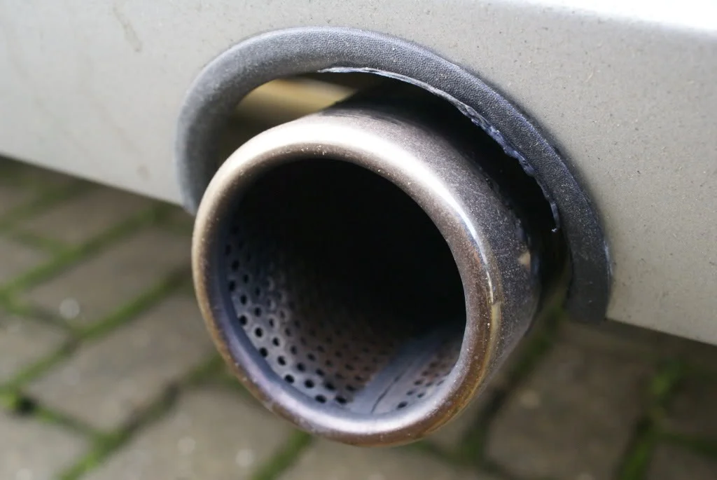

My Exhaust is sat slightly to the right, and after my blast round Abingdon airfield it's melted the sh*t out of one of the bumper exhaust surrounds.
I'm not really sure on what to search for, but basically i want to know if people have put some padding in the brackets to push it over the other side. And what can you use as the padding?

Its a Ktec exhaust. It was slightly melted when i bought the car but it got really melted after my trackday.

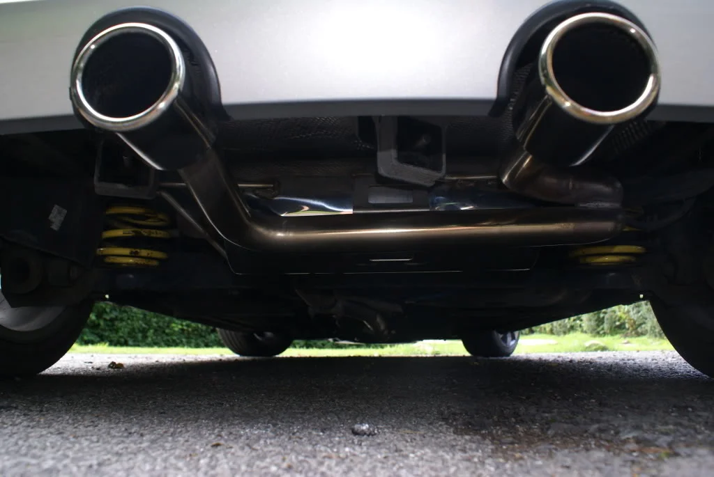

not sure if its just the angle of the picture but both pipes look out of place to me (like they've been bent in opposite directions)?
a little bit of hose pipe or an old socket . cable tied into the exhaust mount.

Its a bad picture really. It's been fitted very well. It's just a tiny bit over to the right. It must just vibrate around a but when i'm ragging it about.
Cable tieing it should solve my problem and then i can buy a new surround :)

Mine did that at first, can't remember why tbh! Something to do with movement from the engine, and heat in the fresh pipes iirc, but i'm no expert. We had to stick a bar in it to nudge it back, run it, and repeat a few times. It moved slightly on the long ride home, but soon settled down, and it never really happened again. Not very helpful maybe, but that's what happened to me.
