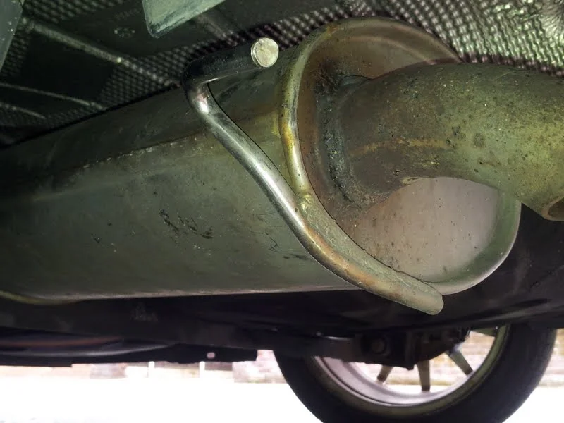

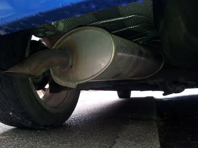

So ive got a yozza race stealth on order, but in the meantime the previous owners bodge job of sorting out exhaust hangars has failed.
So at the moment the exhaust is sitting on the middle hangar (also needs replacing) and is un - drivable as the backbox is hitting the crossbeam thing.

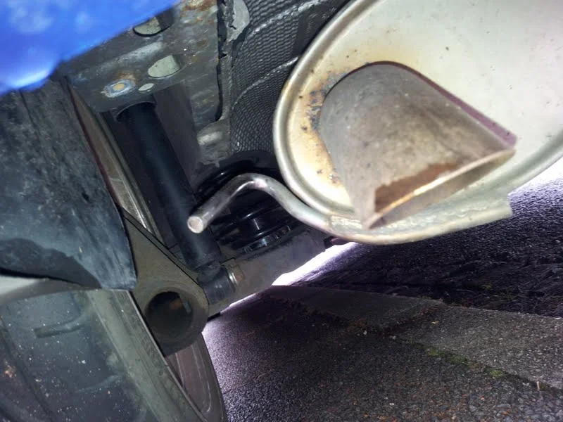

Now I had a go at changing the rear mount the other morning, but I could not get the exhausts pin / mounting point to line up with the hangar :S.
So my question is, is my exhaust standard and does it look normal / ok to you guys? see pics below.

The hangar looks totally wrong to me. It's either a sh*te job by a custom exhaust centre like powerflow or that backbox was not originally inteded for a 172 and has been bodged to fit.

hmm yeah the hangar just doesn't seem to be at the correct angle to fit the OEM hangar. I need my new exhaust quick to get this sorted for next week, but in the mean time, any suggestions on how to get a quick fix on this?

So as it turns out it was a crappy powerflow back-box, don't know about the mid section. Its currently getting a new BTB stealth fitted as we speak:D
A tip for when you do replace the middle hangar - put a thick cable tie around the rubber to reduce the sag. With a custom made exhaust a new middle hangar lasted 4 months before snapping for me.
