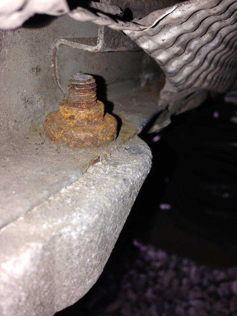

In the process of swapping my zorst mount in my 172. Got one bolt out, made a move onto removing the second and it won't budge. The first bolt had a 13mm nut in the back, guessed the second one was the same...it's not. Anyone know if this is part of the car or another nut that is properly corroded? it looks very round!!

It's not a nut, it's welded to the car for the bolt to screw into,
and it is perfectly round, mine has broke free of the weld and stops the bolt from unscrewing,
they're a f*cking pain in the arse tbh.
Spray a load of WD40 on it and let it soak, the bolt doesn't look as bad as the dohicky,
hopefully it'll unscrew without breaking the weld.
Did that...the bolt sheared off at the halfway point. Couldn't be more fuming. The zorst is even more wonky now and I need to take it to a garage next week. :/ f**king s**t cars! Haha.

I'm going to zip tie it up more tomorrow and nip the one bolt up a little but more just to be sure it's not going to drop! Hopefully the garage im taking the car to will just drill the snapped one out and replace them with new bolts. Going to ask them to grease everything up as well to stop this happening again!
