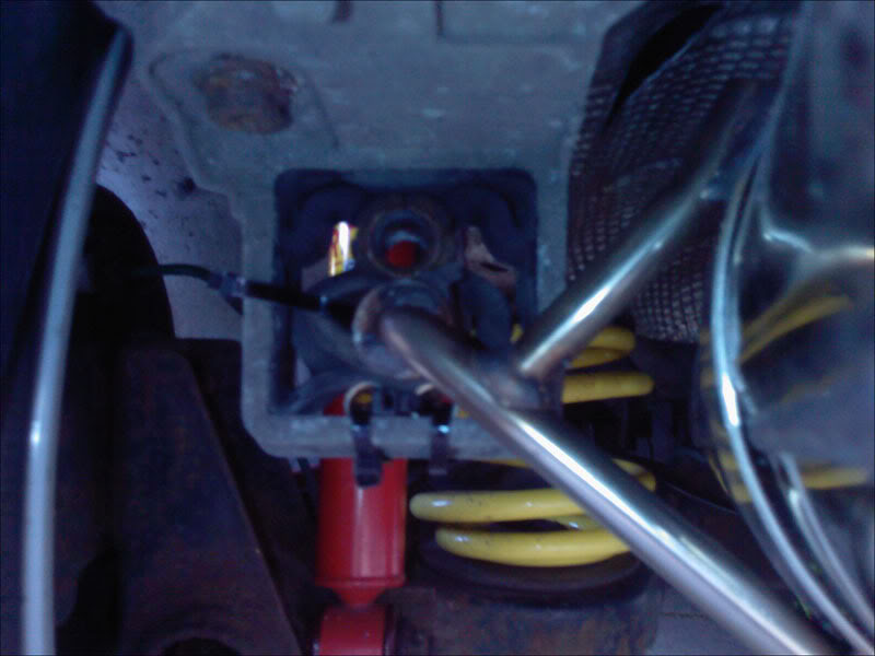

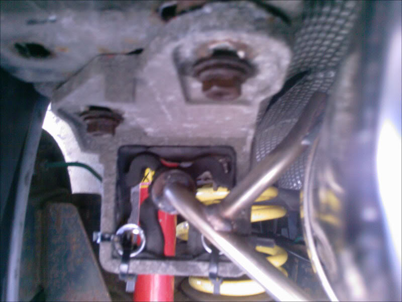

However not long after picking it up.....wait for it.....the rear exhaust mount failed (shocker).
I had a go at bodging it but it still sits too low for my liking;
As you can see he's not used the standard rubber mount but packed in a new (ish) rubber but it clearly isn't working. Shall I take it back and ask them to order a new mount in or shall I take the rubber out and slide it into the standard hole and try get hold of some bigger tubing to hold it up?
Sounds the nuts though and I'm very pleased with it although I dare say I would like it to be even louder.
I had this problem, as you suggested for a quick fix put the exhaust mount through the standard rubber hole & then cable tie the other rubber or a socket under it to keep the 'X' in the centre of the mount.
That should bring your exhaust up a tad. Worked for me, but am gonna call in to Renault & get some new mounts soon so my yozza get's the mounting it deserves :approve:

Thanks guys, I spotted the guide, looks fairly simple, I'll have a go at it in the morning.

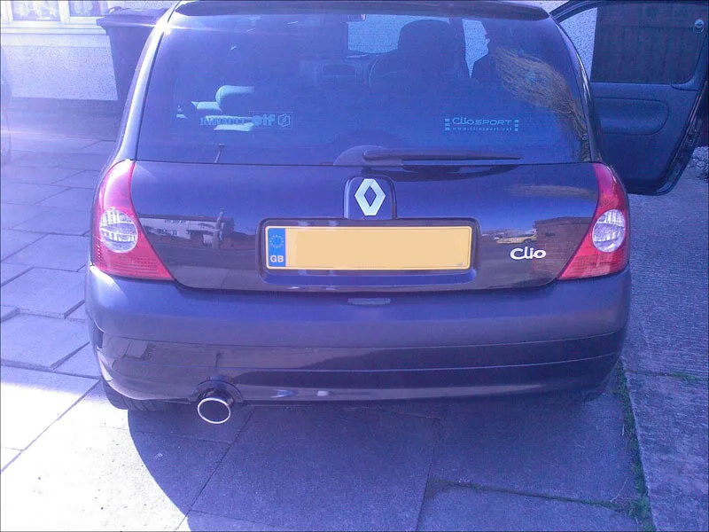

This is how it sits now;
Sits firmly in position now as it should but there is now a knocking noise on startup and whenever the engine gets aggresive which I think is part of the chassis at the rear which has about 1mm clearance from the backbox so I'm unsure how to solve this?
I'm thinking maybe stick the rubber I removed from the mount before but seing as it's thicker than the gap that's there it may be touching the exhaust constantly, would that be a bad thing?
I was told there is an uprated bush for the rear exhaust mount by powerflex is this true?
