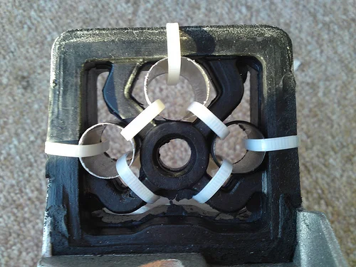

After getting fed up with the frequent replacement schedule I decided to do the proper thing and reinforce the new one before I fitted it.
Parts used, 7 cable ties and 3 pieces of steel tube approx 1 1/2" long, one was 1" diameter and the other two were 3/4".

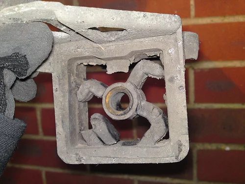

Dead old one:

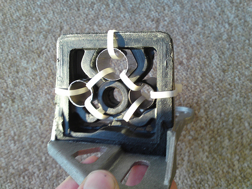

New one:

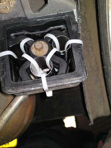

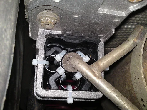

And now in 'Stealth' fitment......should do nicely!
