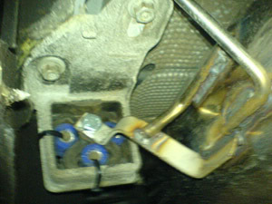

I've been getting some dodgy noises coming from my car for a while now, mainly when turning the engine off.
I've just had a little look at the exhaust & the below pics are of the exhaust mount next to the back box..
Correct me if i'm wrong, but it looks to me like it's slight... Knackered!
I take it these parts can be bought pretty cheaply? & are they easy to replace?
Or is it best to take it to an exhaust place & get it done.

yep its fucked, cost about £20
just bolts on/off
but will be hard to do if not on a ramp, you can do it tho;)
Do not buy a new one, the same will happen in no time.
Buy an oval type mount for around 50p, cut the old one out of the square mount, slot in the new oval and cable tine in place. Job done.

The 50p option is the better option is it?... where would i get this 50p oval mount?? & do you just get the old bit of rubber out & whack the new peice in then cable tie it up? sounds slightly iffY??
Mine went to after fitting new ss system as above i got a couple oval ones and cable tied it doesnt move an inch

It sure is. Any motor factors should sell a range of mounts. Just find one that looks about the right size. It's much stronger than the standard mount, trust me.

Its a good idea, but on that exhaust the metal bracket around the box looks like its on the brink of snapping off, The renault mounts allow for lots of movement and an easy ride on the exhaust. Its also advisable to change the middle mount at the same time.

Lol, well its a good idea to replace the middle, if you just replace the one at the rear with a new (or stiff modified) mount the old one in the middle will be more worn and slack causing more stress on the exhausts weeksport. My bracket was coming loose so payed mr tyre £5 to put some extra welds on it.
My centre mount was a new Renault item but it still had too much slack in it. It now has a large jubilee clip formed to follow the shape of the mount cable tied around it. I can loosen or tighten the jubilee clip to the exact position I want setting the height accordingly. Job done.

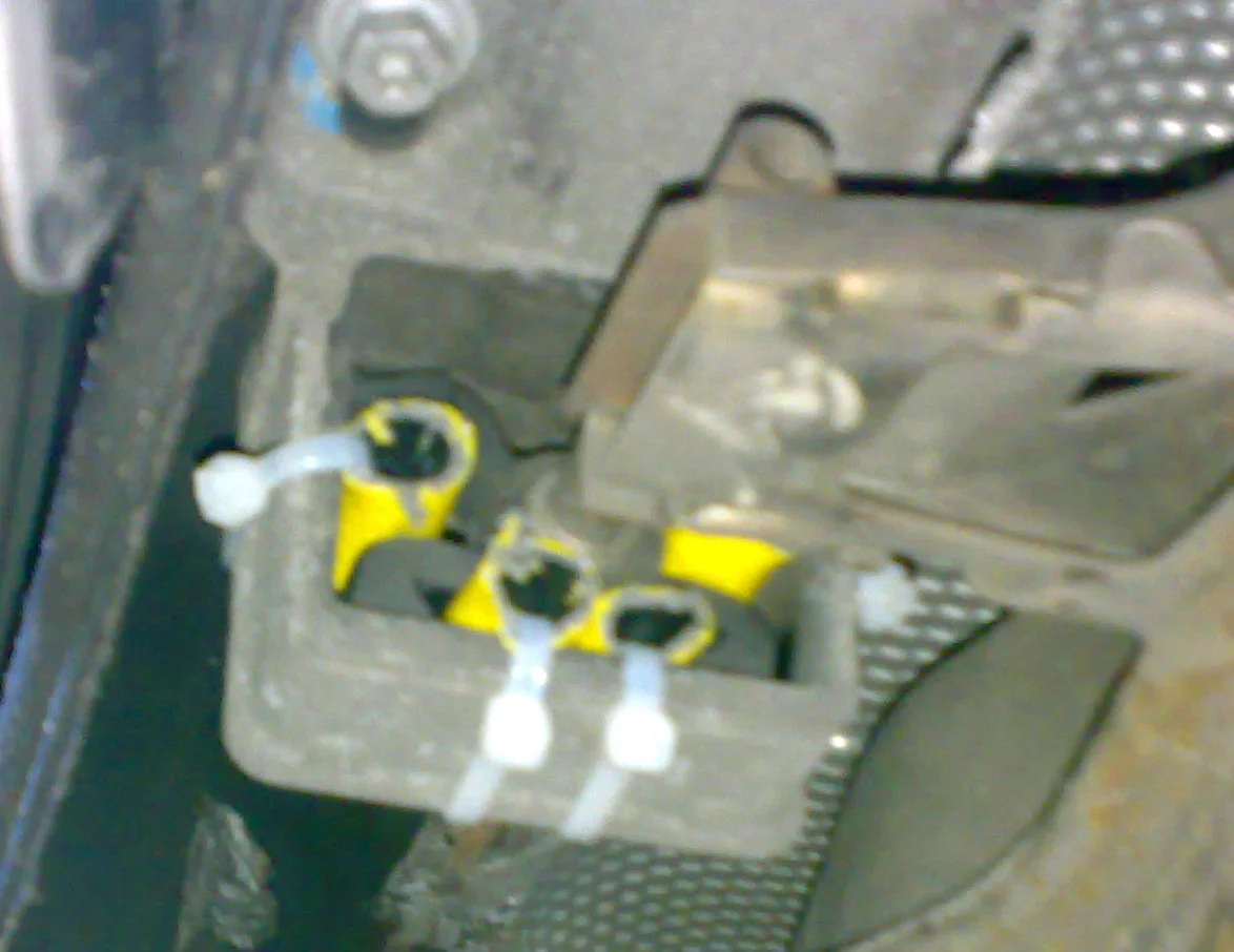

Can this thread be made a sticky ? Ha dsame issue and was about to go buy a new mount from Renault when I saw the pic Day posted.
15 mins rolling on the floor later at home and I had done the same :D
Altho my hosepipe is a smaller diameter than the one Day used so I put 2 pieces at the bottom, 1 at the sides. Altho that pic looks as tho yours has something metallic inside the hose ?
