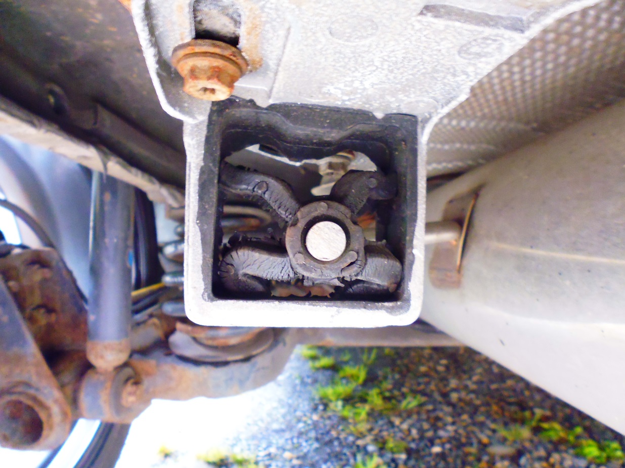

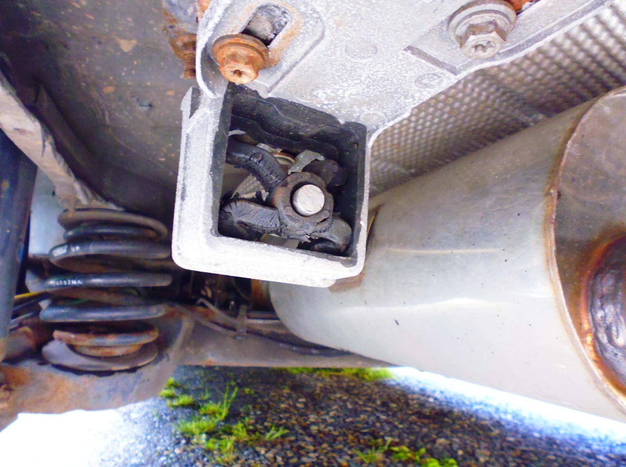

Right, so mine are shot and I'm needing new ones.
Just wondering what the best way forward is. I assume this is the correct OEM replacement part 'http://www.ebay.co.uk/itm/RENAULT-C...851?pt=LH_DefaultDomain_3&hash=item3f4882f9e3', but I have also heard of people using the Powerflex EXH008 'http://www.ebay.co.uk/itm/PAIR-UNIV...MEROUS-CARS-/231490021265?hash=item35e5e16791'. What's my best choice? I'm assuming the OEM replacement, but then iirc the Powerflex rubber is stronger?

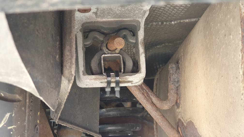

I got tired of replacing this little dude. Steel has stopped the knocking over speed bumps with the slight side effect of making the exhaust roughly TWICE AS LOUD! :D

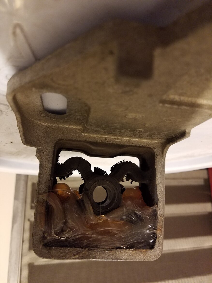

There is, I filled the lower gaps of mine with RTV. There is no extra vibration and it's been on there for 7 years so far and still good.
