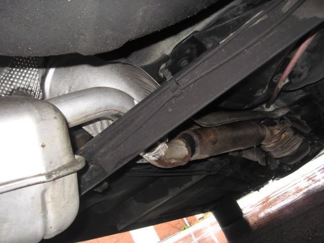

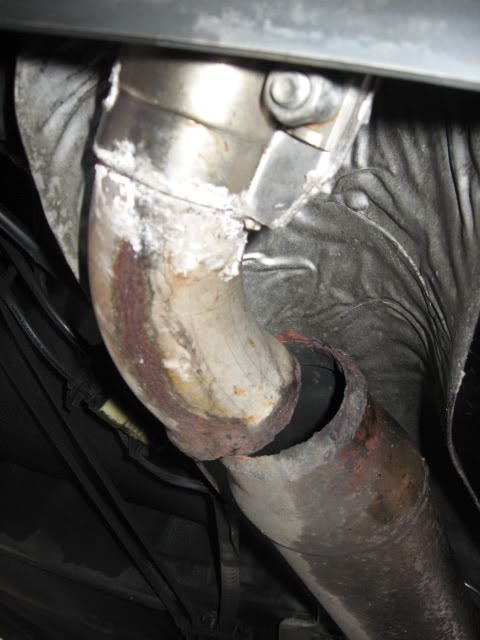

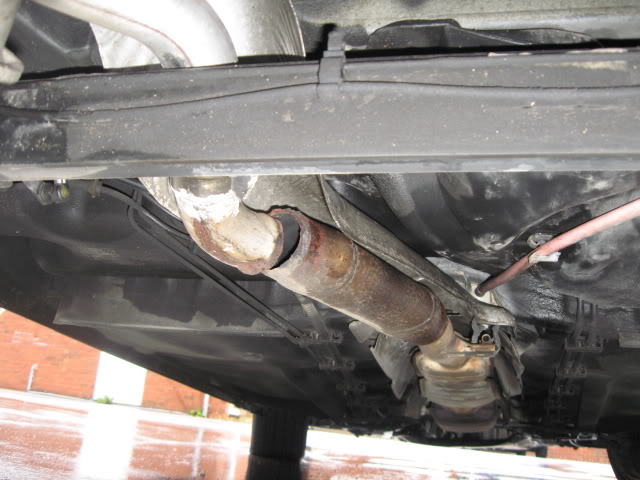

The other day my car started to sound like an impreza whilst going down the A1. ive had a look and my back box isnt attached anymore but it looks to me like its the centre section that has split (but i know nothing:S)..
I took some pics, can you guys advise as to which part will need replacing.

Ive had one thats broke there, you need a new centre section, they are £180 from Renault. I have a brand new one for sale thats never been fitted if your interested??
They are easy to fit, unbolt from the cat, unbolt the clamp and refit. Your back box looks like its been replaced already??
