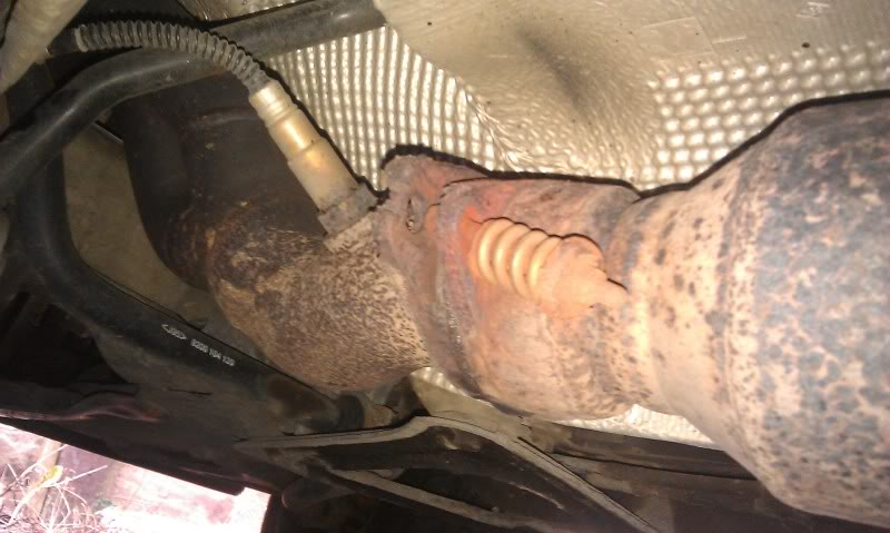

Driving around yesterday my car developed a loud noise. Got it home and checked it out under neath and this is what ive found.
Now it looks like the bolt has just come loose and thats why the manifold had split from the CAT. It does look awfully rusty though. Does anyone think i could just bolt it back together or do i have to start replacing parts? Manifolds are expensive!!
Rob
Does the bolt with the spring on it look intact. Could just be a new fitting kit needed. If so, get one from Renault...not a motor factors.
The cat manifold join is fairly prone to going, that's what mine looked like when it went. Renault only, others tend to leak apparently.
