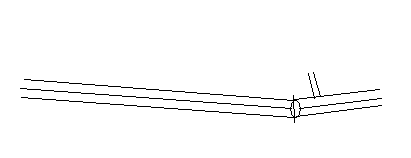

My exhaust is sagging @ the Cat-Exhaust olive join.
here is a picture i made just now trying to show the issue:
Now its NOT that bad as i have drawn, But its deffo sagging at that joint, and its had 3 new gaskets in past 3 months. Used sealant too and each time it starts blowing again.
The Center mount is new, and the rear mount is fine as i have reinforced it with zipties lol
I will take a photo of the exhaust later today to show exactly the issue, but i would like to sort this as i cant keep fitting new gaskets every month lol.
