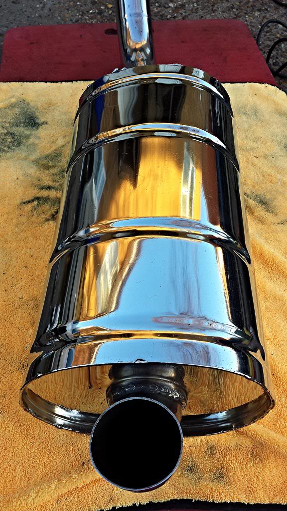

Has anything new came onto the market in terms of sealing a exhaust once its been polished?
I want to protect the exhaust on my motorbike so were not talking just a tip but a whole backbox if you like. Anything that can withstand the hi temps?

I've never had any problems with mine tbh, is it garaged? Titanium is a pain, even finger prints mark it.
Standard stainless steel exhaust its mainly watermarks which make it looks a bit shot having to give it a polish every 2 or so rides. It's was protected though would just a easy wipe down is my thinking.

Buy a ceramic one or don't bother. C5 is very good.

I would polish lightly, double ipa wipe down then apply. Bit much? Maybe but it'll look like new in 2 years!

Discovered by Scrooge, AF metal polish with fine grade wet and dry works wonders on ST/ST end cans, cut as well as wire wool but with far better finishing down, almost comparable to metal polish with a MF.
once cleaned up, I wiped down the end can and link pipe with eraser / IPA and coated with GTechniq C1/C4/C5 which ever I had, and topped with reload once cured to help with water spotting. Has been fine ever since, shiny scorpion oval now doesn't say 'not for road use' anymore

C5 will hold up to heat, I would have thought. But if you doubt that, how about a heat specific sealant?
