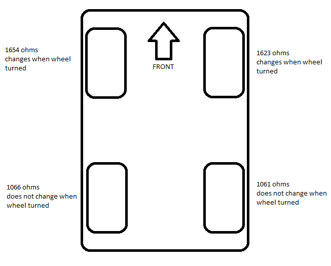

Ok....well......what about this.
There is something obviously wrong that the car reports before it has even moved.....so is there a way of checking the abs sensors?
I know they throw a signal when the wheel is rotated but I only have a turd multimeter.
So given the problem throws when the car is immediately turned on, would I be right in saying I would be checking for a break in one of the abs sensors if they are a closed circuit?
J

Sorry, search....I know......found this
So I am looking for a resistance of 1130 Ohms on each sensor static......and continuity.....obviously?

  2003 Clio 172
Hi guys,
Not sure if this helps but i went round all my abs sensors tonight with my albeit crappy multimeter.
Not sure if this shows any issues?
Thoughts?
