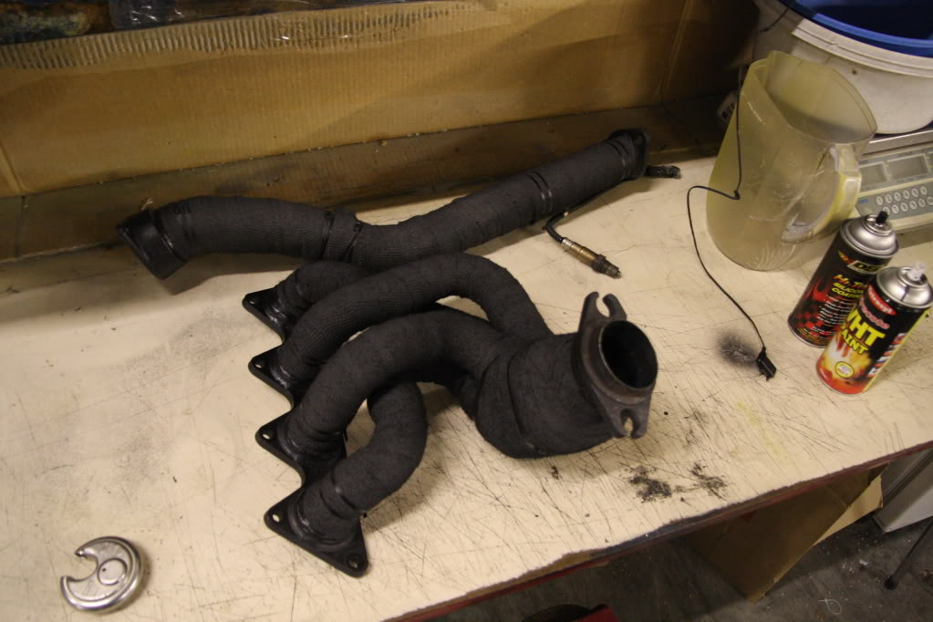

Heres my 4-2-1 manifold wrapped two years ago. It cools down engine bay a lot and in theory it should help engine performance by acceleration exhaust gases. After two years the wrap itself started to break unfortunately.

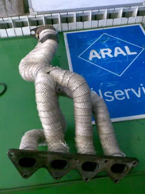

I have it on my 172 manifold and downpipe simply for the fact to keep heat away from the brake lines at the back of the engine bay, as I dont have a heatshield there.
Its been spot on, never had an issue with high engine bay temperatures on trackdays and the brakes have always been spot on...
I painted the manifold and downpipe with VHT paint, then wrapped it, then sealed the wrap with specific sealant...
