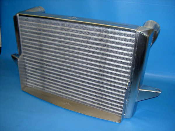

Please quantify larger intercooler being counter productive. Larger turbo, larger intercooler, it wont be a monster intercooler.
  182/RS2/ Turbo/Mk1
Despite the fact that in theory a larger intercooler will mean a delayed response, in practice Ive never found that to be noticeably the case.
This is the size of intercooler I use on my sierra for example without any appreciable difference over the standard small one:

sierra? looks abit more like a escort :S or am i missing something
you are missing the fact I said "this is the size of intercooler I use" rather than "this is a picture of my car" I dont have a picture of mine with the bumper off so googled up something else with the same size intercooler to post instead.

back on subject, thats almost the size cooler my dci runs, havent seen any lag difference bettween the small sized dci cooler to the aftermarket one
