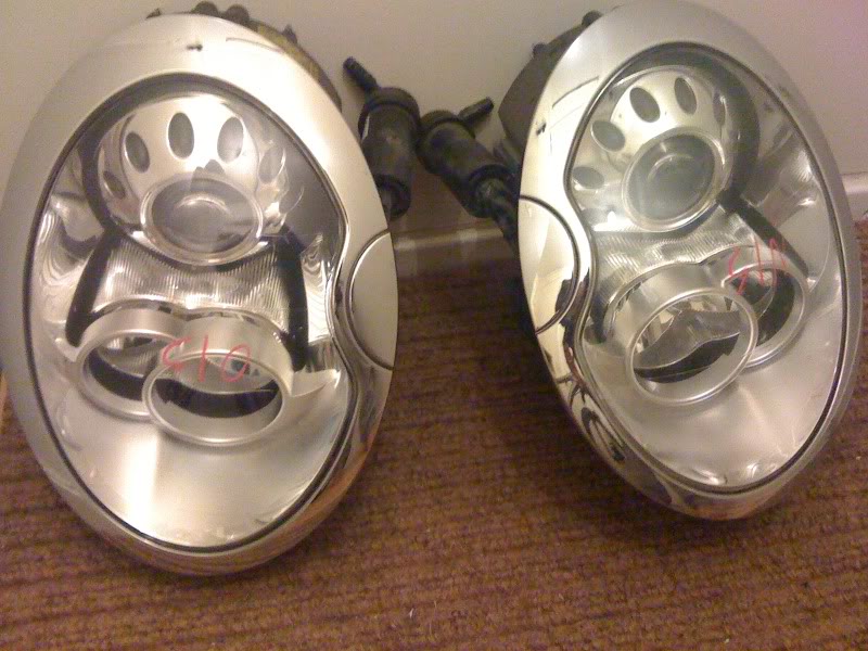

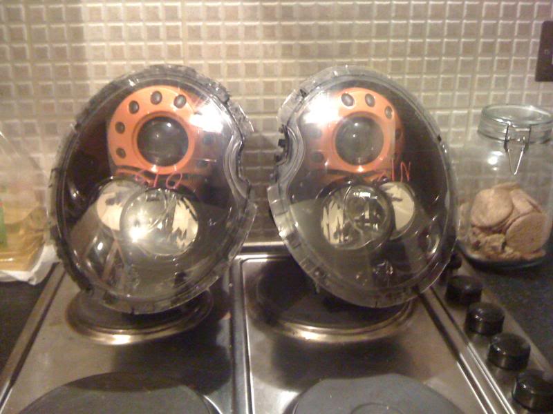

Picked up these babys yesterday for the bargain price of £100. BMW wanted around £400 each.
Have already started taking them apart in preparation for the goodness to come. The outer rings are being colour coded in 668 Black 2 as per the car body colour.

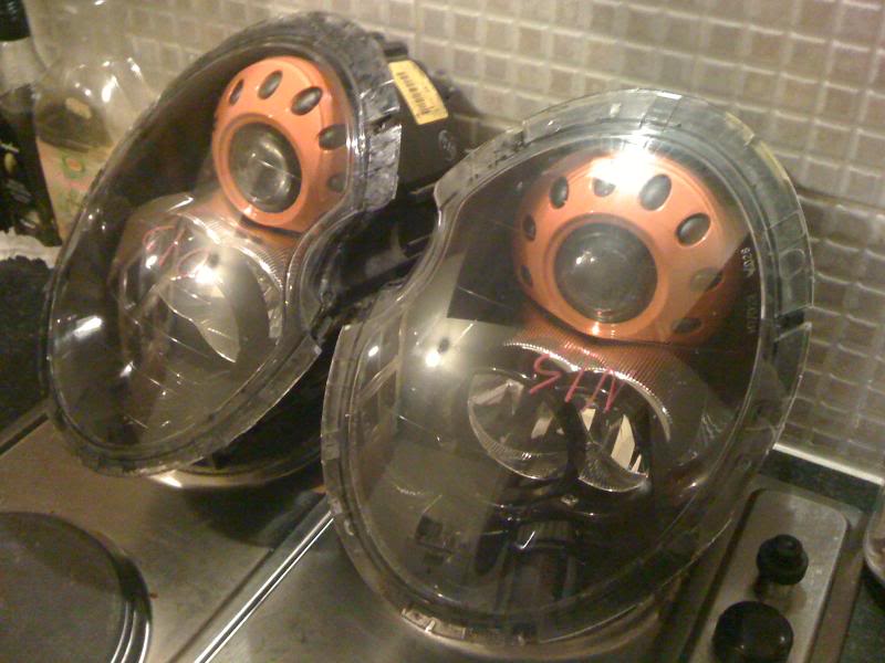

Will be removing the glass to take the interior apart. The facisa will be black again as per the car colour but the surround around the xenon ball will be 8C6 orange as per the mirrors and wheels.

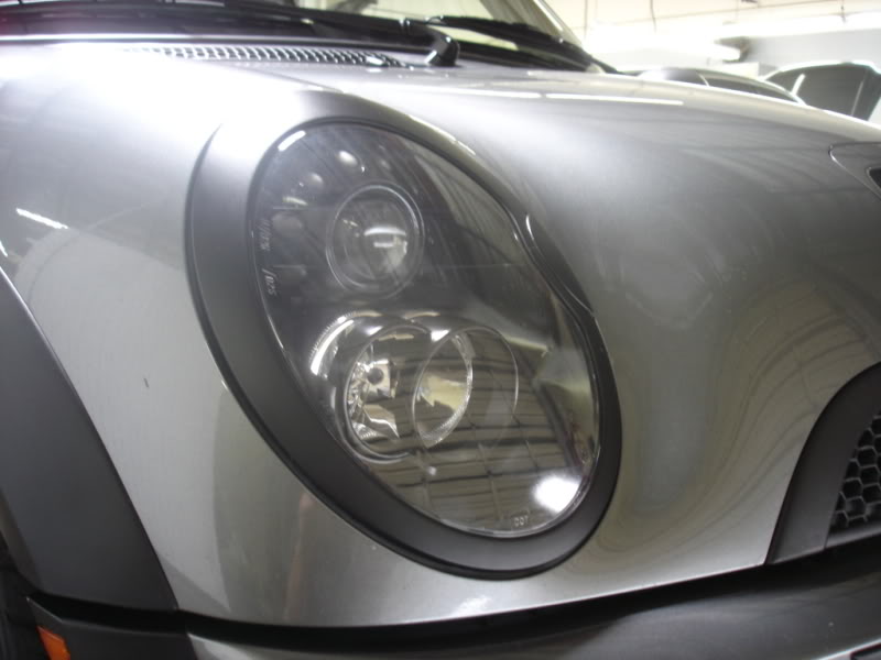

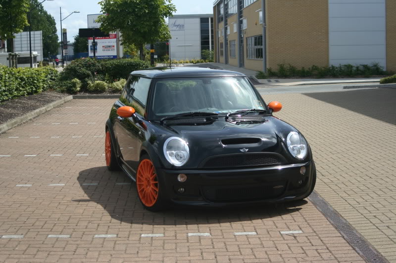

What do you think, here is a frontal shot. Dont think it will be too ott, just the pcing afterwards then the works graphics on the side of the doors and the looks will be done.

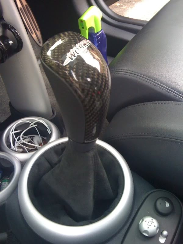

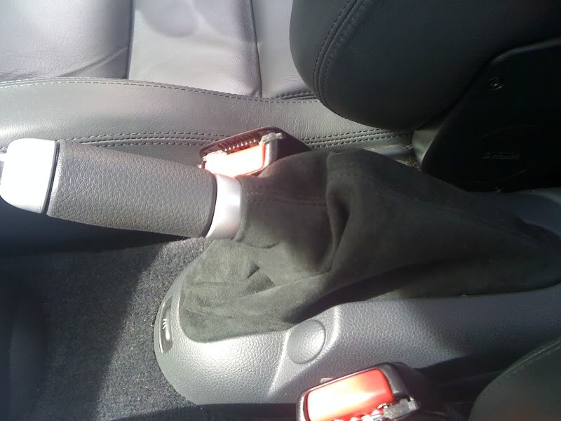

Also picked up some genuine JCW alcantara gear and handbrake boots. Adds a bit more class to the interior.

Hmm, I'm not sure on the orange. It's not my thing, but I do like the rest of the car. Where'd you pick up the lights? Scrappy?
Coby.
Not a fan of the bright colours either BUT the Headlights should make it look a bit more hardcore

Lol... these lights are class, when you use the screen wash for the xenons, the little thing pops out, squirts then retracts!

Looks lovely mate, I'd just paint the headlight inserts black and leave it tbh.

I love your car and the plans.
Not a fan of the wheels though. Colour is awesome, I just think the spokes are a little too sharp for the soft shape of the mini.

Id do entire inside of headlights black, but be interesting to see what the orange is like! Also, if you dont like, easy to change to all black :)

The ideas are good, but the details really let t down for me. The orange onblack is good, but the wheels don't suit the car. The orange in the lights potentially will look a bit Chavez if I'm honest.

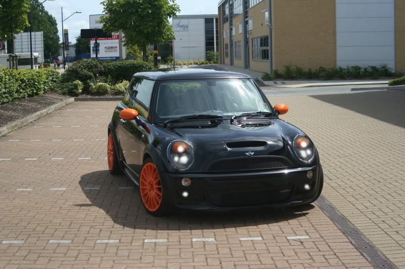

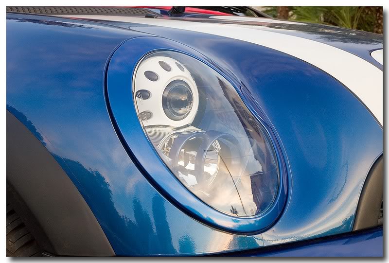

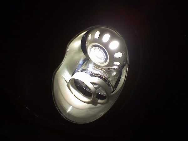

here is a couple of other cars that have had similar mods done. I think it just looks amazing imo. I agree it wont be to everyones taste, but its one of those mods that will really set it apart from the other minis out there. Also its not costing me anything as I will be able to get rid of the old units for £150 which covers the cost of the new ones and the spraying.
The blue spots around the main projector ball will also look awesome contrast against the orange.

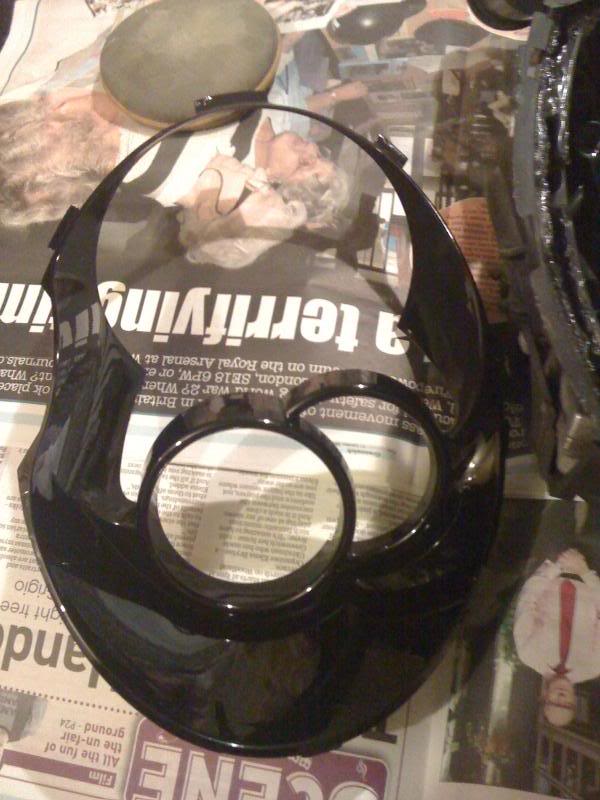

Went to the sprayers today to pick up the headlight and wing vent. Unfortunately the wing vents and the headlight rings had been sprayed in orange by accident and I wanted them black to match the car. Should have them back Monday.

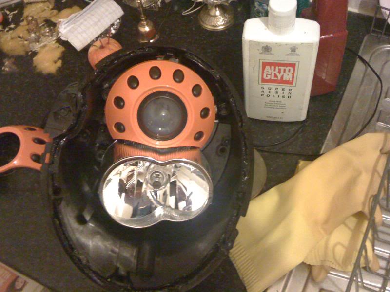

In the meantime I proceeded to reinstall the interior of the light unit and seal it back up again. Bit of a PITA but patience came to the rescue and I managed to close them up nicely.
Wanted to fit them tomorrow but will probably wait till next weekend now. Here is the 75% done shots.
Projector Ball in place
Fasica
Voila!

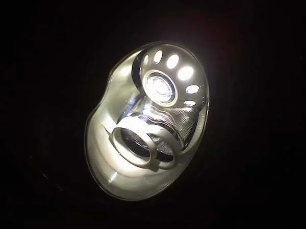

how did you dismantle the headlight unit? clio lights are in need of a clean maybe a spray in black :D
it is a little fiddly, but more intimidating than it looks. Not sure how the clio headlights are pieced together, but iirc they should just have some clips and some goop that can be heated and prised apart. Surprised no one has done this to their clio already.
basically remove the unit from the car and have a look for any retaining clips.
once all the clips are removed safely then heat around the edge of the light unit. Should just be able to prise it apart. Then just take out the interior pieces carefully. With the bulbs removed it should be easier as some of the clips holding in the fasica may be held from behind the projector ball etc.
take the pieces out and take them to the spray shop or do yourself. I took them to my local spray shop as Im a bit cack handed when it comes to all that stuff.
Refit, reheat the glue and then assemble to the car. Just avoid scratching the inside of the light cover / finger prints etc.
Its a simple mod to do that many wont have and not chavvy. Should make the car look more aggressive dependant on colour choice.
