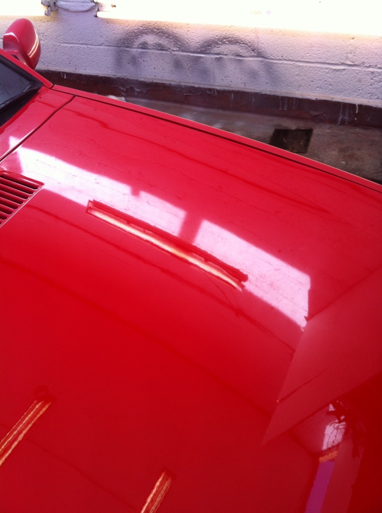

But yesterday I managed to machine it with ag ultra fine renovator, then again with cg 3N, then ag deep gloss shine by hand, then so af spirit wax. I must say, the results are superb. It certainly doesn't look like 24 year old paint!
Crappy pics because its dark and raining. (When my wife gives up the laptop)
I did say it was crap pics...
Done a great job dan, my old red Astra was mega faded so that must of been horrid to look at, amazing results tho mate.
