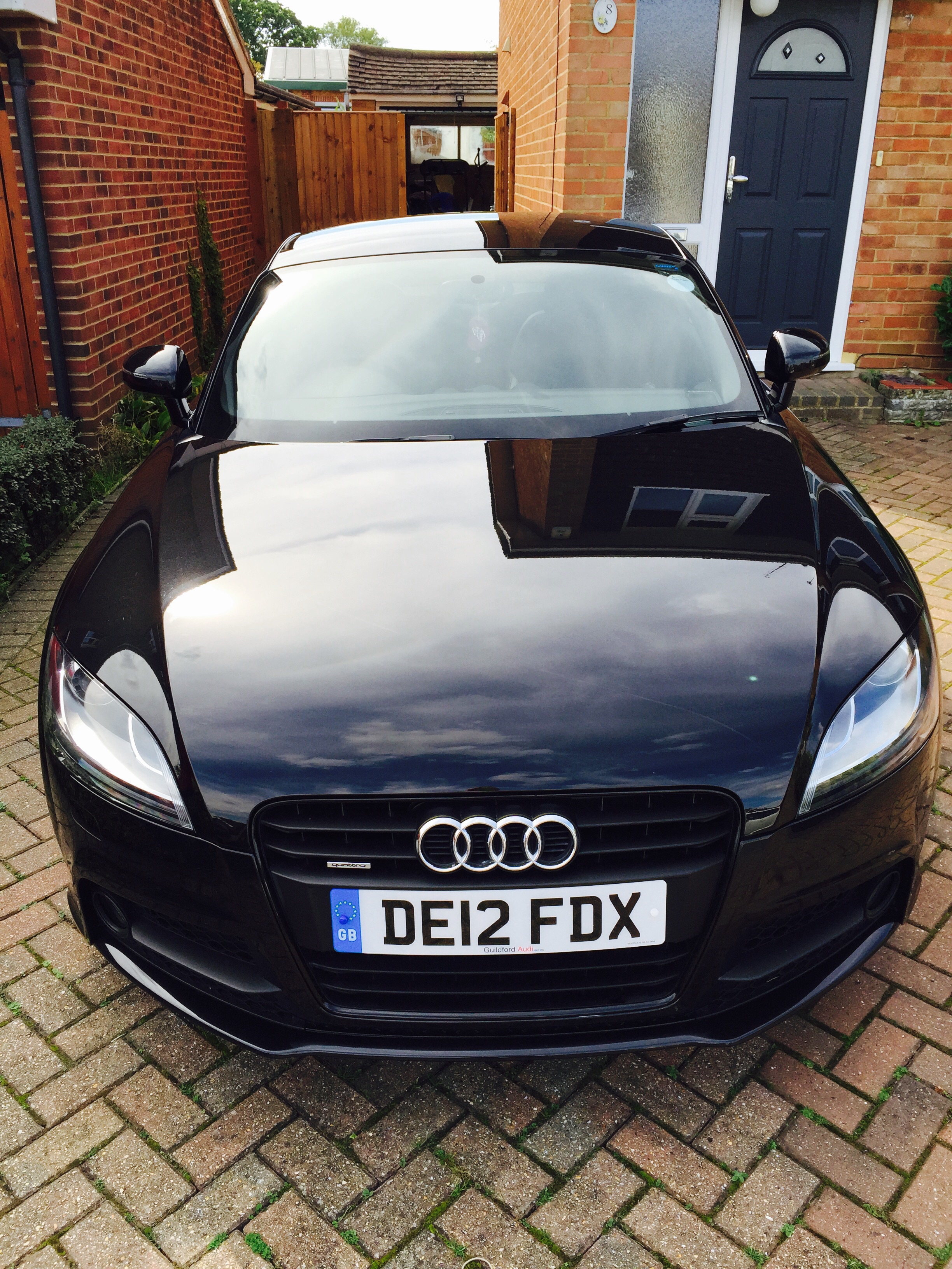

So we've had my wife's TT for 3 weeks now and noticed after she washed it last night some serious marring on the bodywork.
Now the dealership has given it a heavy detail as there were a fair amount of scratches around it prior to purchase, plus they've coated it in GuardX (was done for free).
Its washed with Britemax shampoo with a brand new Gyeon mitt, and dried with i4D uber drying towels.
My thoughts are the dealership didn't do something right prior to applying the GuardX stuff, but I could be wrong. I've just applied some Autoglym Ultra deep shine polish to the bonnet which seems to have got rid of 80 - 90%, but there's still some marring there.
Just wanted to get people's thoughts on the cause before I go back to the dealership. (this is prior to applying the AG polish).

Yup, looks like they didn't finish off properly. Possibly didn't make any passes with a finishing polish and pad, I'd go back and ask them to rectify it :down:

Yea you need that direct light sometimes! Poor workmanship though, their final stage should be to have a slow inspection of the whole car using a very bright LED torch to highlight any defects such as that before applying. Thank god they weren't working with something like Ceramic Pro!

Looks like most dealers 'prep' work... Heavy compound all over then hide all the defects under a greasy heavy wax.

That looks like they've not buffed out their own marring after cutting out the original defect.
It should've been done with the cutting/polishing compound they used and wouldn't have require a finishing polish afterwards if it was done right.
Laymans; they worked the polish enough to remove the original defect, but should have run the machine on a slower speed after to remove those marks in the op

They have used heavy compound to 'buff' the car and get rid of the scratches.
Then they've polished it with whatever crap they use which has hidden the holograms.
You've then washed the car which has washed the polish off and revealed the damage.
AG ultra deep shine on the bonnet is just hiding stuff, it hasn't removed anything.
Your best bet is to go over the whole car with a DA and a quality finishing polish Then get some good sealant on it.

Thanks everyone for responding and confirming what I thought had happened to it. I'm going to contact the dealership still and give them an opportunity to rectify the work. The main reason being my S3 is coming from the same place, so I need to ensure they bend over backwards to make sure thats 100% perfect upon collection.
Worst case, I've got a meguiars G220 so can do it properly.
Would Menzerna SF4000 be ok for that job? (I've recently bought some for the C30 before I sell it).

It depends now badly they've damaged the paint. It will be a case of trial and error really mate.
