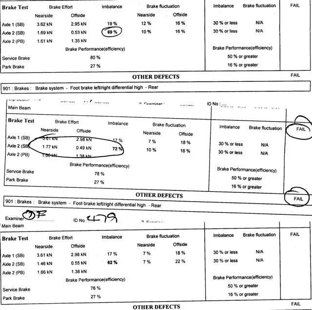

I booked my 172 cup in for mot at the start of the month which it failed.
the guy said it was an imbalance with the foot brake on the rear brakes.
so that weekend I looked at them to see what was happening.
The disks looked as if they where on there way out to went to renault and got nice new disks and pads.I also replaced the brake fluid and tryed to free up the caliper piston and it seemed to wind in and out freely so i rebooked my car for a few days later
Failed again for the same thing:mad:
so I thought the drivers rear caliper must be f**ked
replaced and reblead brakes and rebooked
Failed again for the same thing:mad::mad:

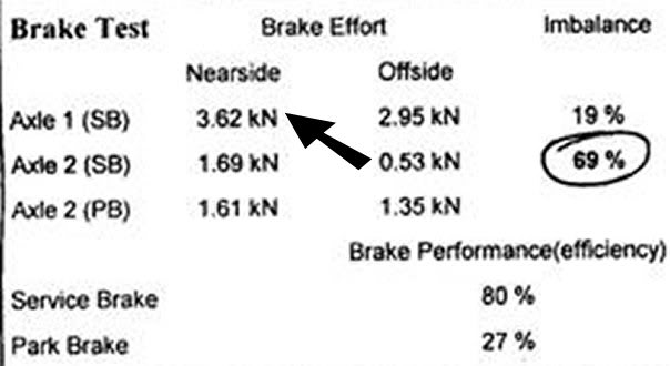

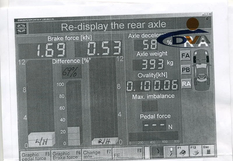

rear brakes - perhaps its not the low effort one thats at fault - its a cup so should have "low" effort on both sides - perhaps the issue is the side with the high reading ?
never thought of it like that
has anyone any results for the braking effort on the rear so I could compare?
I don't know where to go from here.

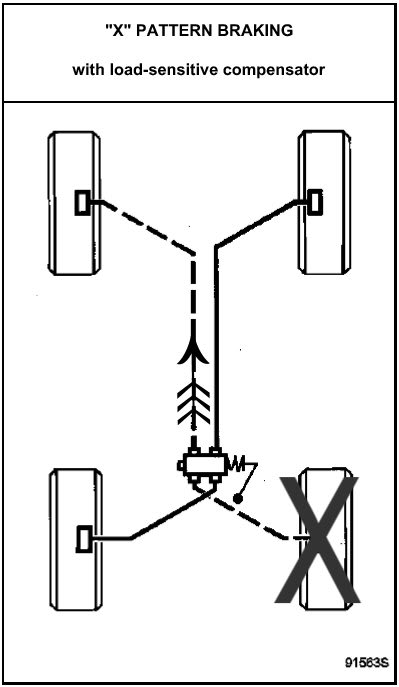

I have removed the brake compansater under the rear axle to have a look.
and it is completely F***ed:D
inside I found two valves (one for the L/H rear & R/H rear wheel)

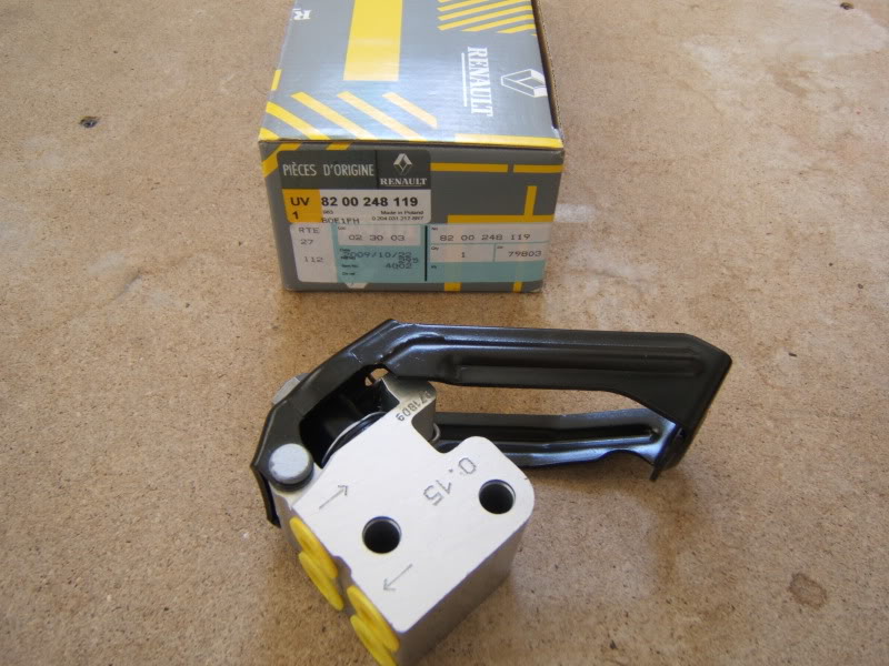

the one controling the R/H rear was seized and caked in rust and dirt so got on the phone to renault and ordered a nice new ..
It looked like the sized valve had been redirecting the pressure from the R/H rear to the L/H front
I still have book the car in for an other retest to confirm all this but looking at the state the valve was in I think we may have got it sorted
