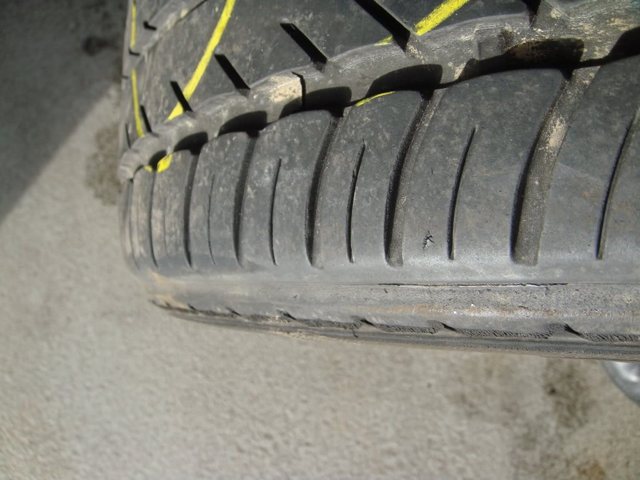

My car has failed it mot on the front two tyres. My coilovers have been carving into them (prob 5mm each tyre)
This is google image but it's basically done this
On the top edge of the tyre
This has only happened in the past two weeks after getting them camber adjusted.
They gave me an advisory also saying my ARB isn't doing its job because it's is low.
How do people get around this problem. My car isn't that low

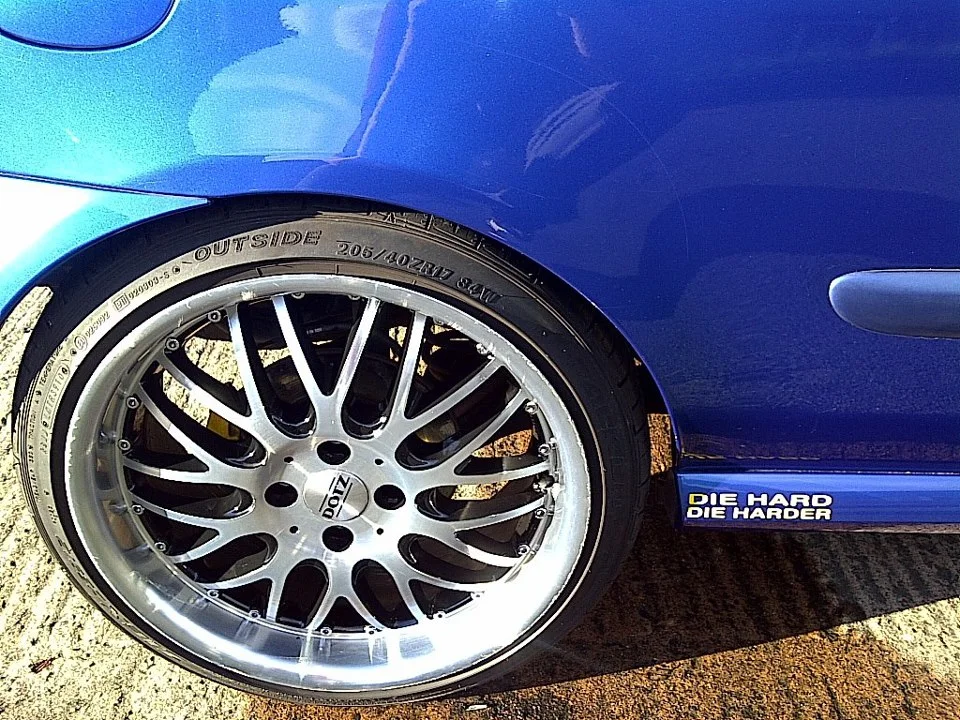

Also if I go the stretch tyre way will that pass an mot?
  172 CUP
yeah stretched tyres will def pass mot, not illegal just most legit Tyre places don't like doing it usually. Not worth it tho mate IMO cos you can get a blow out a lot easier than with standard set up
