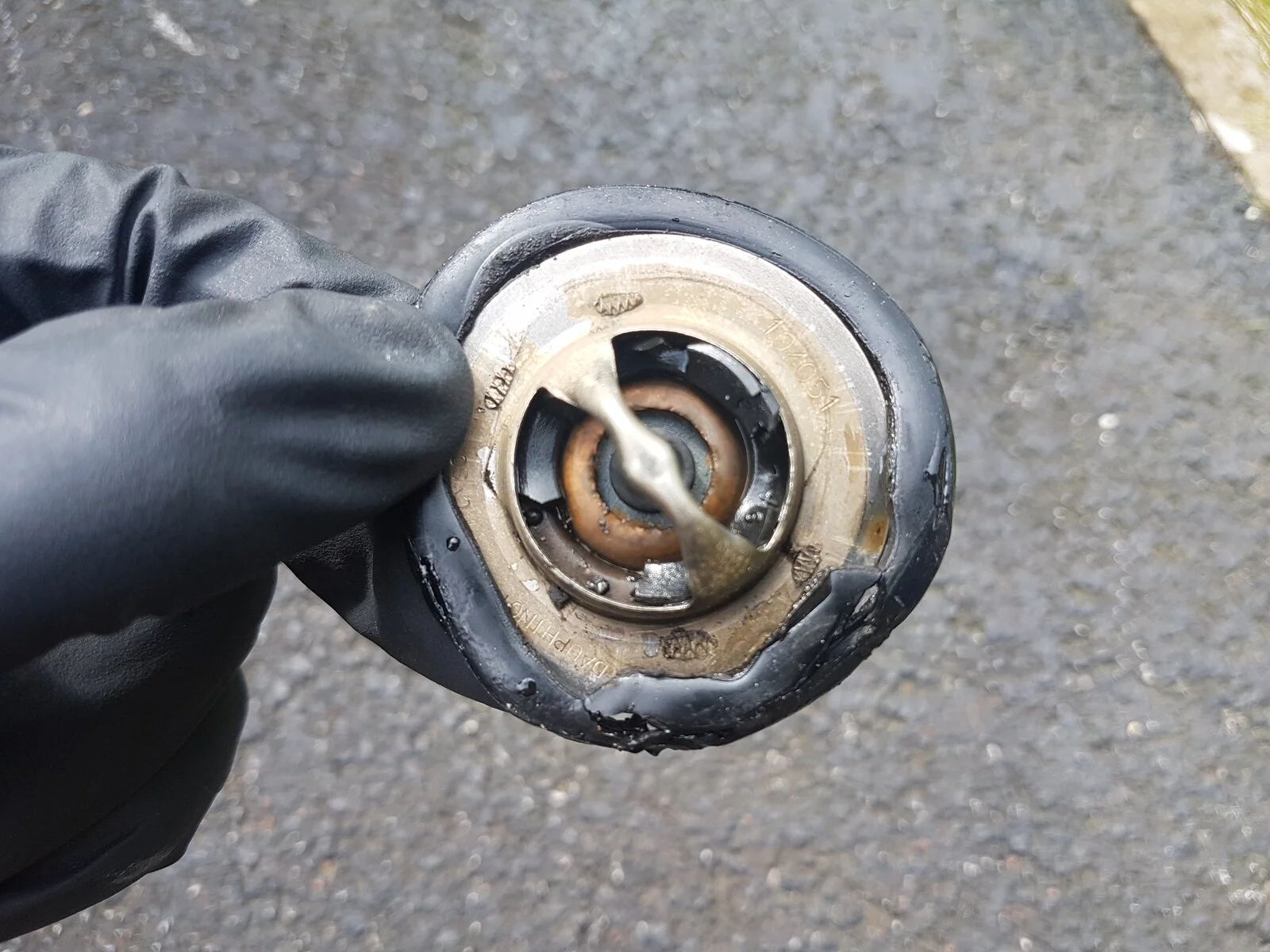

Mine fluctuated every now and then on the motorway, nothing major but would get (sort of) up to temperature within a reasonable amount of time and still looked like this:
If you've got basic tools I'd say for the money of a thermostat and some coolant get it changed if it hasn't been changed recently.
