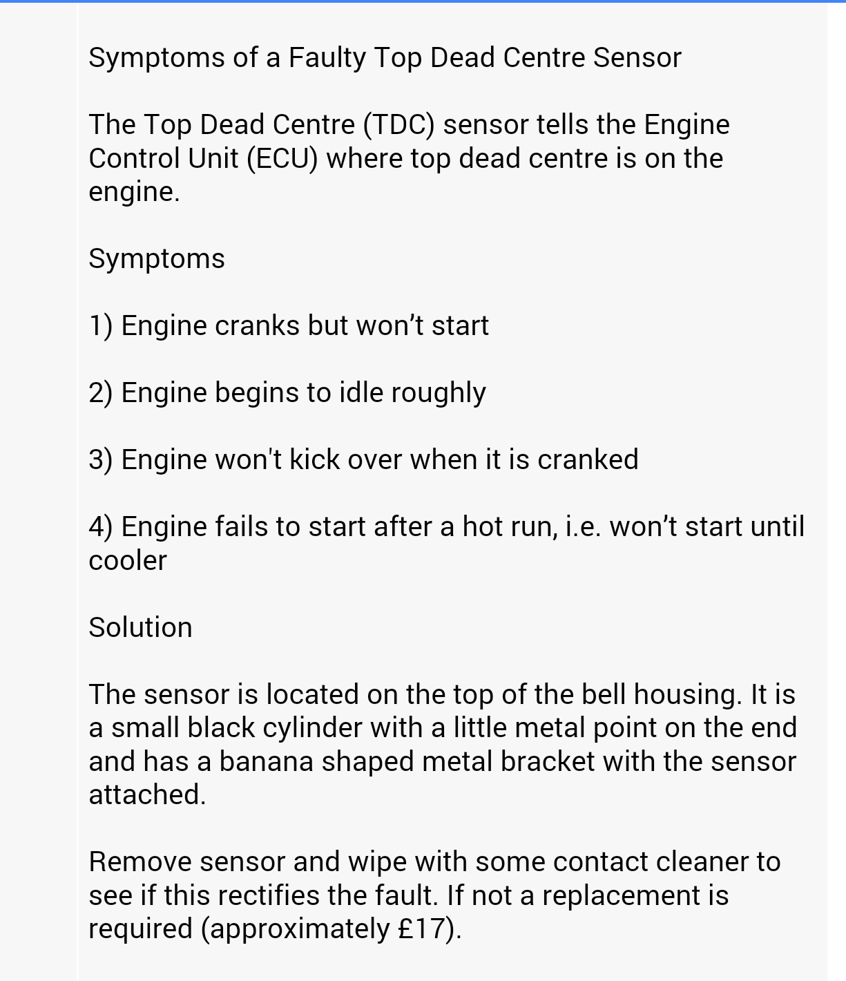

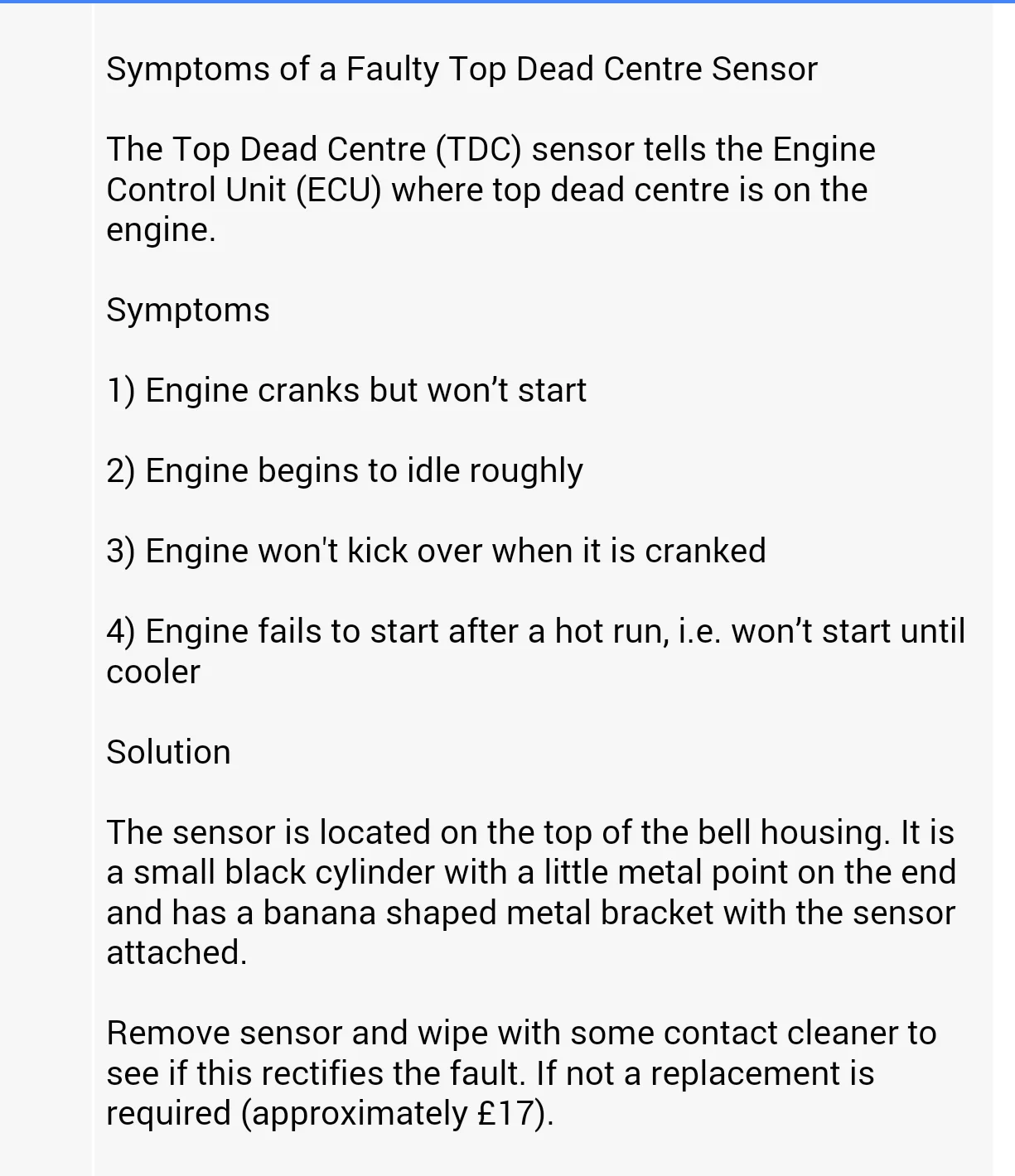

When it fails no. But just removed and cleaned the tdc sensor and on first attempt at a hot start it worked. Let's see if it continues.

tdc sensor won't stop it turning over.
Ah, that's interesting then, cleaning it did reduce the issue through the afternoon, but it did still fail the odd time. I got the idea from http://www.pistonheads.com/gassing/topic.asp?t=946684
