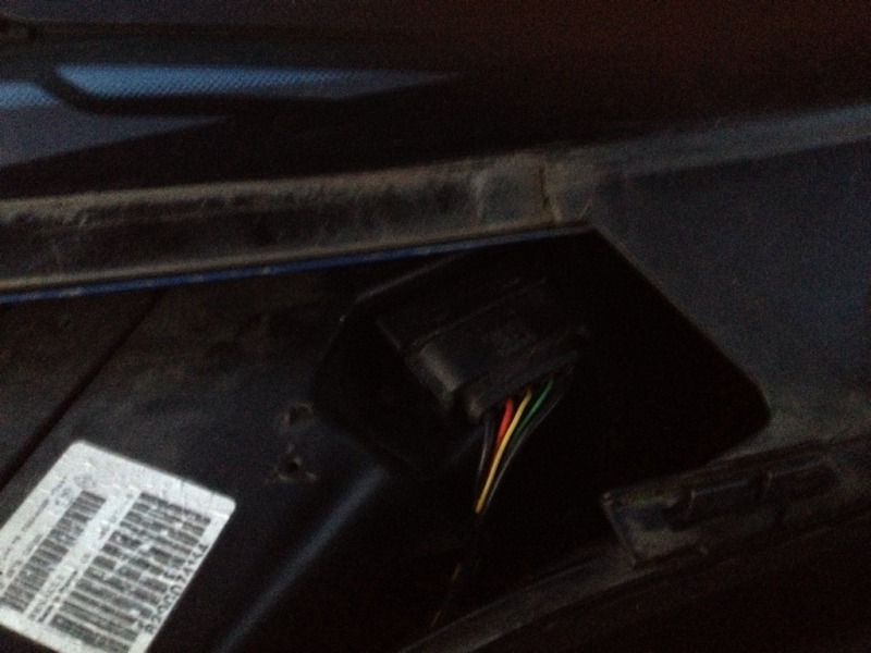

IIRC, it's held on to the black plastic thing by one 6mm bolt, and the wiring goes down underneath the blower unit. Use your left hand, and face the front of the car and the clip will come off easily..
Thanks but isnt it attached by attached by 2 6mm bolts ? but where do the wires lead to ? Do they unclip somewhere or should i just cut them ?
They unclip on the PWM pack don't cut them!!!
You can see it to the top right of this picture.

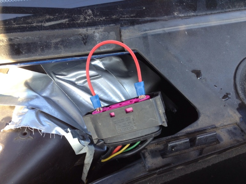

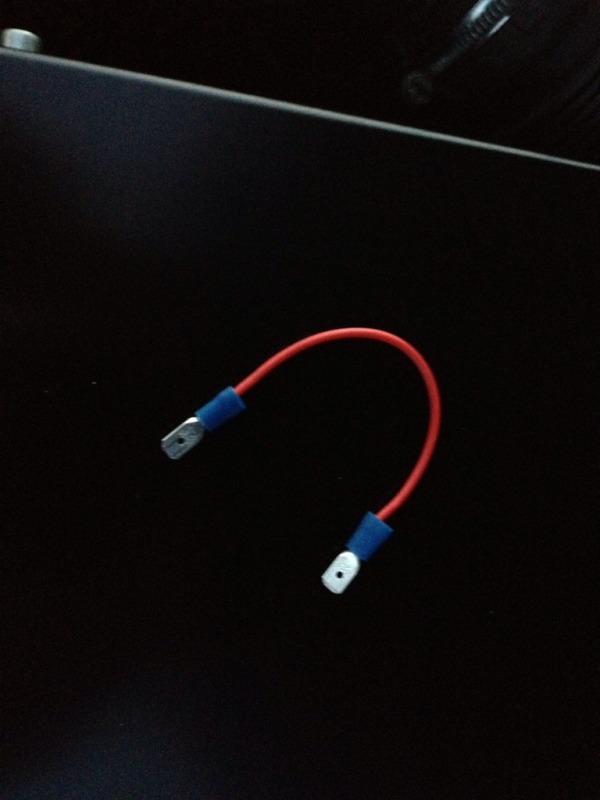

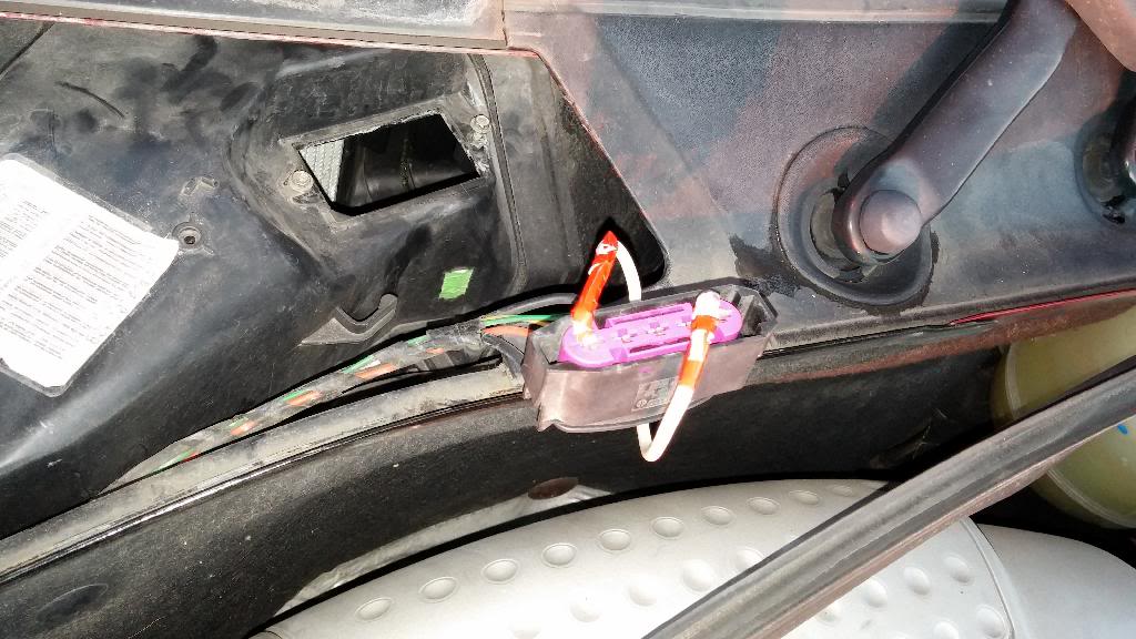

Yes you can. I bridged the plug to leave the heaters on while it was being fixed (it was during winter). Don't bridge it if you don't want the heater on though.
Unplugged it for now, these the same in all Clios? Will see if the scrappy has any if so.
