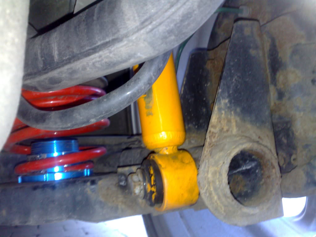

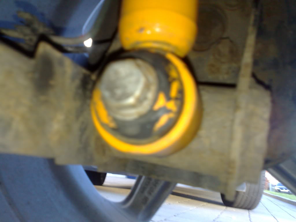

Today I was driving along a coastal road, quite bumpy and alot of sharp bends etc. During the drive i started feeling my car bumping at the back at the drivers side and then the passengers side. When I got out to check what was wrong I found that both of my rear shocks had come away from the bushes and disconnected themselves from the rear beam!
Please check your rear shocks and make sure this is not starting to happen to you. I have covered 1500 miles since the coilovers were fitted and it has only happened now. I will be contacting V-Maxx about this issue as it is very dangerous.

I managed to bodge them back on using a handle of a hydraulic jack and dash shine as lubricant. Car is going nowhere till they get fixed properly though, will take some pics later.

A couple of crappy phone pics

When I do get my new shocks I will be making large spacers or a plate to stop it from hapening again, just for my own piece of mind.

tbh mate, if you put a big washer before you put the bolt on i cant see a problem, as the bush cant go the other way as its against the box section!

solution is to get some big washers beteen the shock and the bolt. easy solution as the bush has no where to go. iv heard of fk's with similar problems tbh. a memeber on here actually had the rear shock go up through into the boot. just because one member ha this problem it doesnt mean everyone who bought v maxx coilovers will but im getting washers put in just for peace of mind

I got a reply today from V-Maxx who have said that there was a small amount of kits that had this problem but it is my no means something that is a widespread problem. Also the same shocks were used for the fixed height suspension set up for several years without any issues. They are speaking to the manufacturers and have promised me a new set of redesigned shocks so that it won't happen again so I am happy enough with that. I am also glad to see a company that looks in to improving products when issues are raised, not just giving out more parts with the same problem.
