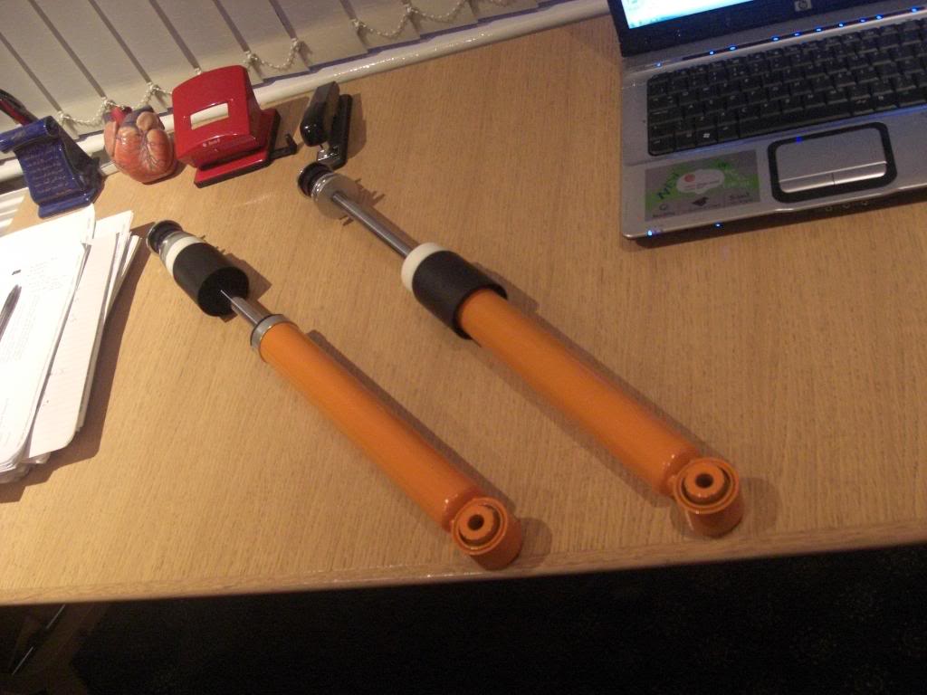

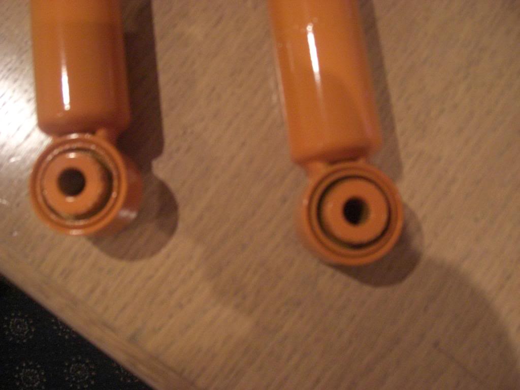

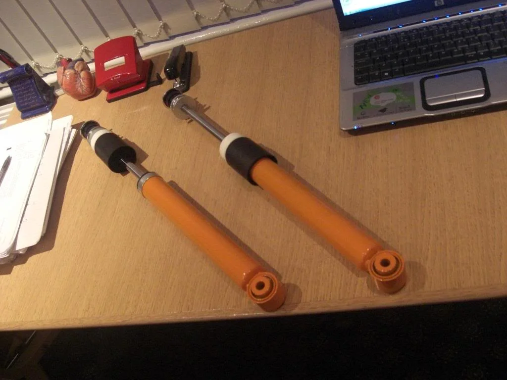

Got mine today, they do look different.

pics as promised of new desighn shocks
