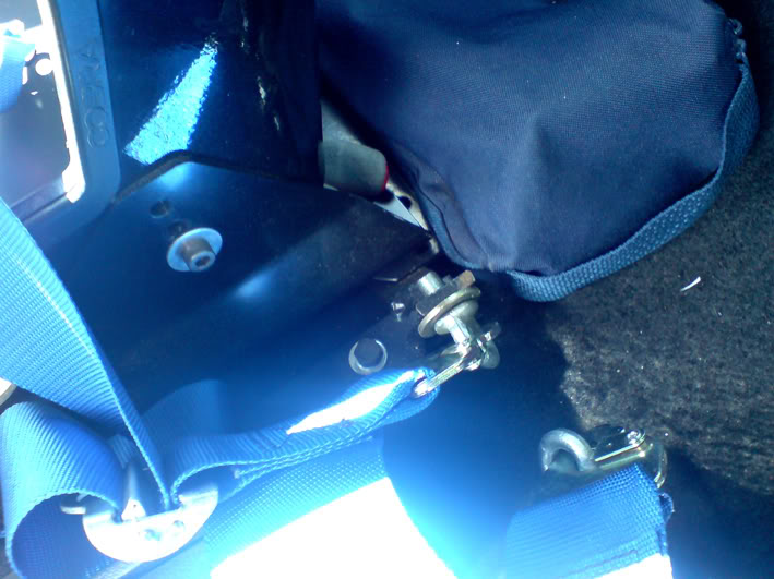

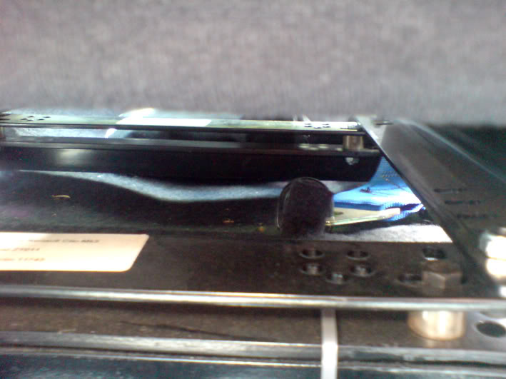

what steve said mate, or you get fixing points to the seat subframes like mine, the other one is to the hook that's under the seat as we didn't drill through the car.

i can see that you have mounted one underneath the seat in the second picture but can't work out where about's that bolt is going through...
initially i couldn't work that first picture out at all, but now i can, i take it thats looking down between the seats? and that is just a bag or something in the rear ? lol

the first pic is from above the handbrake between both seats. the subframes have a mounting point which is handy.
in the second pic, its looking from the footwell under the seat. directly under the seat there is a black hook like found in the boot so just used the harness hook into it. we decided to use that as i didn't have any plates.
is that ok? if you need more pics then give me a shout
i know for a fact there is no hooks under my seats because i have no seats in the car at present and haven't had for a fair old while, i have been in and out of it working and have not once spotted any hooks
why are hooks under the seat anyways......lol????
I'm sure that hook under the seat is not a safe place to mount the harness. AFAIK they must be mounted to a 7/16 or 11mm 8.8 strength (or better) bolt or eyebolt and mounted through a structural and reinforced part of the chassis. I think you can reduce the bolt size to 8m if you increase the tensile strength to 10.9 or 12.9. That one for the cargo net I would expect to just rip out in the event of an accident.

yah the hook is there mate. i know it's probably not the best place for a harness fixing but i had no other way. and tbh that's not the most important fixing (*awaits slating*).
