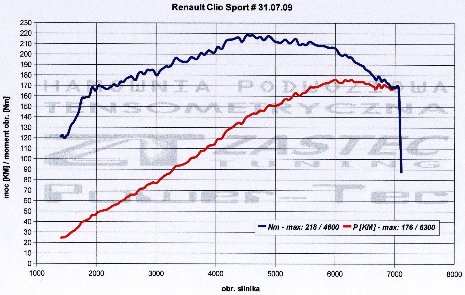

So I did my RR run and to my disappointment top end power was nothing I expected.
After fitting the 182 mani the car pulled like bull from a start, I was hoping for a nice 19x figure after what RS Tuner showed me. In fact the car is much stronger till 5000rpms but top end power i not where it used to be :(
I hope there is still hope for me ;) I'll be contacting Henk just after i get Innovate LC-1 hoked up with my RS Tuner
218 NM of torque. When reading again i would almost say it is'nt possible. This RR has a good reputation ?
the torque is pretty awesome, logically sacrificing top end
I know the car is fast :) But i still wanted a bit more as for BHP figure ;) You think another OEM ECU custom calibration can help a bit ?
Since I fitted the 182 mani and full 2,5"exhaust and made little adjustements to the inlet side the car became bloody fast. Seriuosly it pulls like bull from low down. That printout would explain it. I'm not w BHP who#@ ;) but still I wanted a little more form it

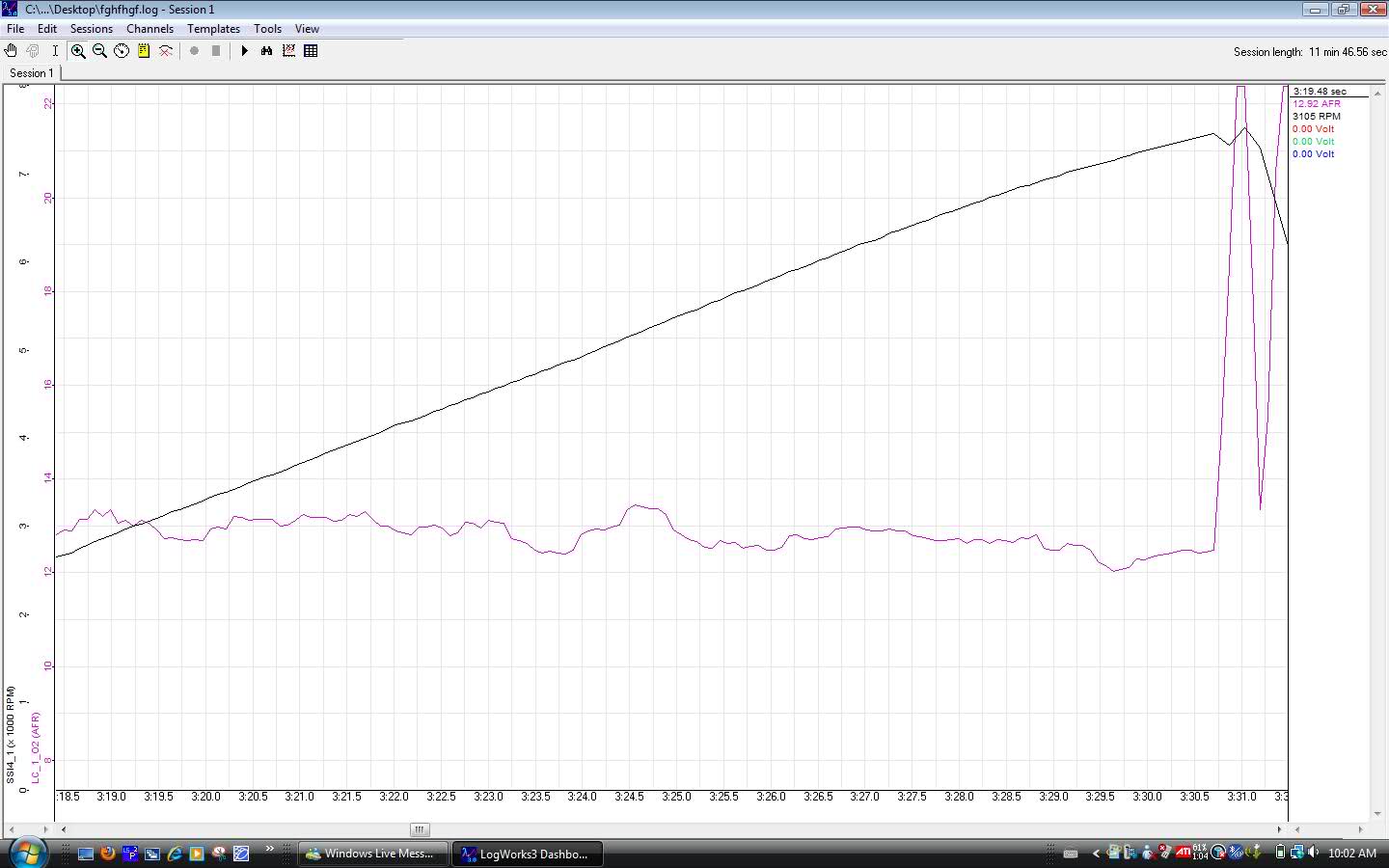

Awesome AFR distribution through the rpm band
Thanks goes to Henk !!! Drive-ability is perfect and you feel the power at all rpm levels including lower band.
