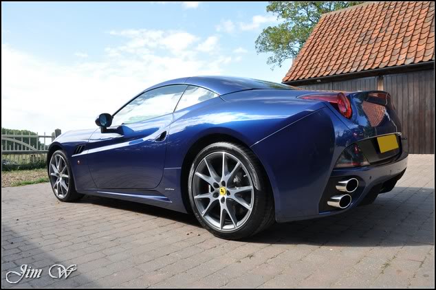

The owner’s daily toy, the Ferrari California, I prepped July last year. At the time, all sorts of dealer inflicted defects were spotted. We weren’t impressed.

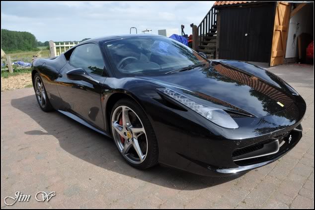

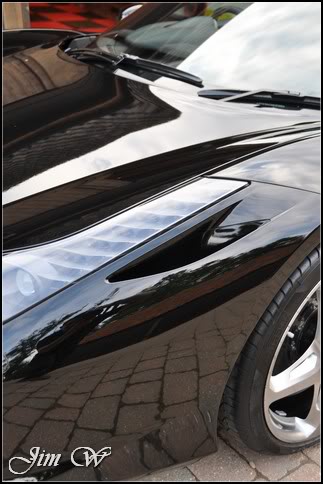

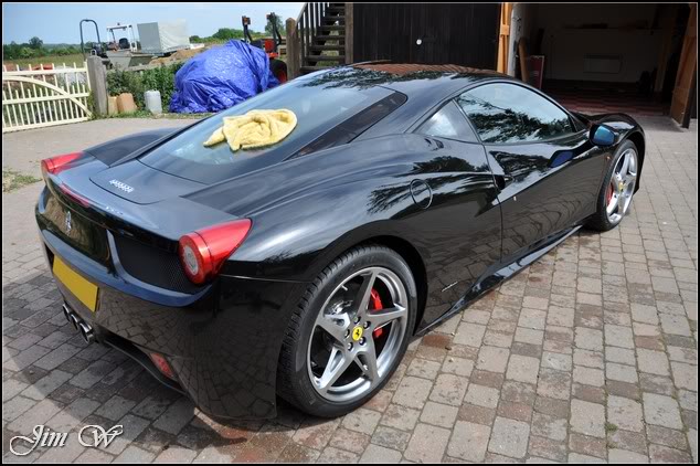

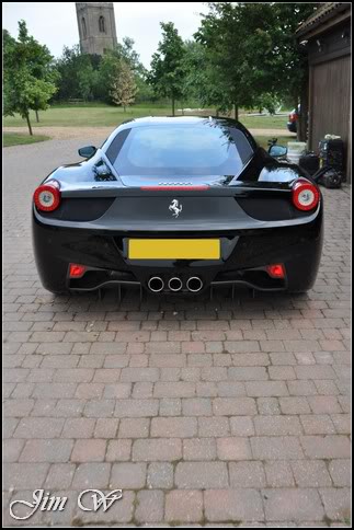

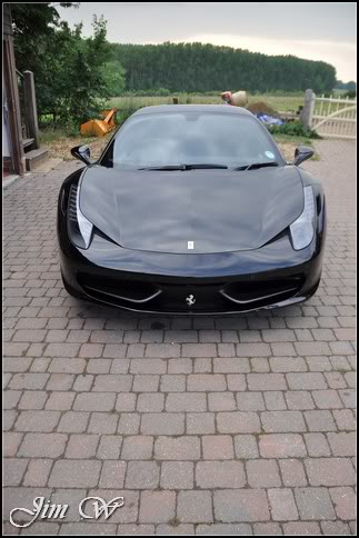

Vehicle on arrival.
What a stunning car.

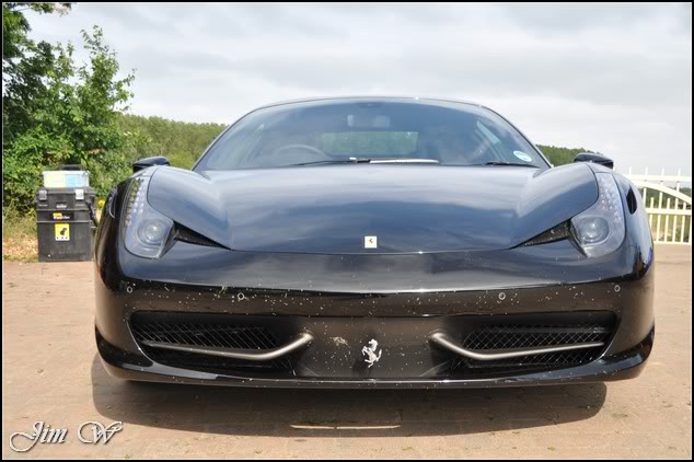

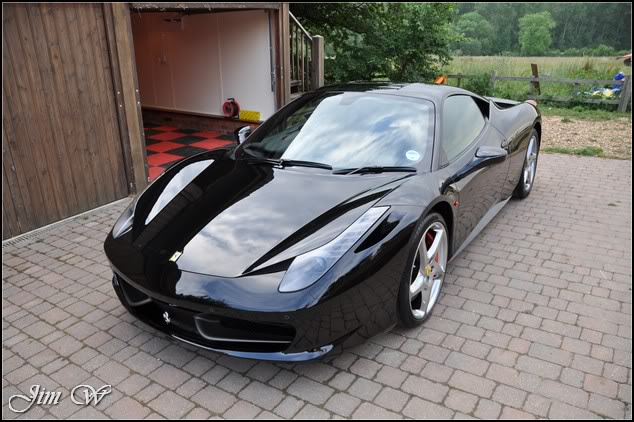

First glimpse of the defects highlighted by the soft-morning sun.

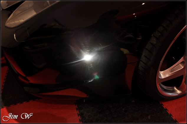

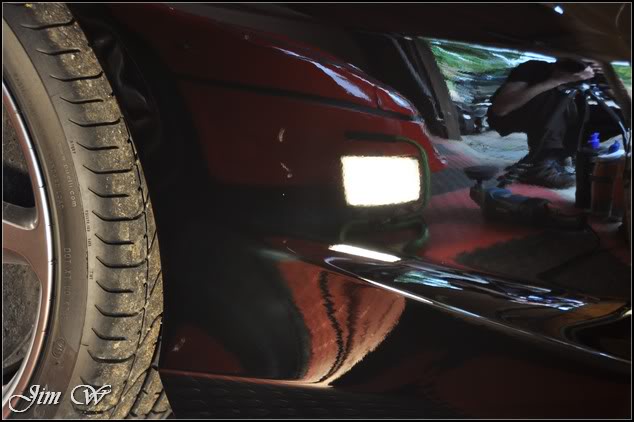

The front end was in a right mess.

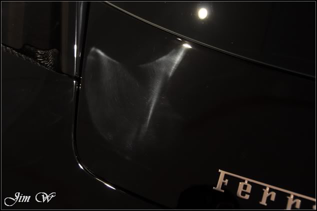

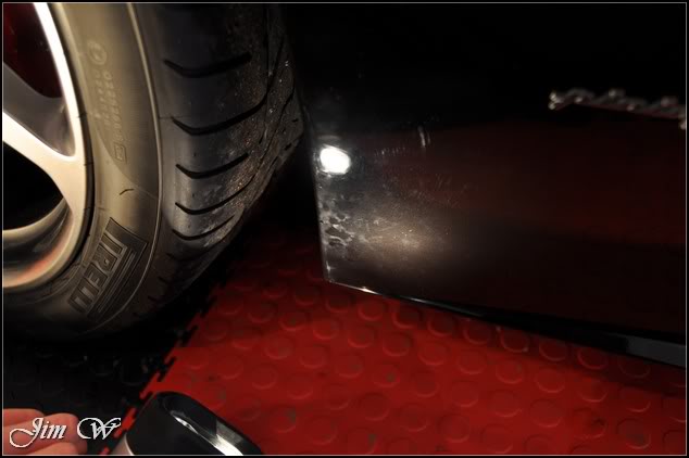

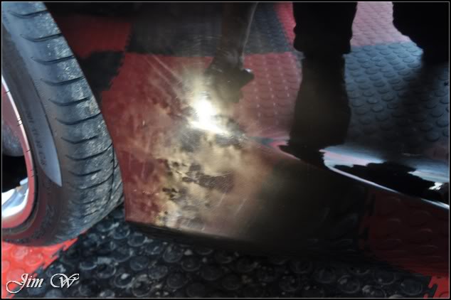

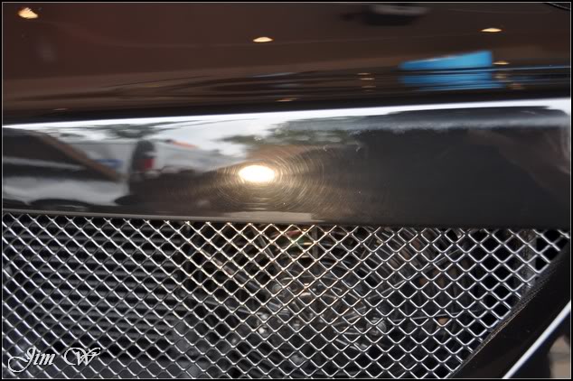

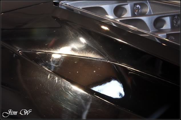

Some weird nasty staining/hazing on the corners:

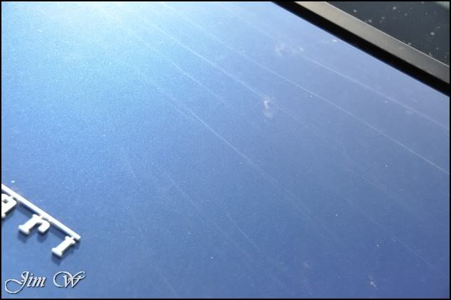

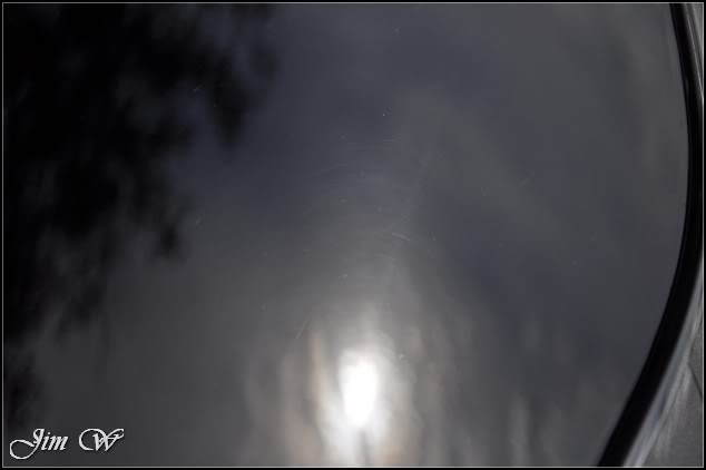

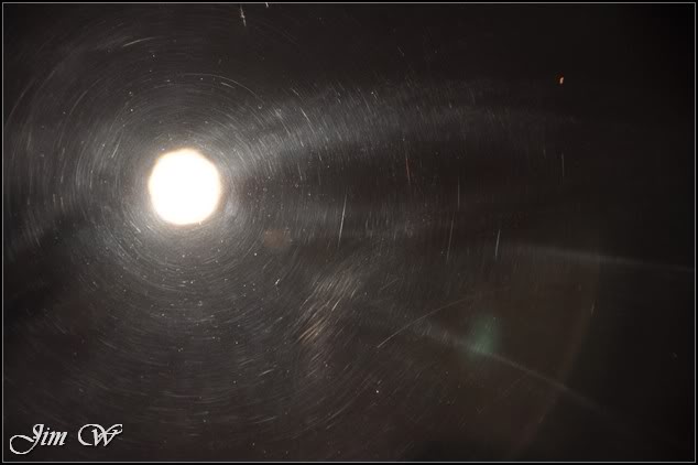

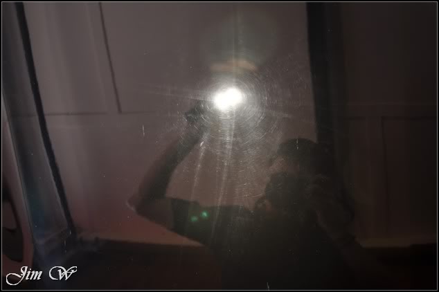

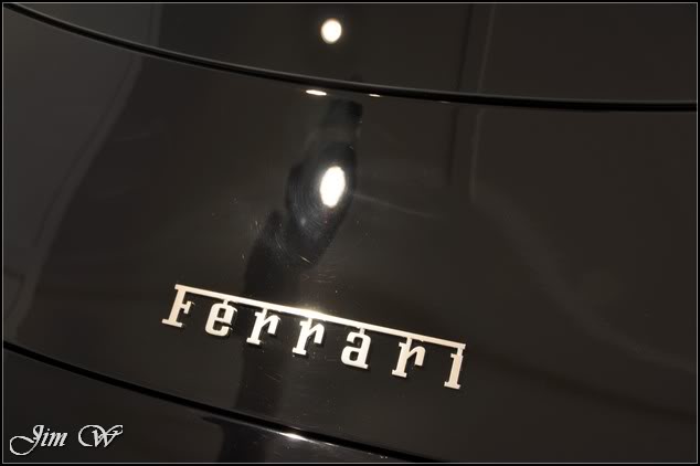

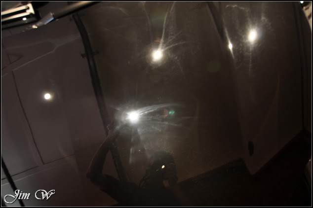

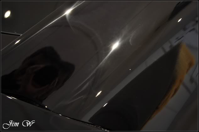

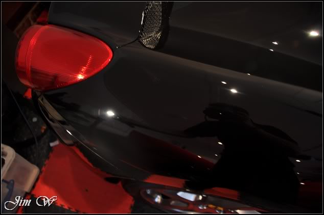

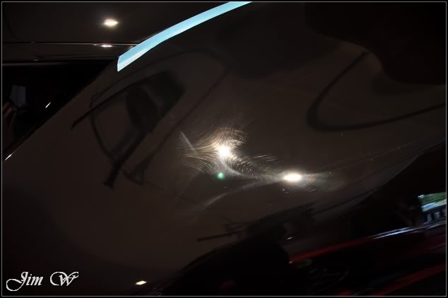

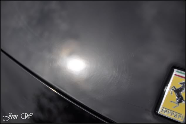

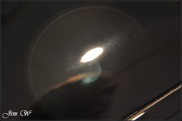

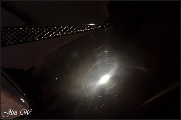

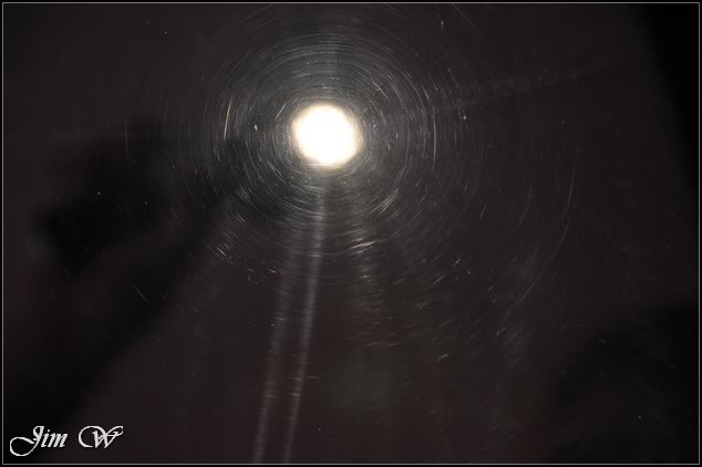

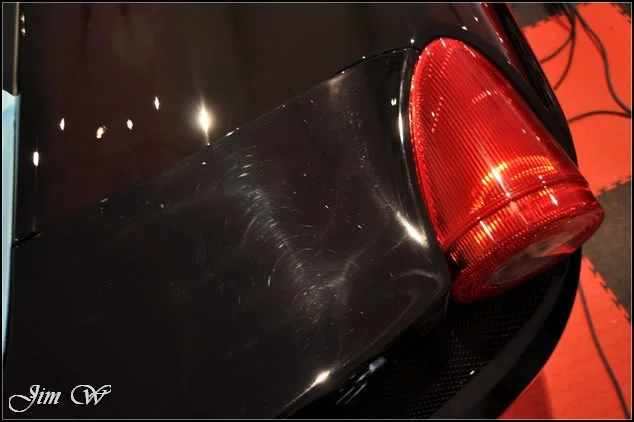

The usual holograms and swirls:

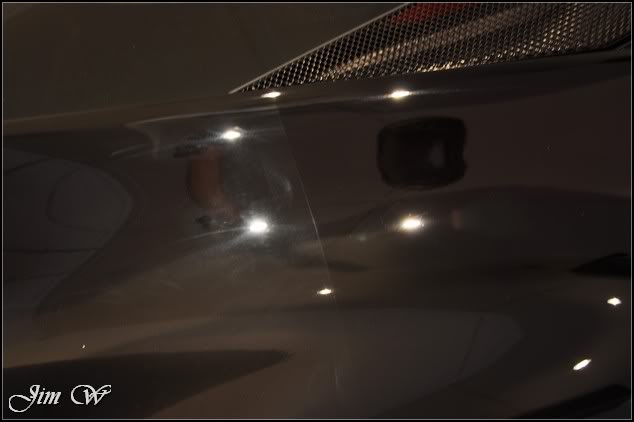

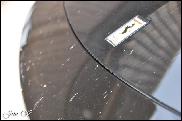

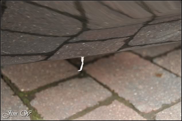

Some protective film that covers the car in the transportation stages had been missed – nice ‘pre delivery inspection’!

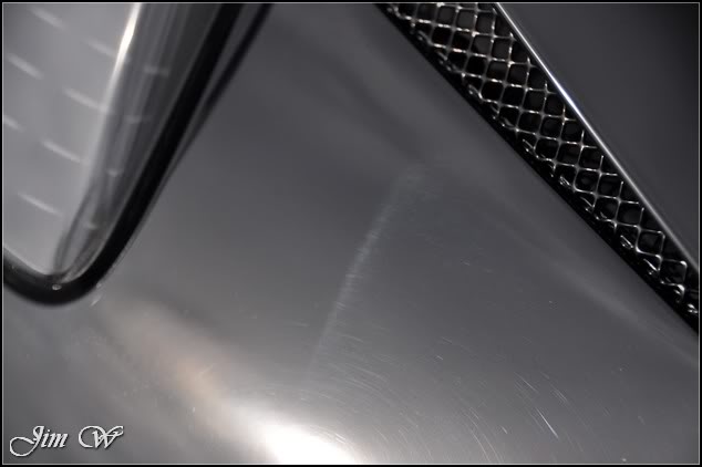

But then some unfinished sanding marks surrounding the air vents (both sides)

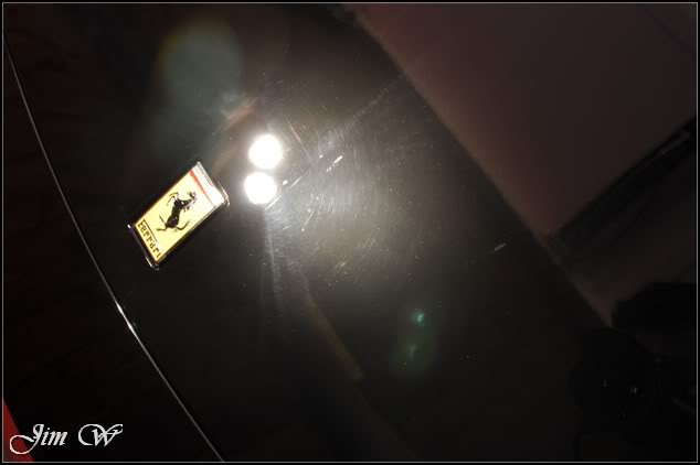

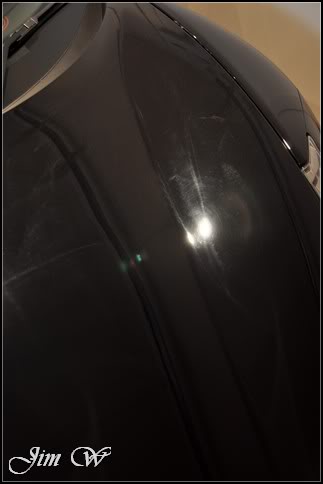

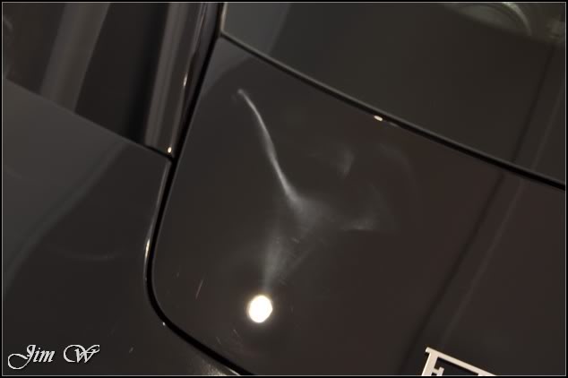

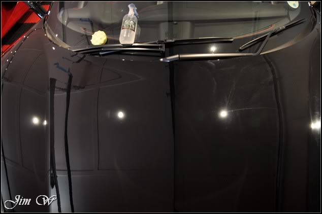

Bonnet defects:

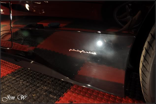

O/S rear quarter:

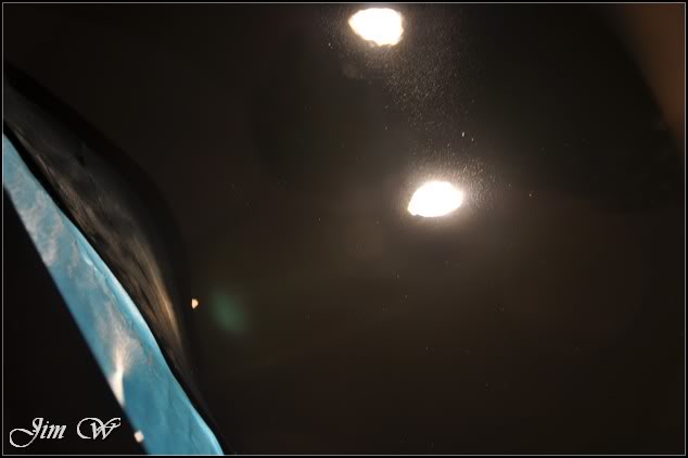

Overspray and a masking mark spotted lower down on same panel:
And then more funny staining/hazing on the edge of an arch.

First impressions when I’d begun my polishing set were, “hell, this paint is butter soft.” Every polishing set had to be exact; making two correctional passes with a mild polish and pad combination followed by a refining stage to leave a flawless, defect free finish. I can start to appreciate now how (and why) the Dealership made such a pig’s ear of it in the first place… The finish was extremely delicate.

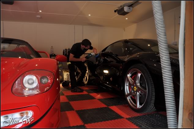

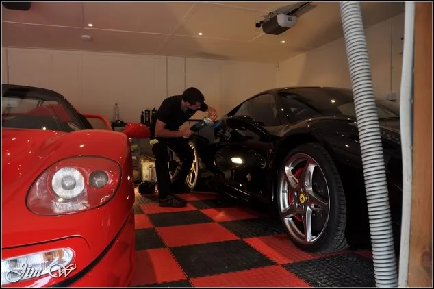

Working conditions here aren’t great. See below:

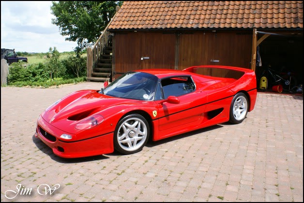

Squeezing down the side of a Ferrari F50. *gulp*
It was a case of do what I can at the front and rear of the car, finish the O/S and then take the car out, spin it round and repeat on the N/S.

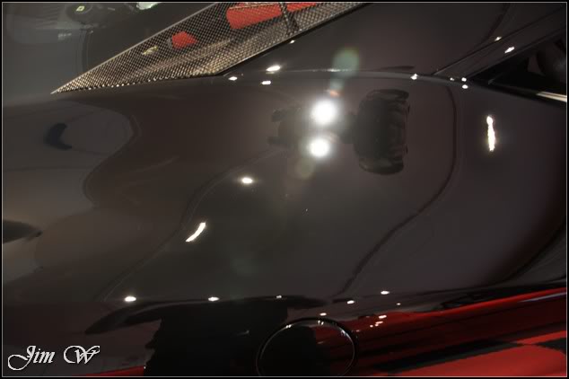

Once machined properly, things started to shape up:
50/50’s:

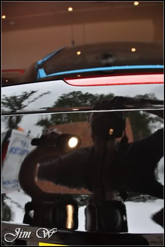

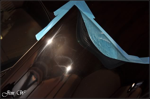

Tricky areas on the C-Pillar:
Before/After:
Before/After:
Before/After:

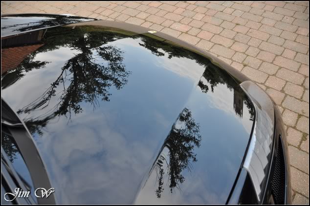

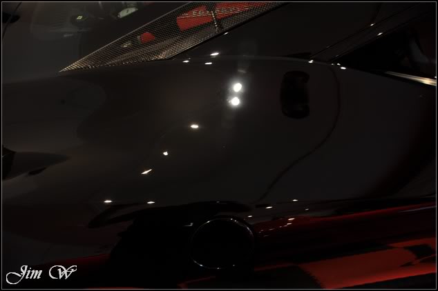

Bonnet – before:
Bonnet – after:

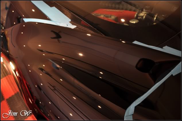

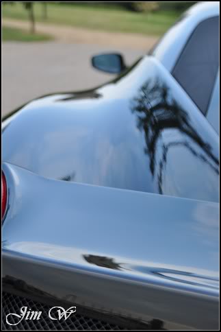

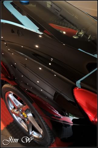

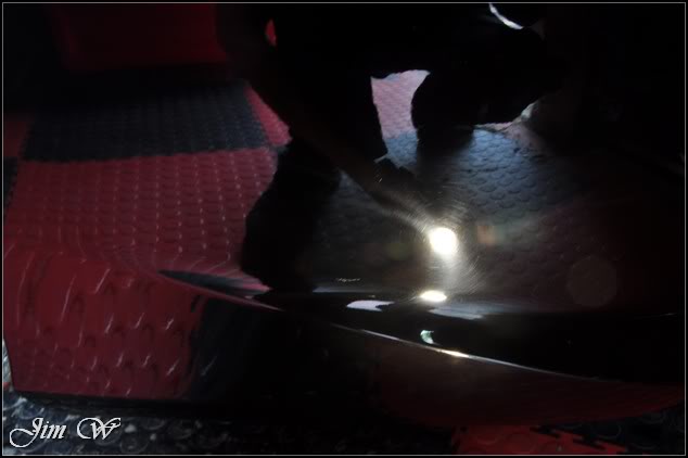

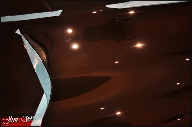

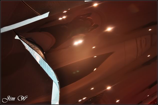

The air intakes at the rear proved to be technically quite challenging! (Lots of contours and curves to follow)
Before/Afters:

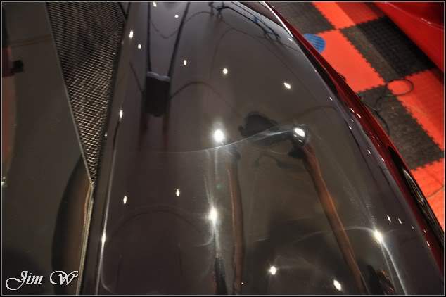

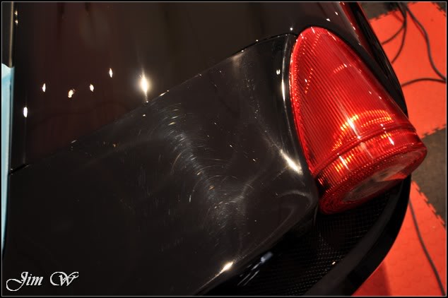

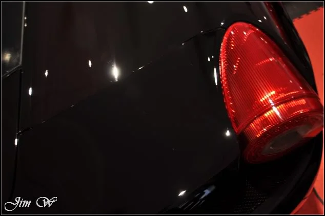

More funky patterns left by poor machine polishing on the rear end:
Before/After:

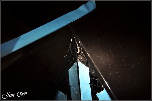

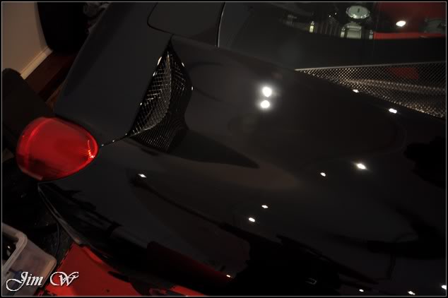

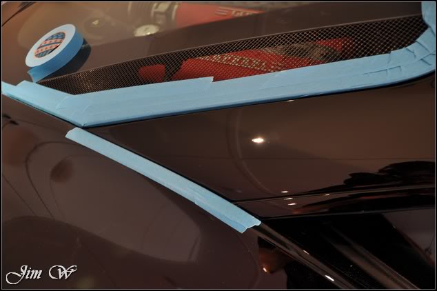

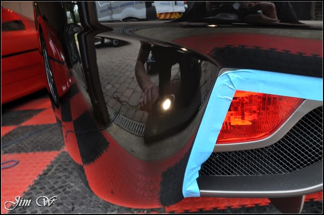

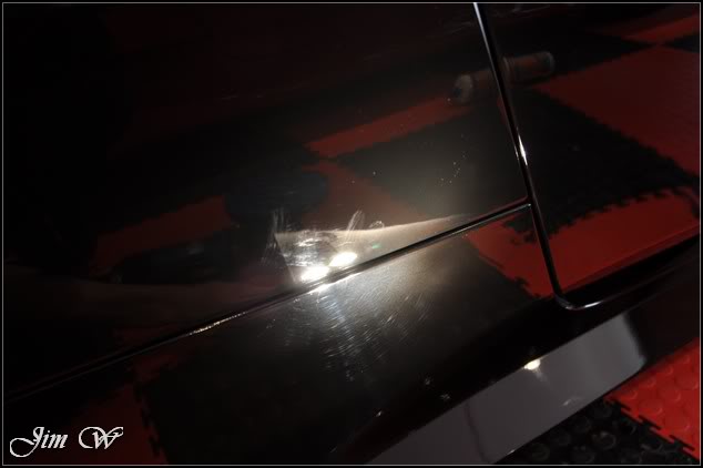

Ooops. Whilst taping the N/S rear air-intake, much like the O/S, I noticed this little notch on the upper leading edge:
Someone got a little too close here; scuff no doubt caused by backing plate of machine polisher. Right handed users, be warned – expect to find yourself in some real awkward positions!
Continued to tape > corrected > refined:

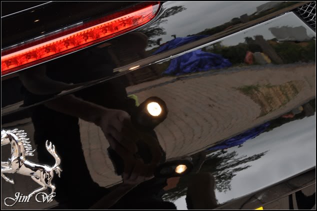

Sanding marks and swirls on rear end:
Before/After:

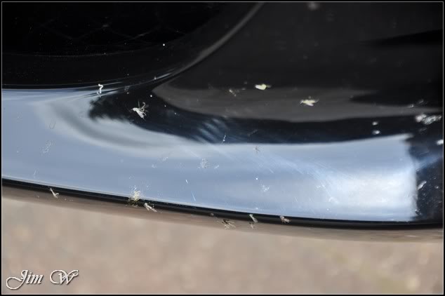

The finishing touches (wipedowns, wax, dressings etc) had to be completed outside. What a nightmare. If it wasn’t the sun it was the wind & dust (open area with lots of fields) If it wasn’t the wind, ugh, it was the bugs:
I lost count of how many of these midges I squished whilst buffing/wiping etc. Total pain! Having to check every inch of the paintwork before I made physical contact with a buffing towel.

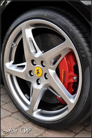

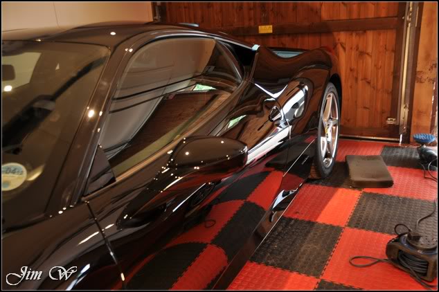

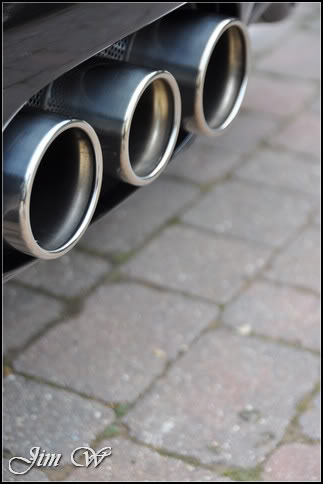

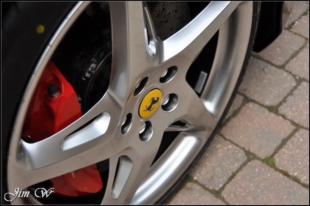

With the glass, wheels, tyres and exhausts sorted, we were about there.

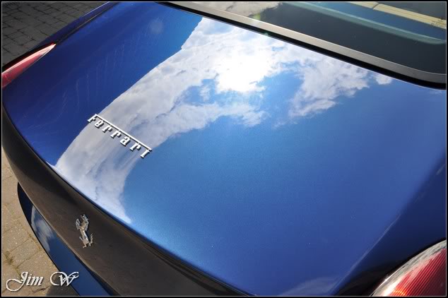

The following day (day 3), the California went through its maintenance protection detail (again, finished with Raceglaze black label)

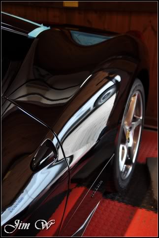

After which, the Italia was given a final wipedown to remove any gassing smears by the wax and jobs a good’un!

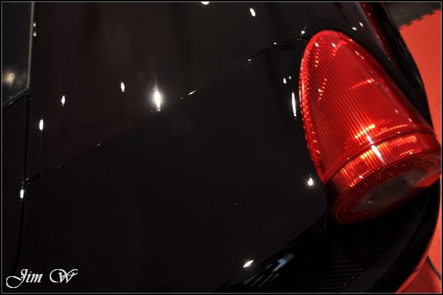

Remember, before/after:

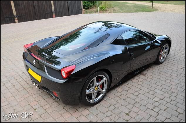

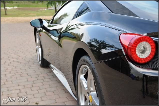

16 hours later, the 458 was finished.
A truly awesome car.

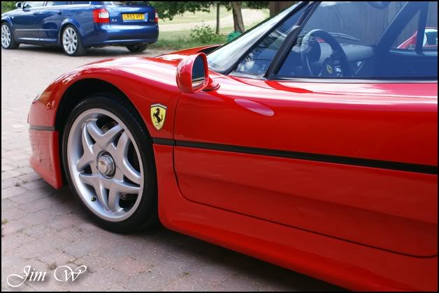

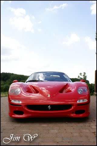

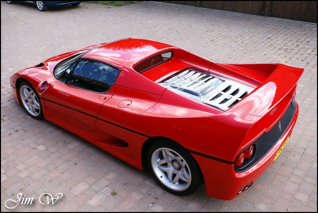

Android, some F50 pics for you:
