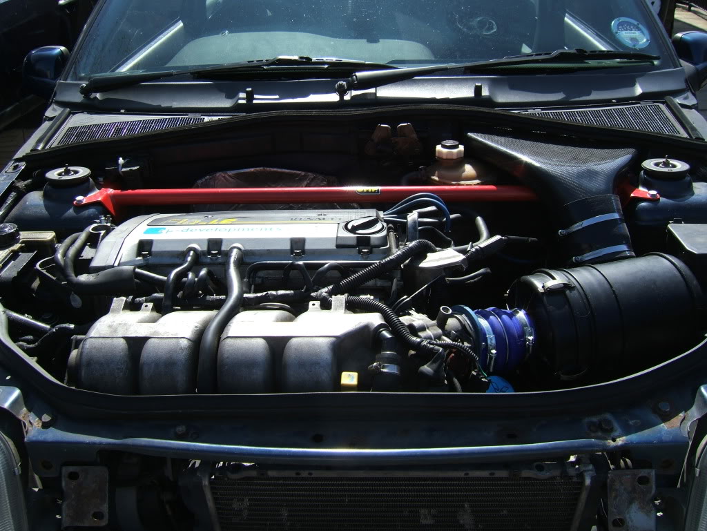

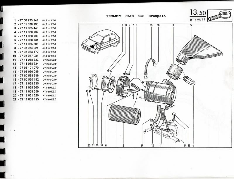

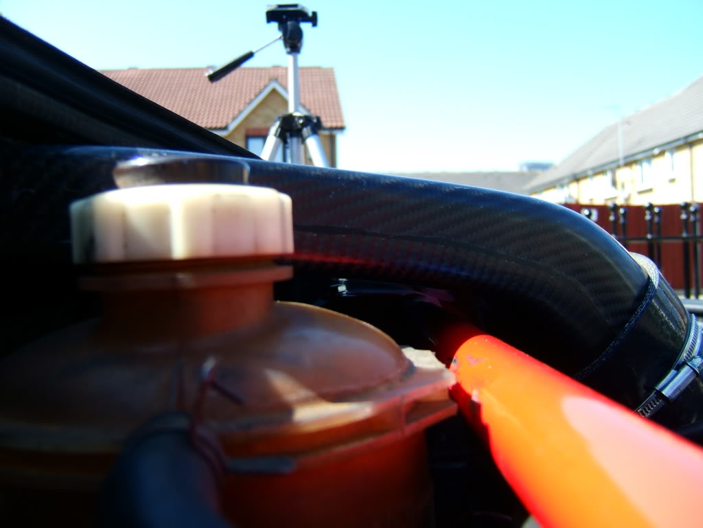

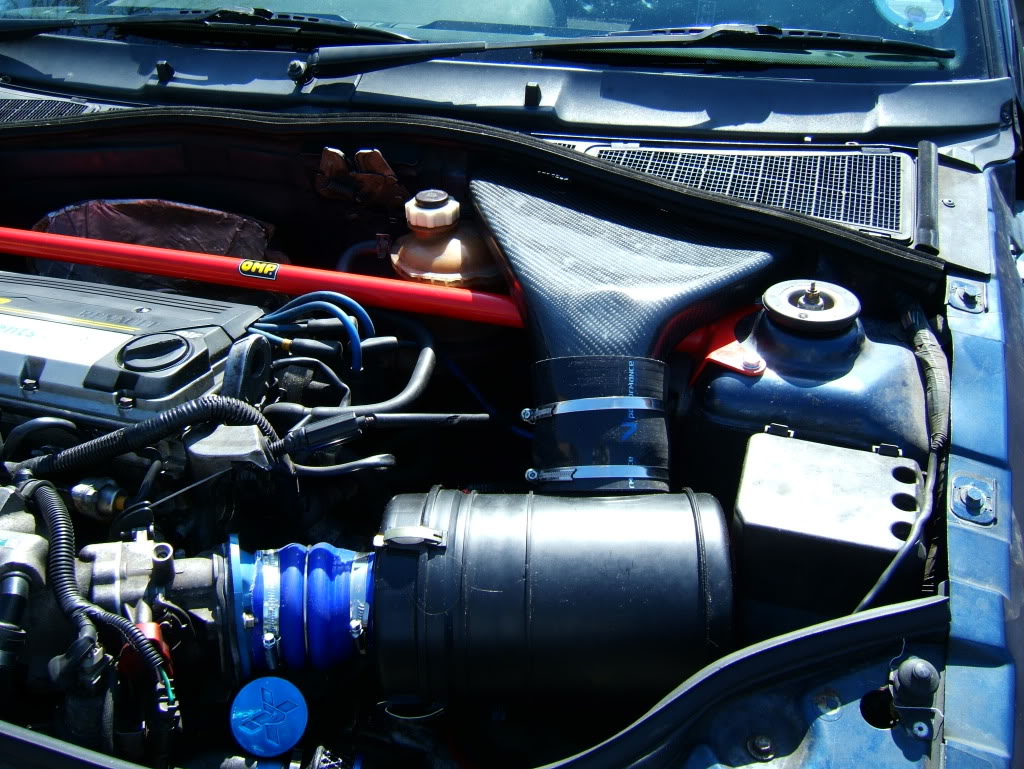

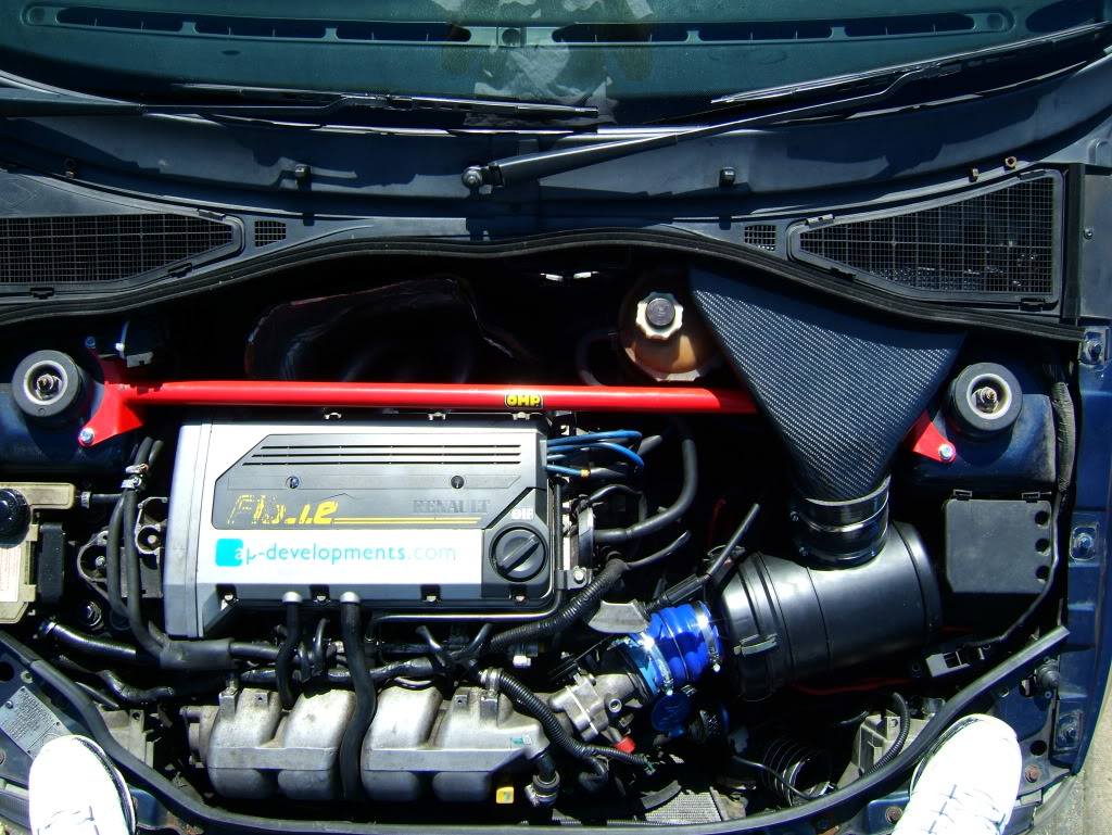

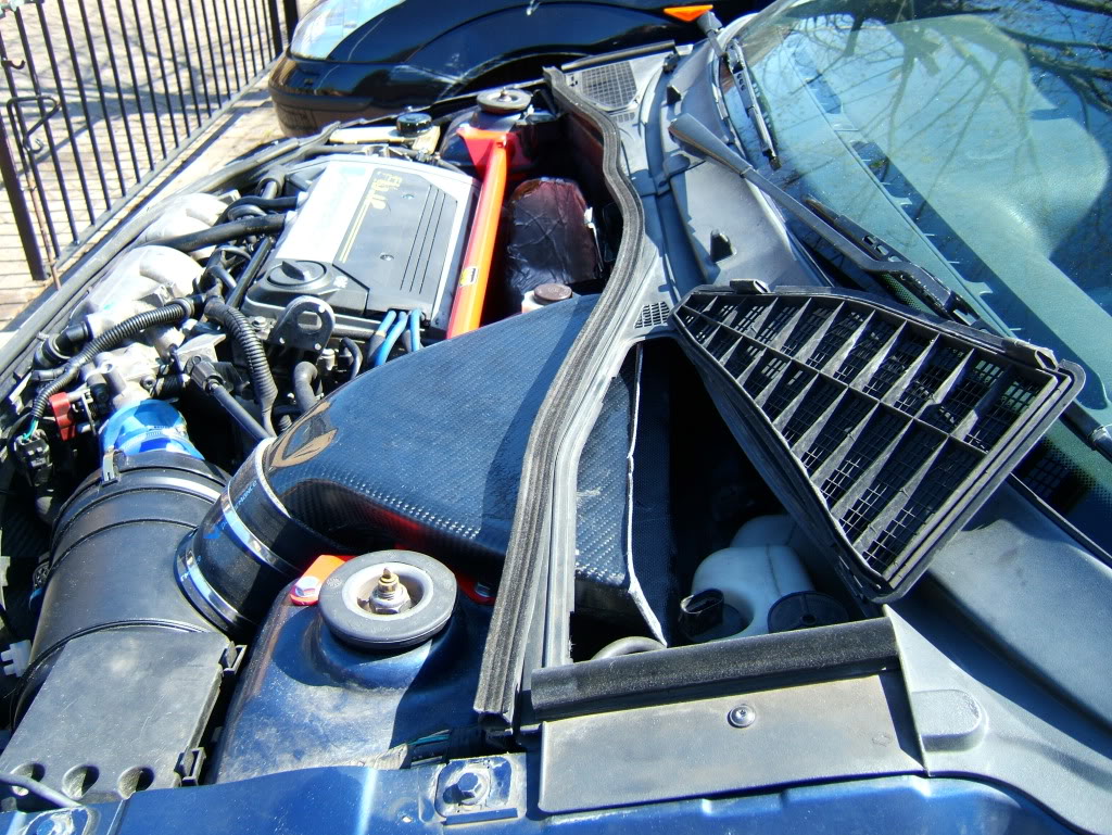

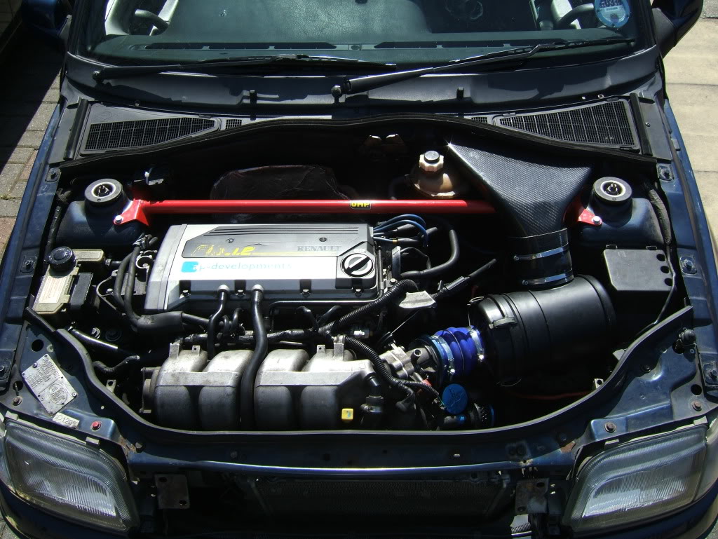

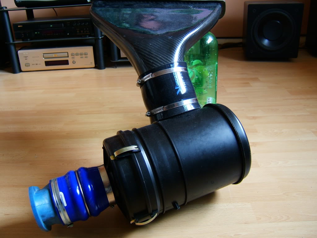

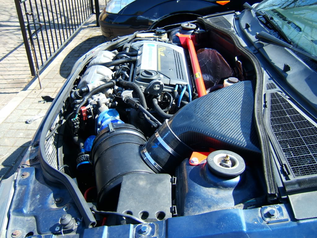

was off work this week so set about fitting my group a induction kit on to the hybrid, this set up was used many moons ago by renaultsport on the group a car back in the early 90's (most of the mk1 boys will probably know this) so i knew it would work well. it ended up being a bit of a pain in the ass to fit properly with lots of things needing moving and chopping but 2 days later and its done:) also took a few pics of the car and tried to do a decent vid but kinda failed due to wind noise and traffic lol...

the scuttle induction kit ( v6 airbox ftw;))

Looks like a really good bit of kit!

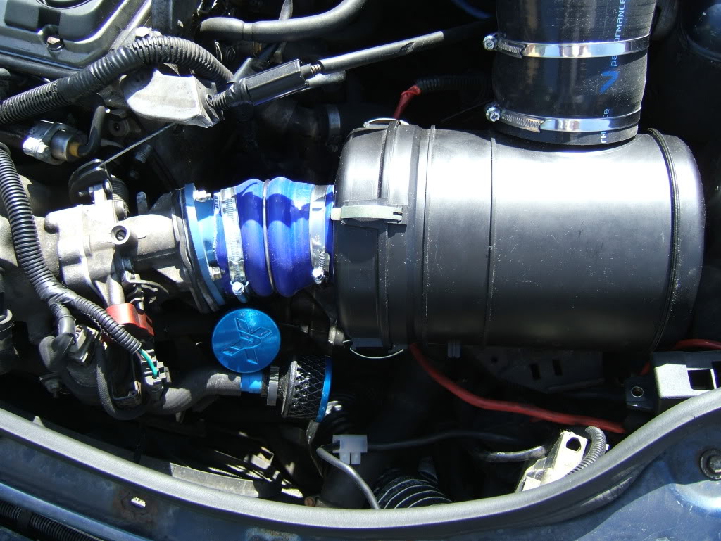

Do those adapter rings not restrict airflow? Massively??
Second part in from left. You can see the size of the throttle body, but the adapter plate looks to shrink in size on the side of the airbox? :S

Nice one Jay, does this have a benefit over Hillpowers version which mounts the filter under the scuttle grille?

b: nah the original tb on the f7r/p's is only 67mm its just that its a funny shape , the adaptor is 80mm and the airbox 70mm, scoop is 100mm

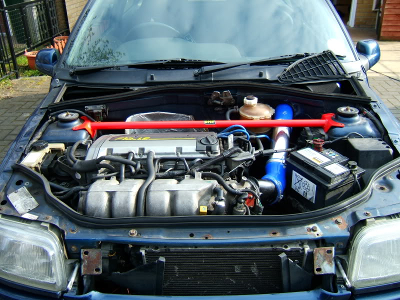

marky: i did have a cold air feed before but that was to the std airbox via a fog light intake ( u can see the old caf in one of the pics, but i took it out few hours ago )
russ: had that kit fitted a few years back, it was very good just a touch too loud for me, its hard to explain but it sounded like the air filter was on the passenger seat lol, i'll pop a pic down below of that one fitted:)

old hillpower scuttle kit

Love that! Gruppe M looking. I think you could work something similar on the 197

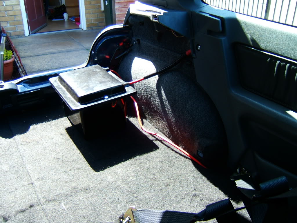

I wouldn't mind such a set-up on mine but re-locating the batter is a fag. Sounds great though.

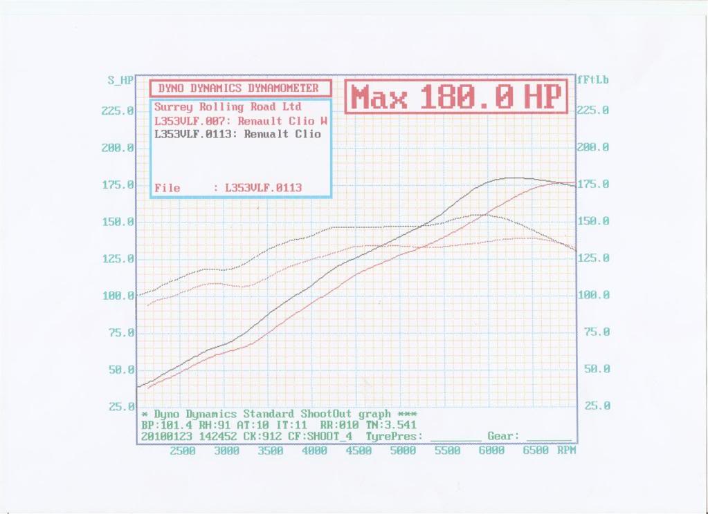

After those new cams and headwork what did it produce in the end? Did you get much of a gain over the old stuff?
I did look at doing somethin like this and deicded that there wasnt really enough room because of the stupid position of the throttle body.
made 180bhp 155lb/ft with the new setup, was 177/139 on the old setup. made very big mid range improvements as you can see from the graph below. could gain an extra 10bhp peak with more aggressive cam timing but that's not what I'm after. you not fancy the jms setup ?

haha yeah thats the one, was way too loud for me every day so had to go. it sounded so unrefined unlike this one which is as quite as std on part throttle but gets loud as you push on:cool: this is roughly what it sounds like now when flooring it:D http://www.youtube.com/watch?v=PSSELSIaEJY&feature=player_embedded
i must say it does seem to be a more efficient way of getting air as i was out for a spirited drive last night it it was showing up as 14.5 ( got an afr gauge) on full throttle should be around 12.5 ( it was like this with the std airbox) this would indicate that there is more air passing through the system but not burning correctly. it did slowly start to get better and finished around 13.5 (ecu trying to adjust itself at a guess) at the end of the night, i'll keep an eye on it over the next week and if it doesn't get better i'll book it in for a tweak of the map at rs tuning.
