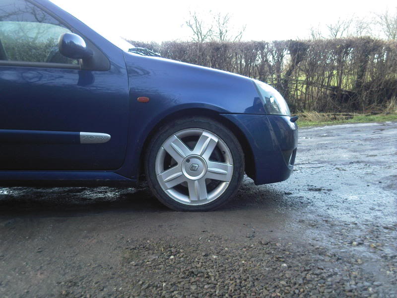

And im not sure if it has been lowered but this is the ride height (the car is completely standard so shouldnt of thought its lowered and renault didnt mention it if theres a snapped spring?)

Arch wise, they look fine from the pic. can't see why they would have been rubbing really. :S

The inner arch liners being worn sounds weird. Have they ever popped off and dragged on the car or ground? Mine have wear marks on both sides, but that's due to going a bit low with the coilovers :)

I have had bits of wheel arch trim drop, one pece is currently held up by tie wraps. New ones are £75 for the bigger pieces. In general they are held together with nylon fixings that lock into metal brackets on the car structure.
As they are plastic they can put a groove in the tyre. Run your hand over the tyre and see where they touch. You need to take the wheel off and make sure they secured out the way. I also had the rear wheel rub on the trim and reset the rear wheels (and then checked it out on a laser system). They is not a lot of space in them there arches.

I shall try and get a pic of the passengr side ride height as this side arch liner has completely rubbed away! theres nothing left but s few worn down bits and a few clips! :shock:

Unless it has been lowered too much in the past and just not replaced?
