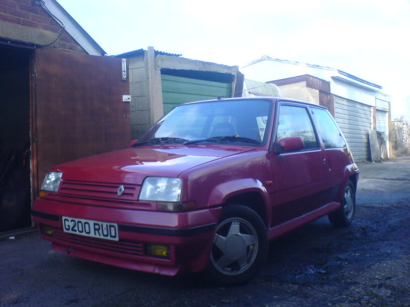

Thought i would put up a few pics of my new toy!

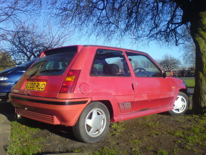

How it was when i first bought it. Bit of a sorry faded state!

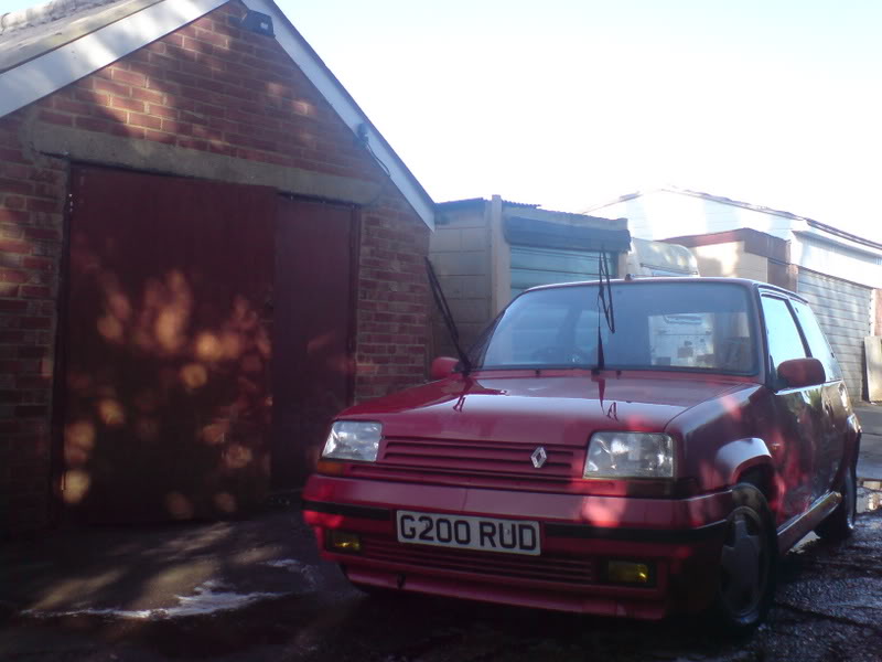

After a wash, ready for serious t-cutting!

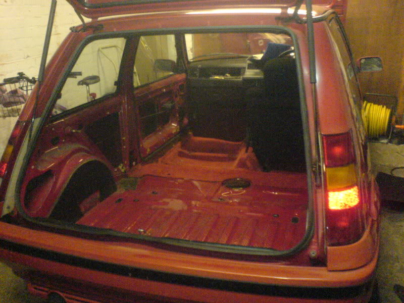

Let stripping commence!

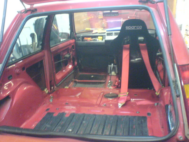

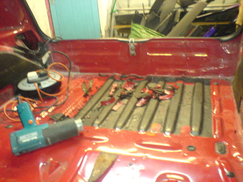

Sound deadening removal
Bucket seat and harness in. All sound deadening out!

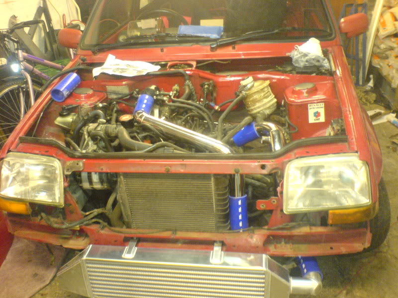

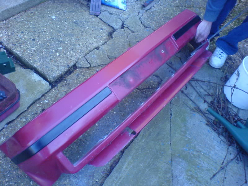

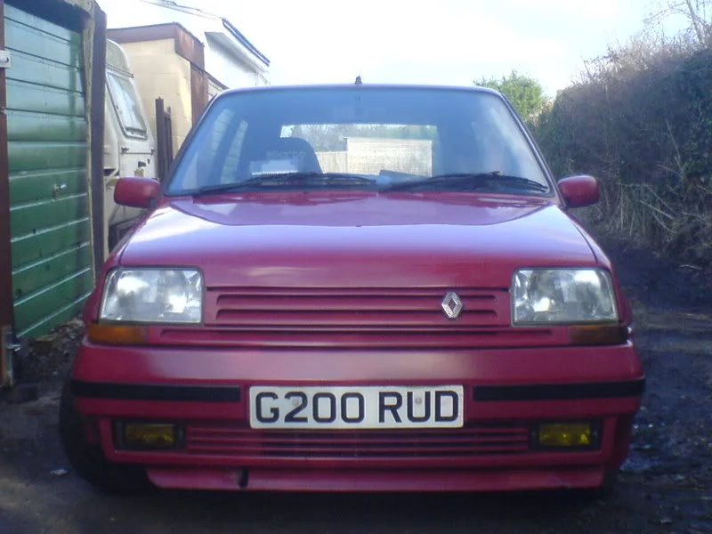

Trial fitting front mounted intercooler
Bumper was fooked anyway so had a play to try and get it to fit over the Intercooler. It will need to cut out more though as the cooler was designed to fit under k-tecs snow plough kit so sticks out quite along way.

Over the next few months i will be getting:
- k-tec downpipe
- AEM wideband air/fuel meter to be put in downpipe
- Koni adjustables
- refurb wheels matt black
- Larger turbo t25/t28 not decided which yet!
- re-jetting the carb
Then it will be hitting the strip!

Roof lining is staying as ive been told its not worth taking out. More hastle than its worth and will make the roof flex like mad! I need to take the foam sound proofing out behind the dash, but will wait till i need to remove the dash first. I had a bit of water in the passenger footwell when i was taking the carpet out so need to find out if it was from the car being washed or if the heater matrix is fooked. If its the latter then dash might be coming out sooner than planned! lol
