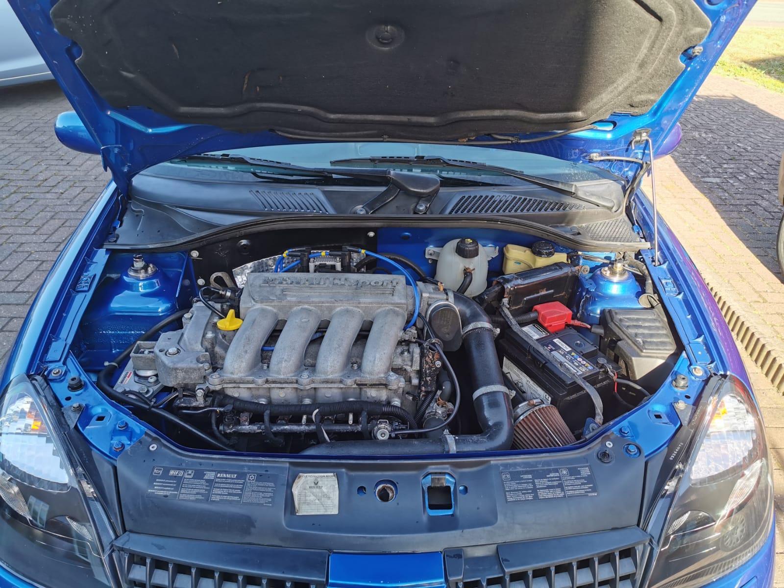

Before above - Rest of the car has received a lot of love over the last 8 years and the engine bay was seriously letting the side down

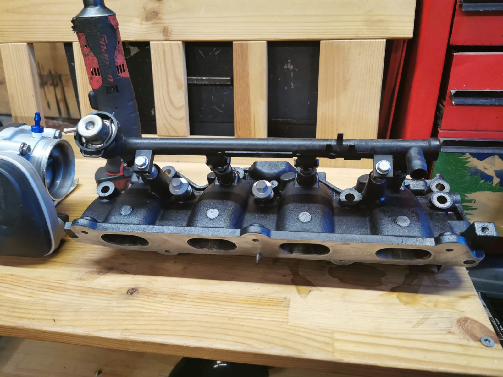

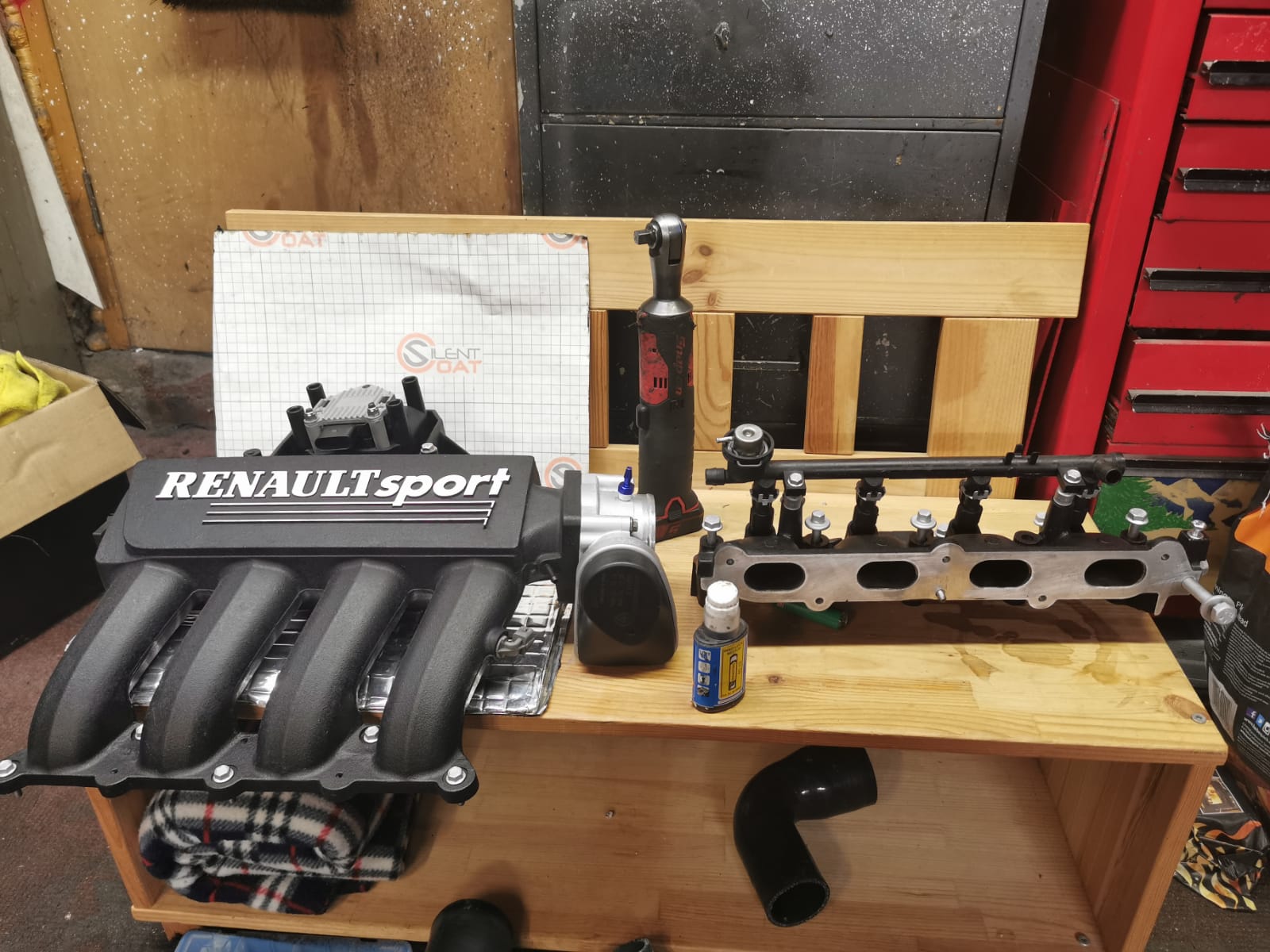

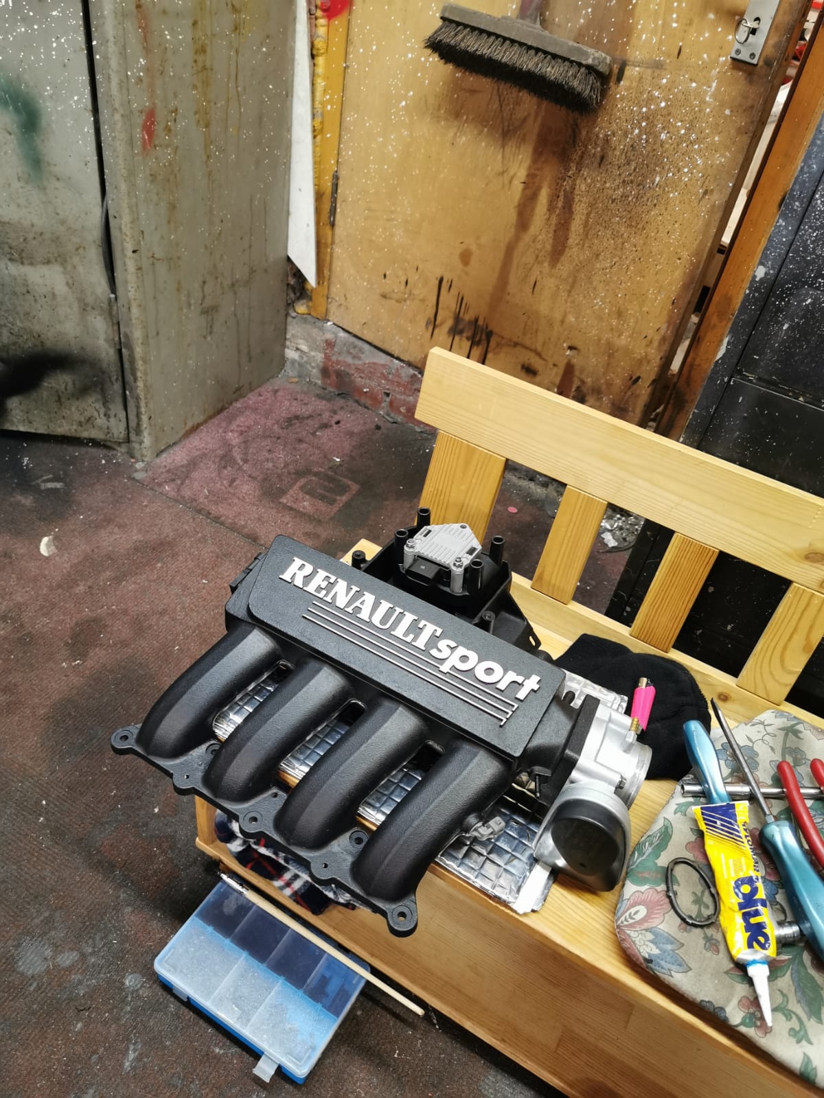

Upper manifold painted with throttle body fully cleaned

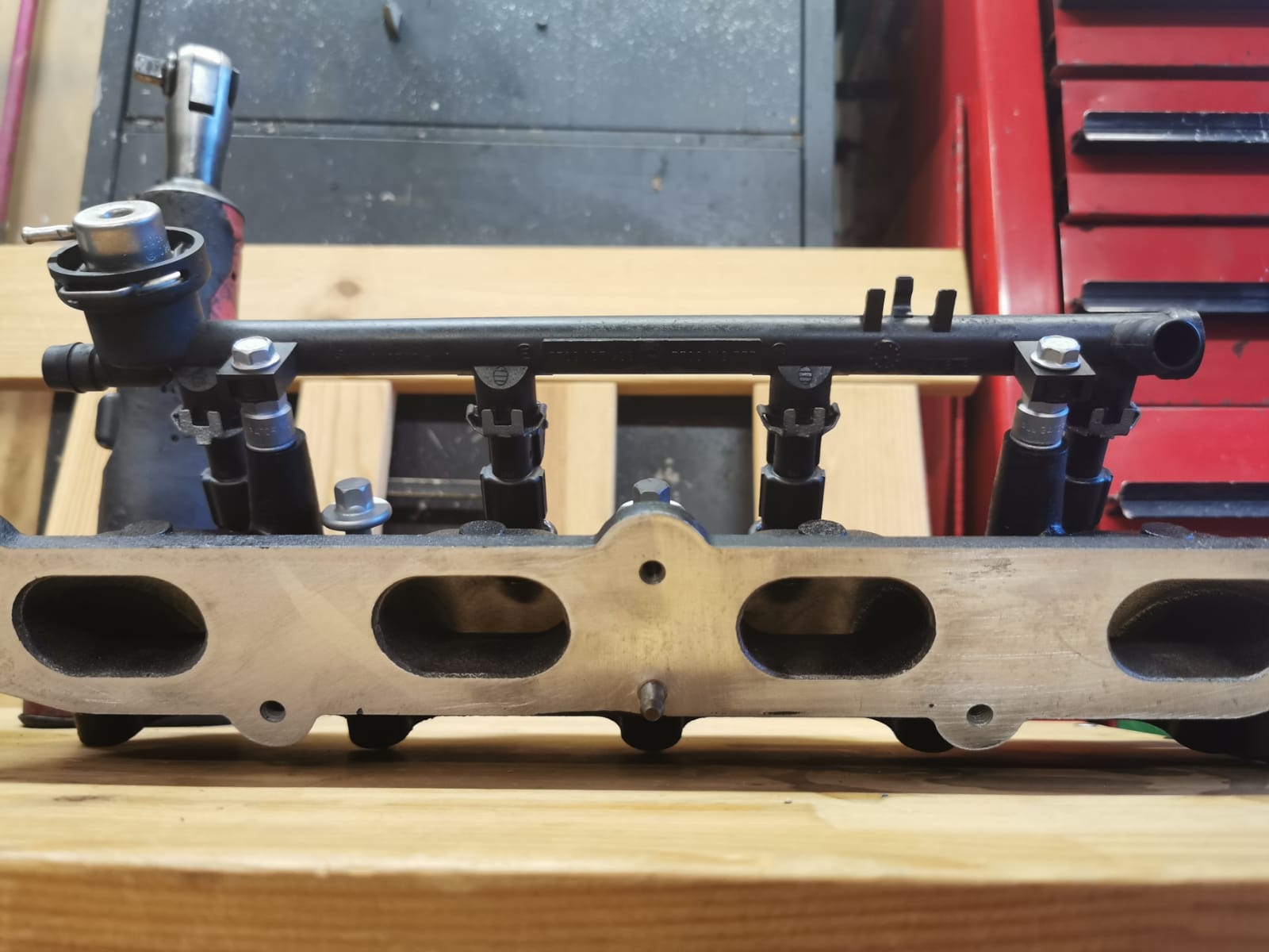

Lower ported and painted with new bolts and fixings for injector rail

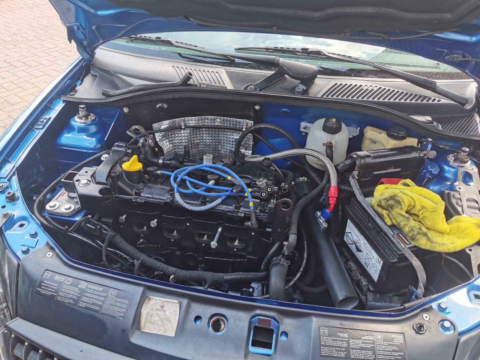

Part way through - boost pipes repainted and new hoses as the other ones were way past their best. New braided line for the oil breather which will be flipped over to the underside when fully fitted.

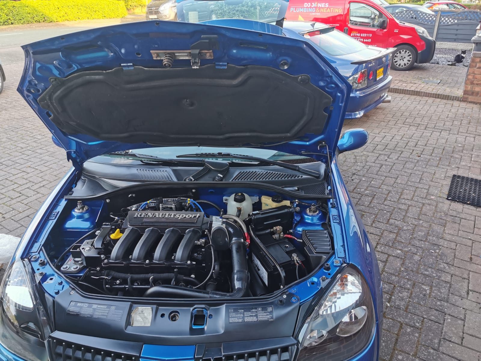

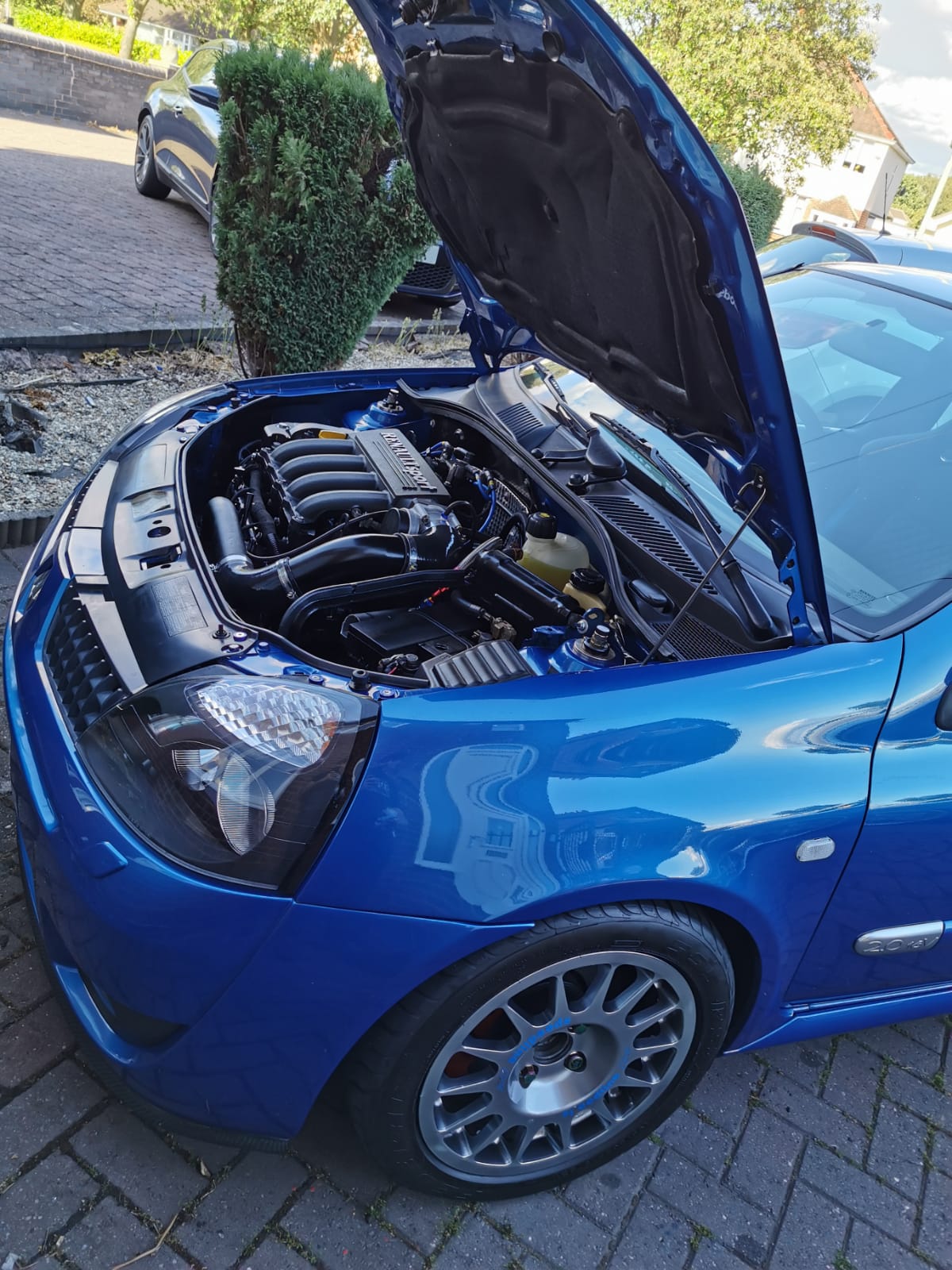

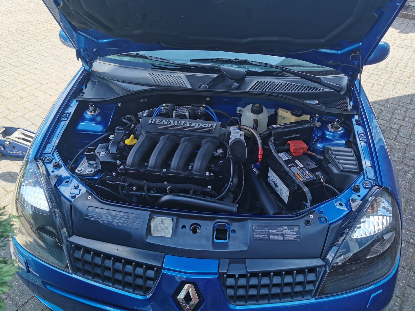

Starting to come together now. Just a few more bits and bobs to do and I should get it back this week. So full list of jobs done:
Water pump and all the pulleys. Timing cover, rocker cover, lower inlet, cylinder head, block, thermostat housing, alternator and upper inlet all done in crackle black. Re routed a load of vacuum lines, remade the injector clamps, tightened the spark plug gaps to cure the misfire, New earth straps, made a dipstick extension and all new bolts, fasteners ands nuts.
