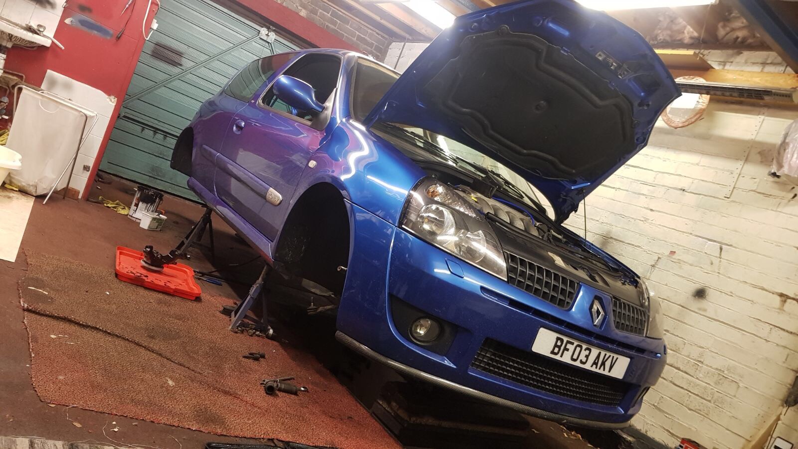

Dropped the car off with the good mate Dean and he has been sending me pictures throughout the build.

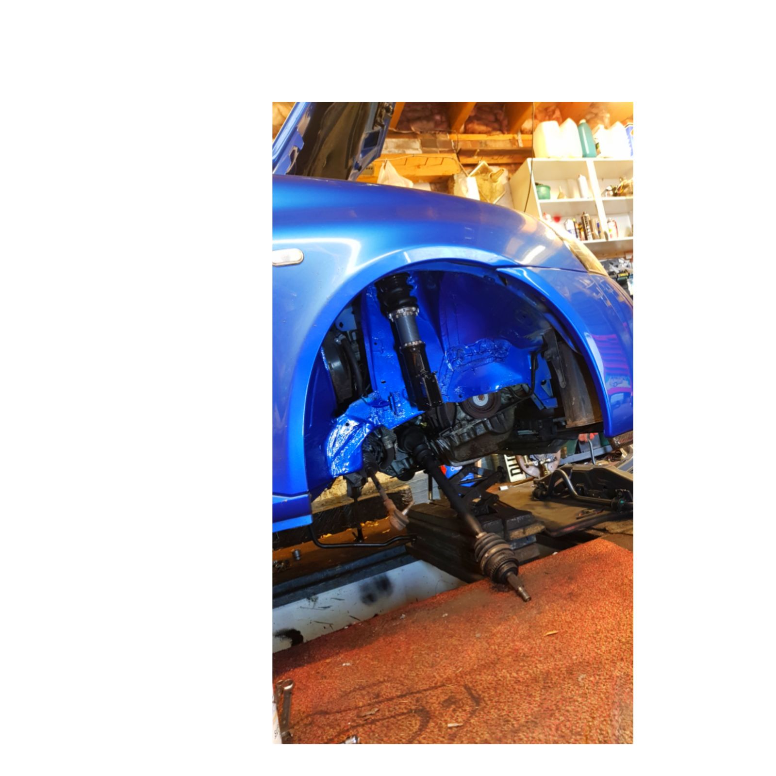

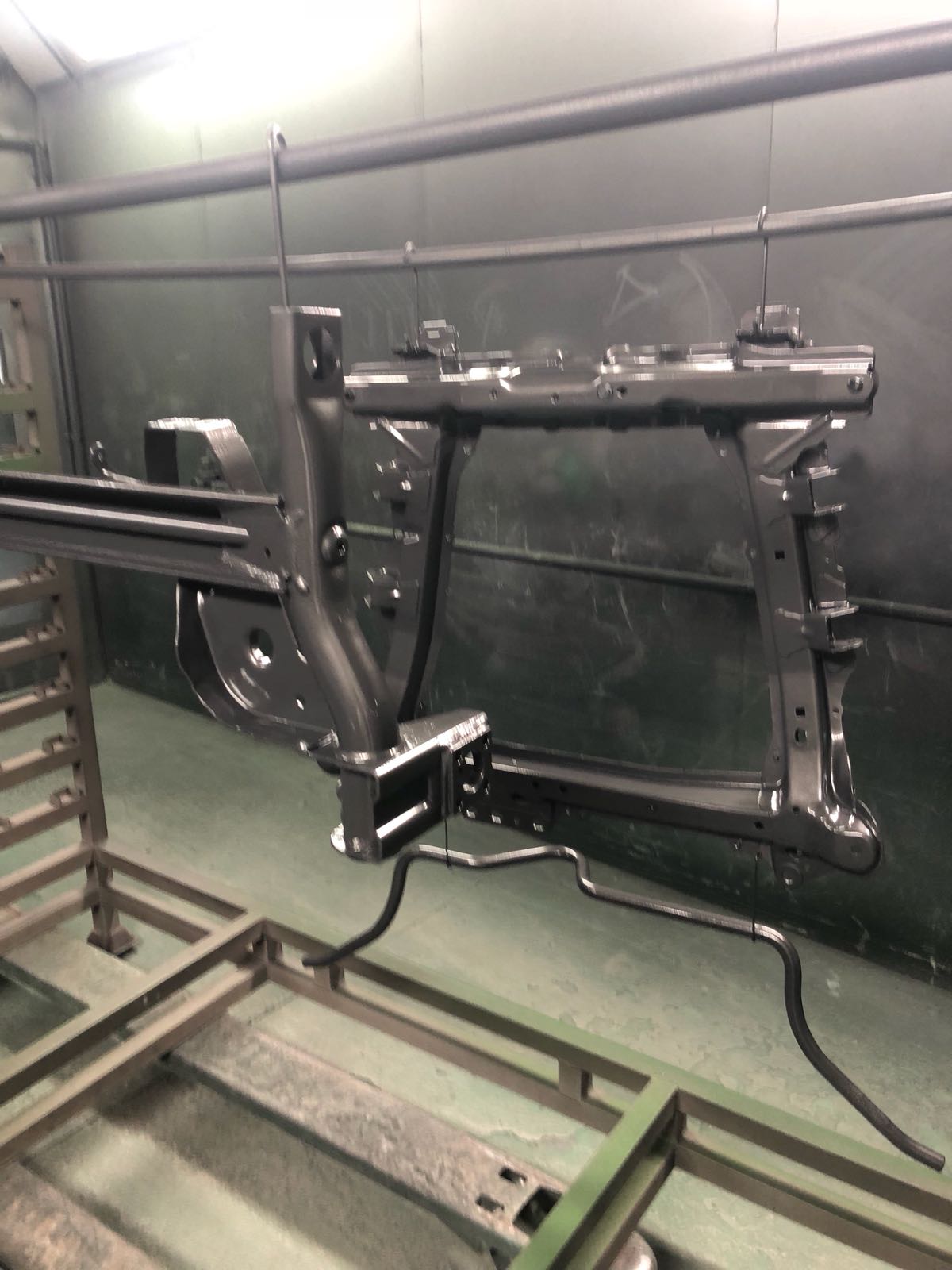

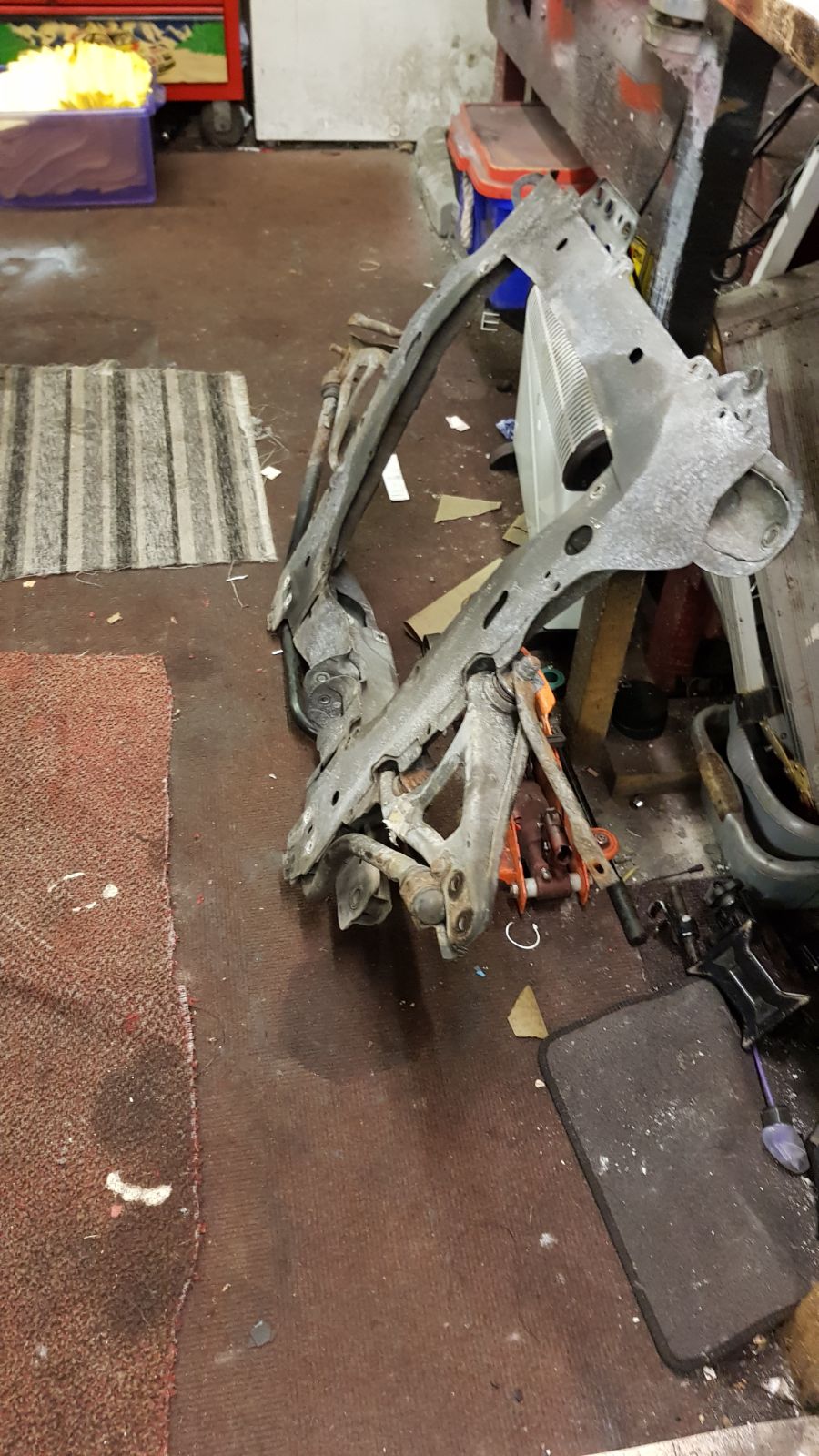

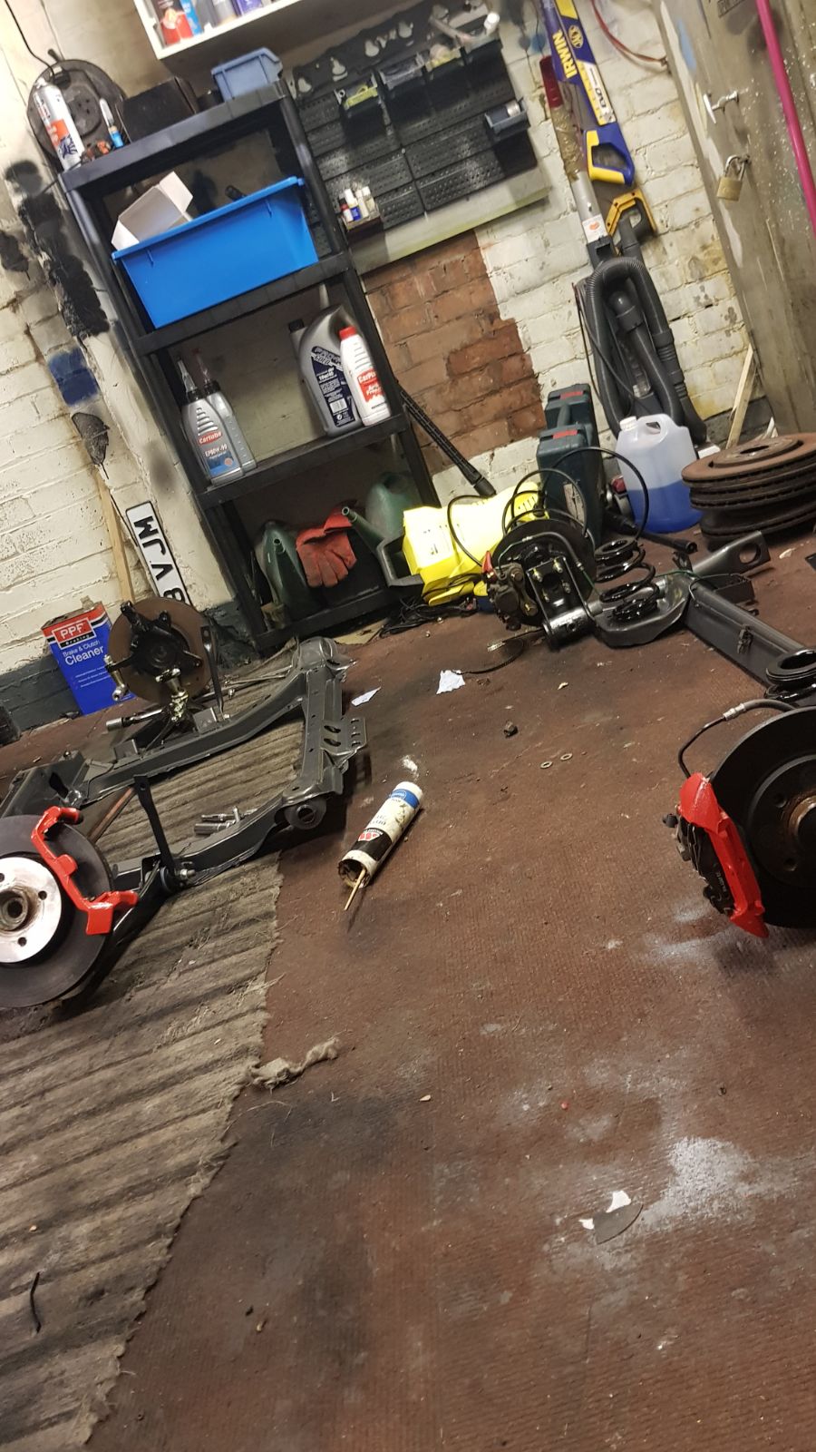

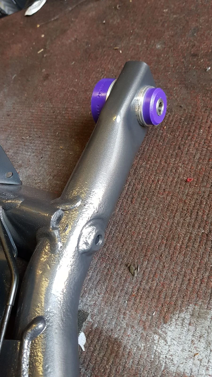

Car up on axle stands with the subrame and rear beam removed. I also wanted everything either painted or powder coated so this is the subframe before and after:
And after:

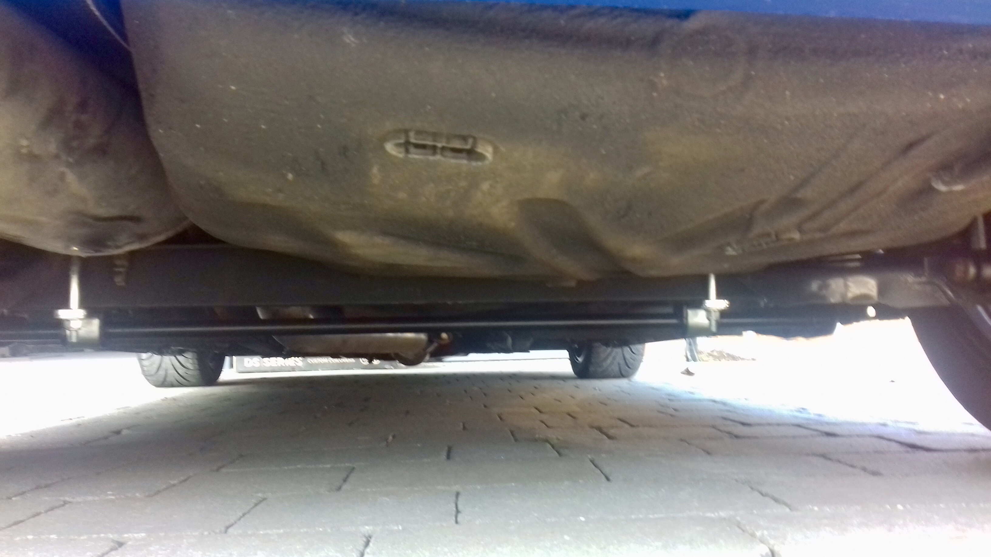

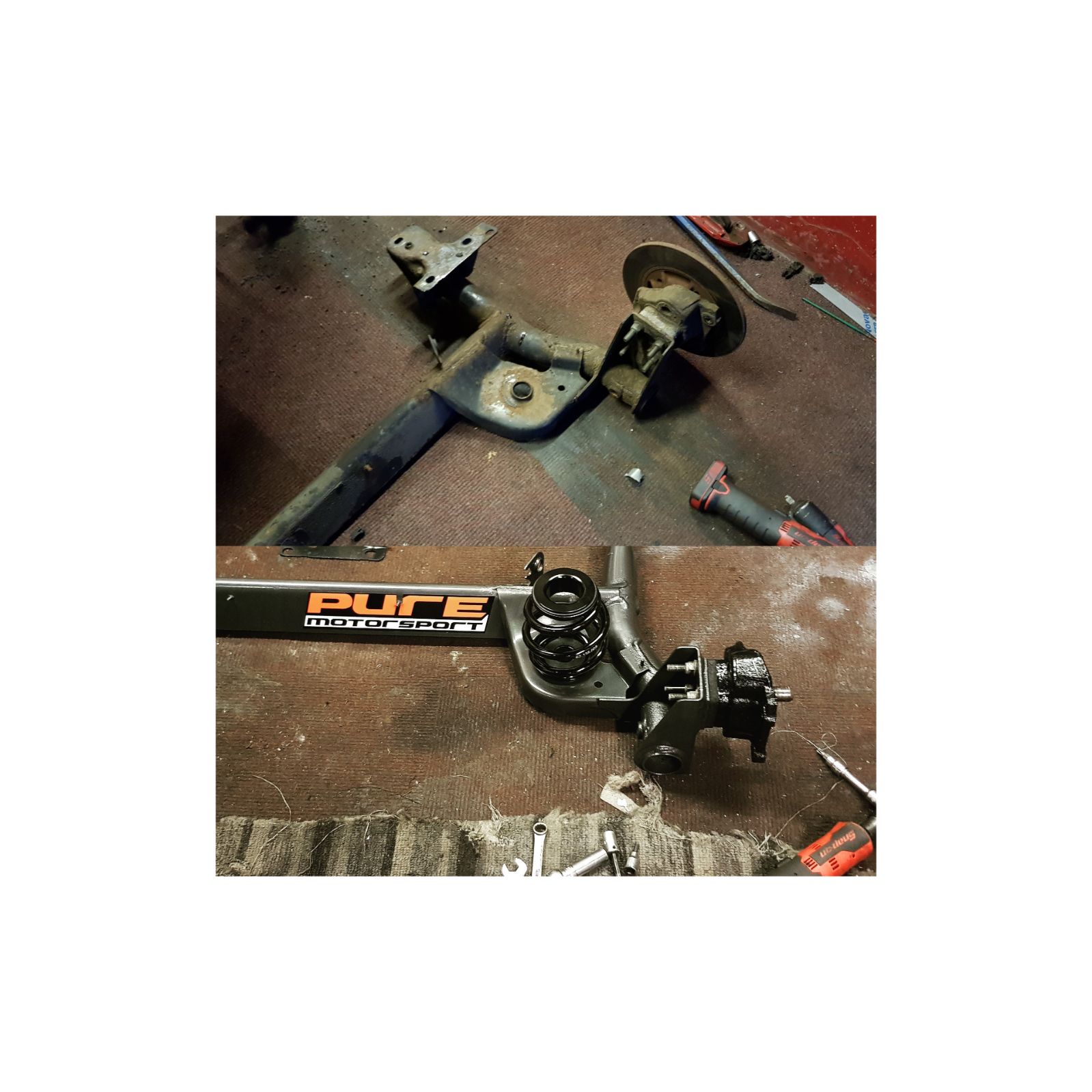

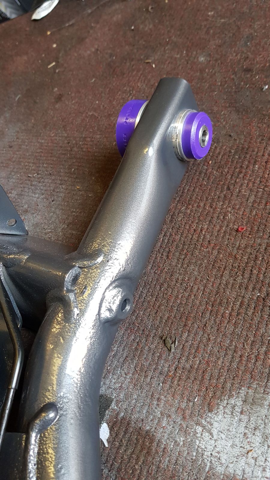

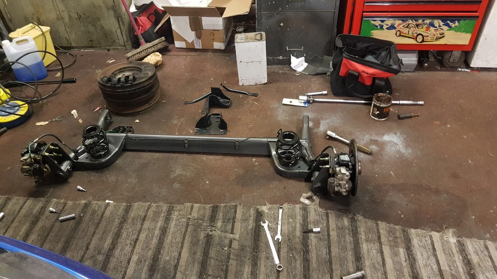

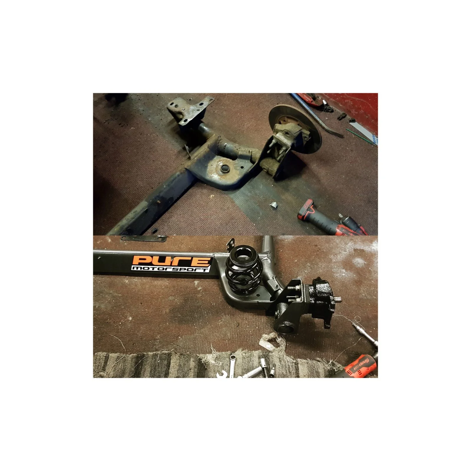

Toyed with the idea of having it black but wanted a bit of a contrast with the rest of the bits so decided on the subframe and rear beam in anthracite. Here is the rear beam before and after:
Few more pics before it all got put back onto the car:

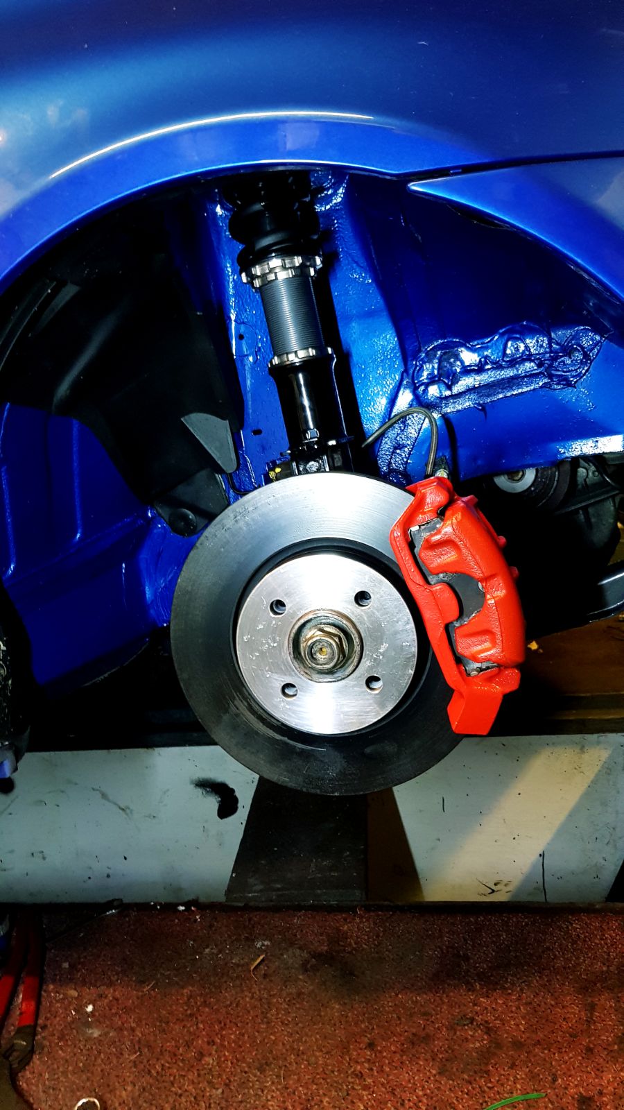

I also wanted to have the arches sprayed so got some mondial blue spray and lacquer and I think it has transformed the look. Plus got to love coilovers :smile:

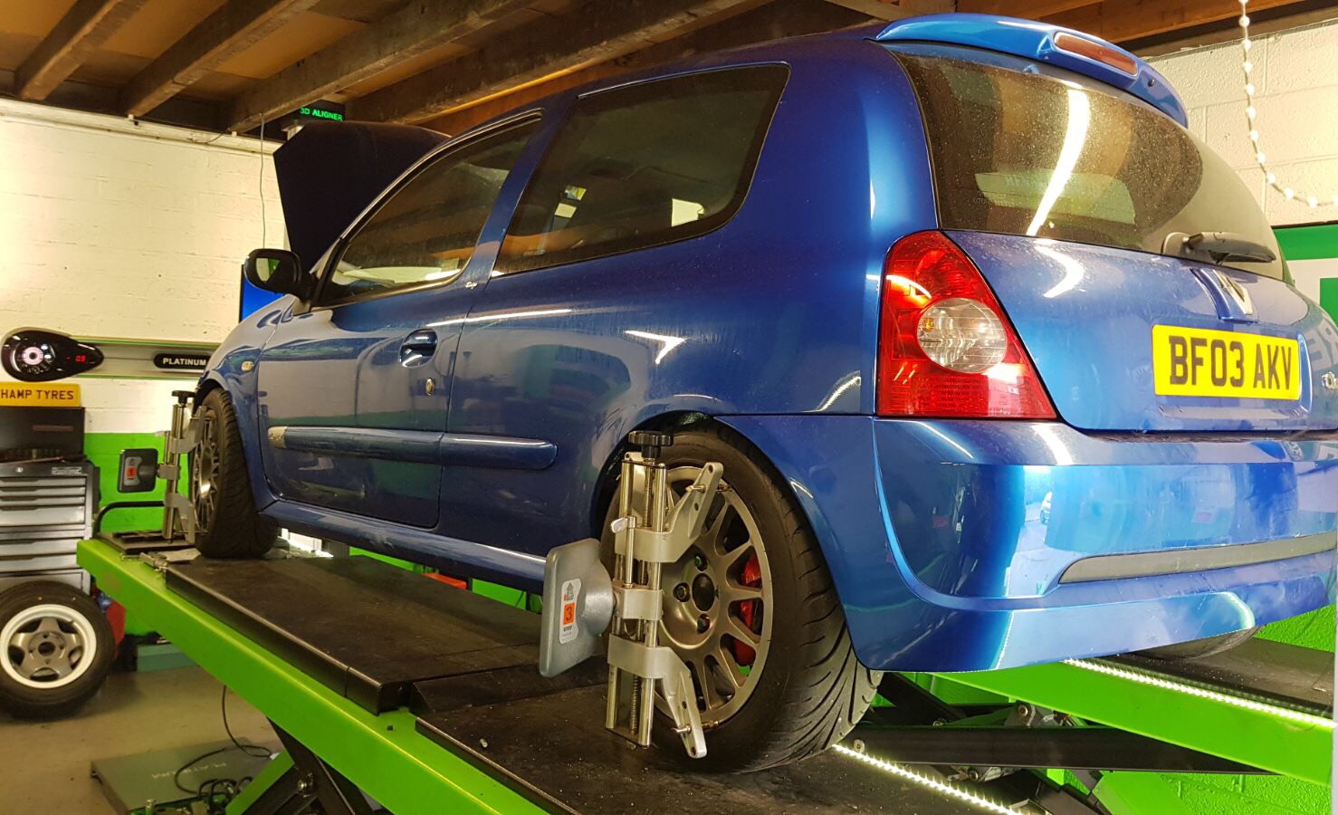

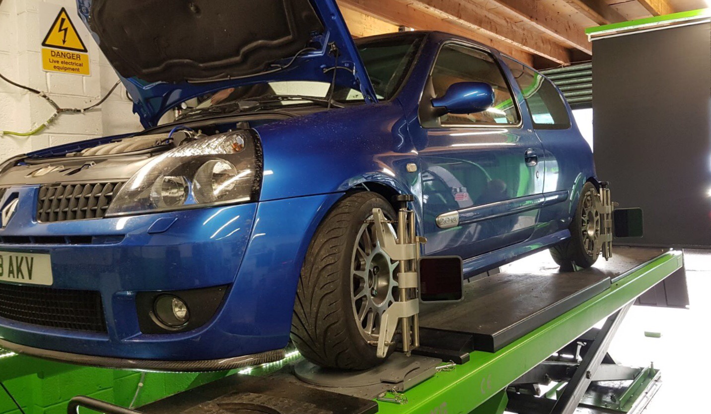

So yesterday it went for 3D laser alignment. Went for 2 degrees of Negative camber at the front and 14 minutes of toe total. Here it is on the ramp:

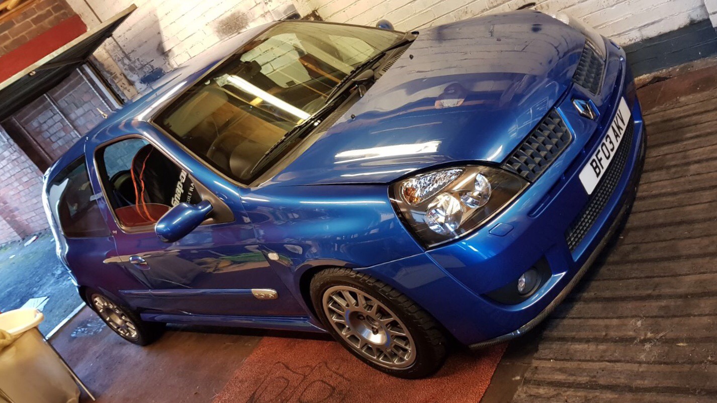

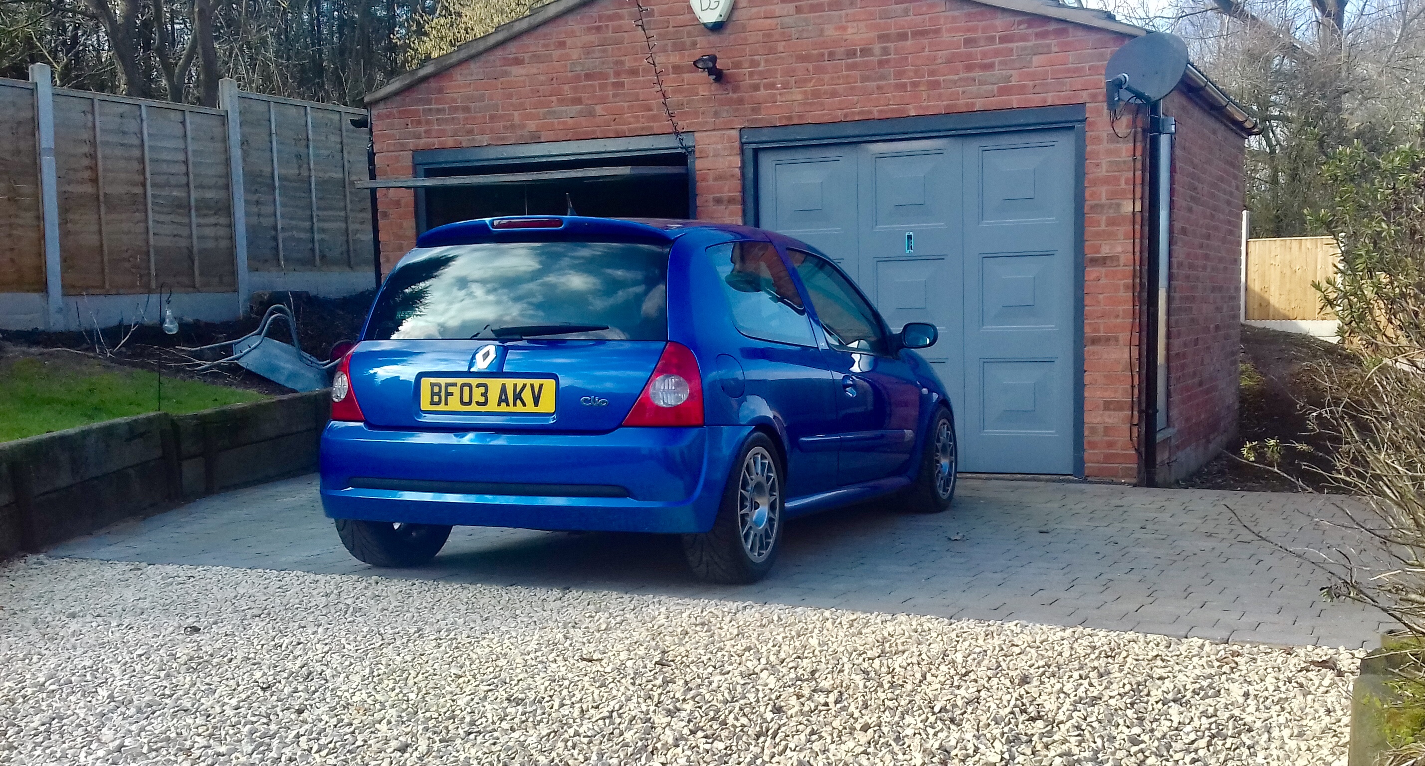

So.....get it back today. Dean is driving it over from Tamworth where his workshop is based. To say i’m excited to drive it is an understatement. Yesterday was like Christmas Eve. Here is the car how it sits:
I’ll update tonight once I have driven it and take some more photos when she is home. :smile:

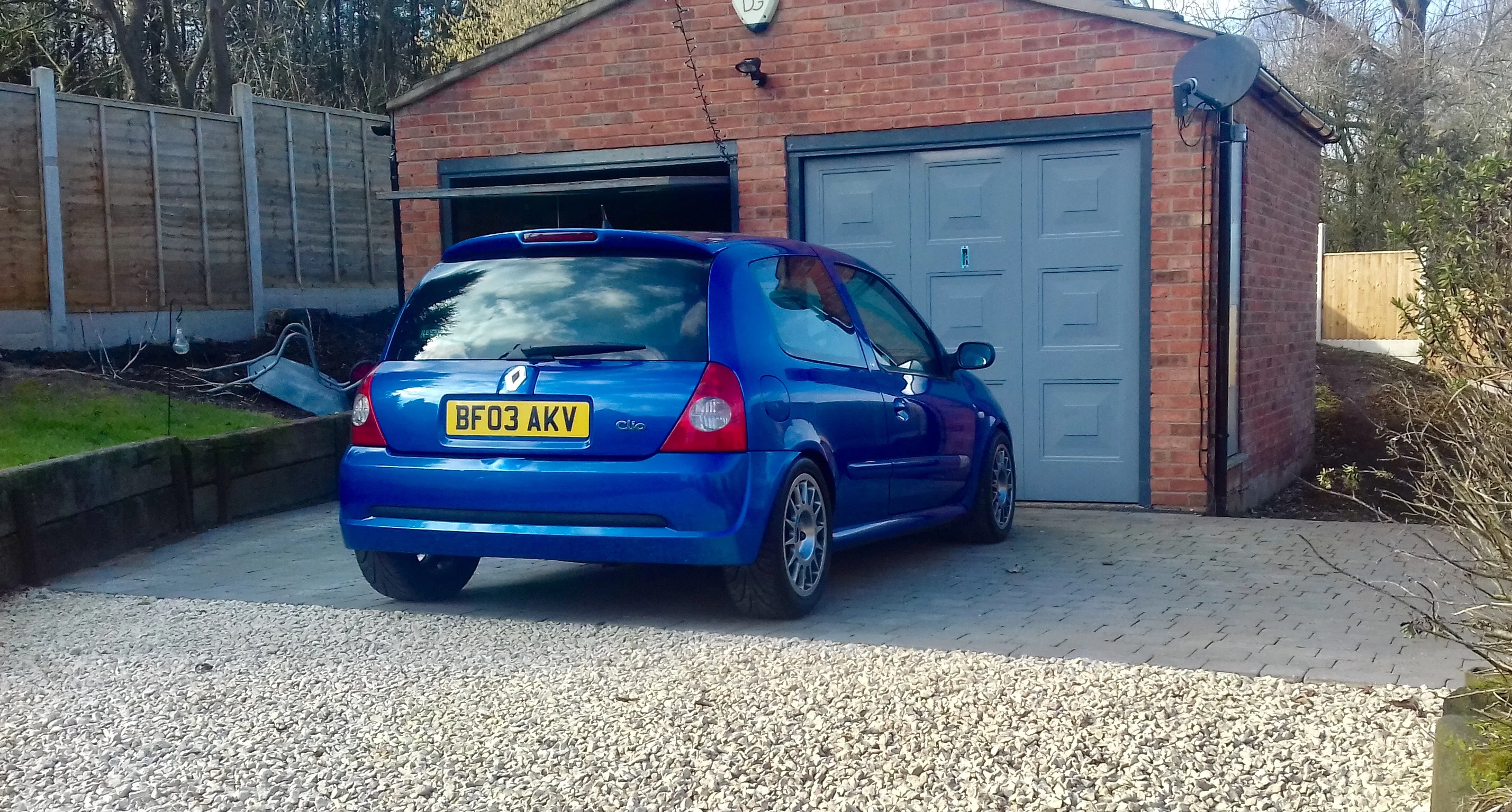

It will be arriving this afternoon. I live out in the country so Dean is going to take me out in it to show me what’s what round some country lanes. Need to go shopping with the other half first so i’ll be champing at thebit when I get back.

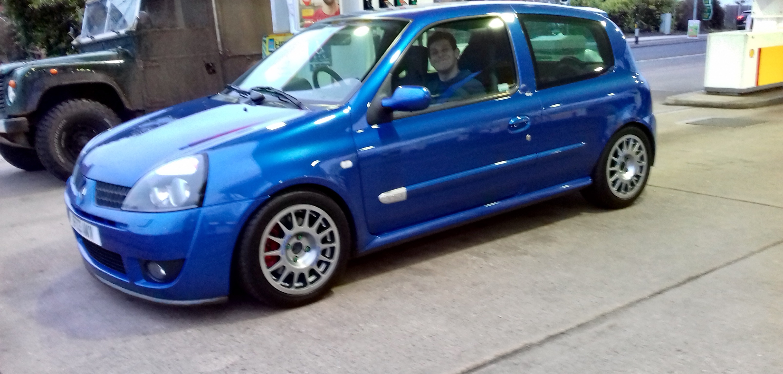

Just a quick petrol station photo just before I got tannoyed to put my phone away :openmouth:
Car feels epic on the road. So planted with the ride as compliant as before. May need to drop the front spacers as they are rubbing a tad. Just need to see if TPI do longer polarised bolts. The 5mm spacers I bought made the front look gash so will need a rethink. The dampers are set to half front and back and that is great on the road. Will try full soft next weekend to see the difference.

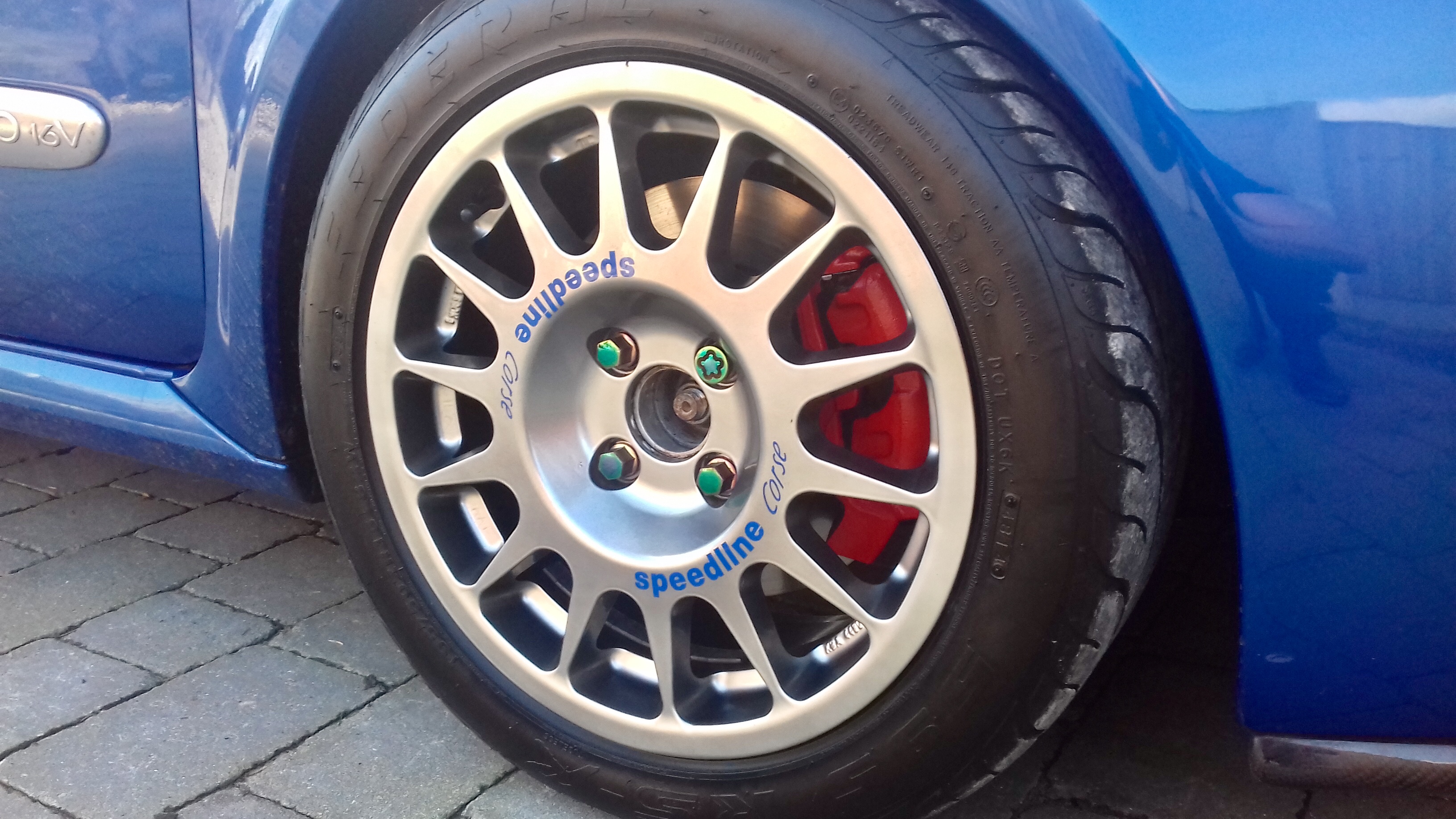

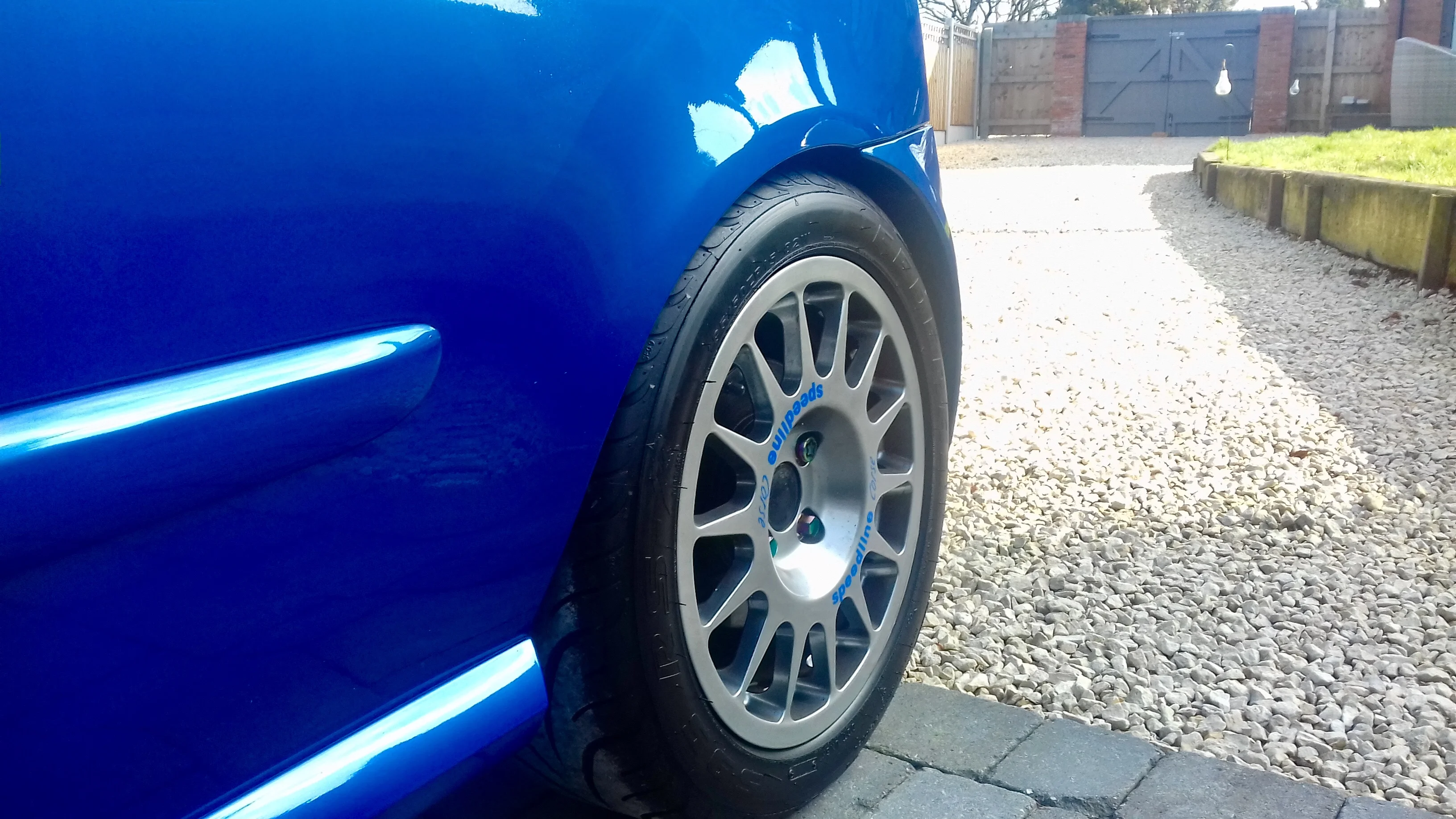

What colour are your 2118’s,i thought they were dark grey but in your latest photo they look more silver?
They’re shadow chrome with more silver added. They look silver in most lights mate. I’ve also added the speedline corse stickers in blue to them recently
Ah nice,any close up photos of them?..im not gonna copy just interested.
I’ll take some this week for u mate as she’s tucked up in bed now :wink:
Wanted them as silver as possible. They glisten really nicely in the sun.
The speedline stickers in blue sound a nice touch, be interested to see the photo close up! :up:
Yeah i’ve had them for ages and debated whether I should put them on or not. They look pretty good to be honest. Contrast nicely with the polarised bolts. I’ll put up a photo later in the week.

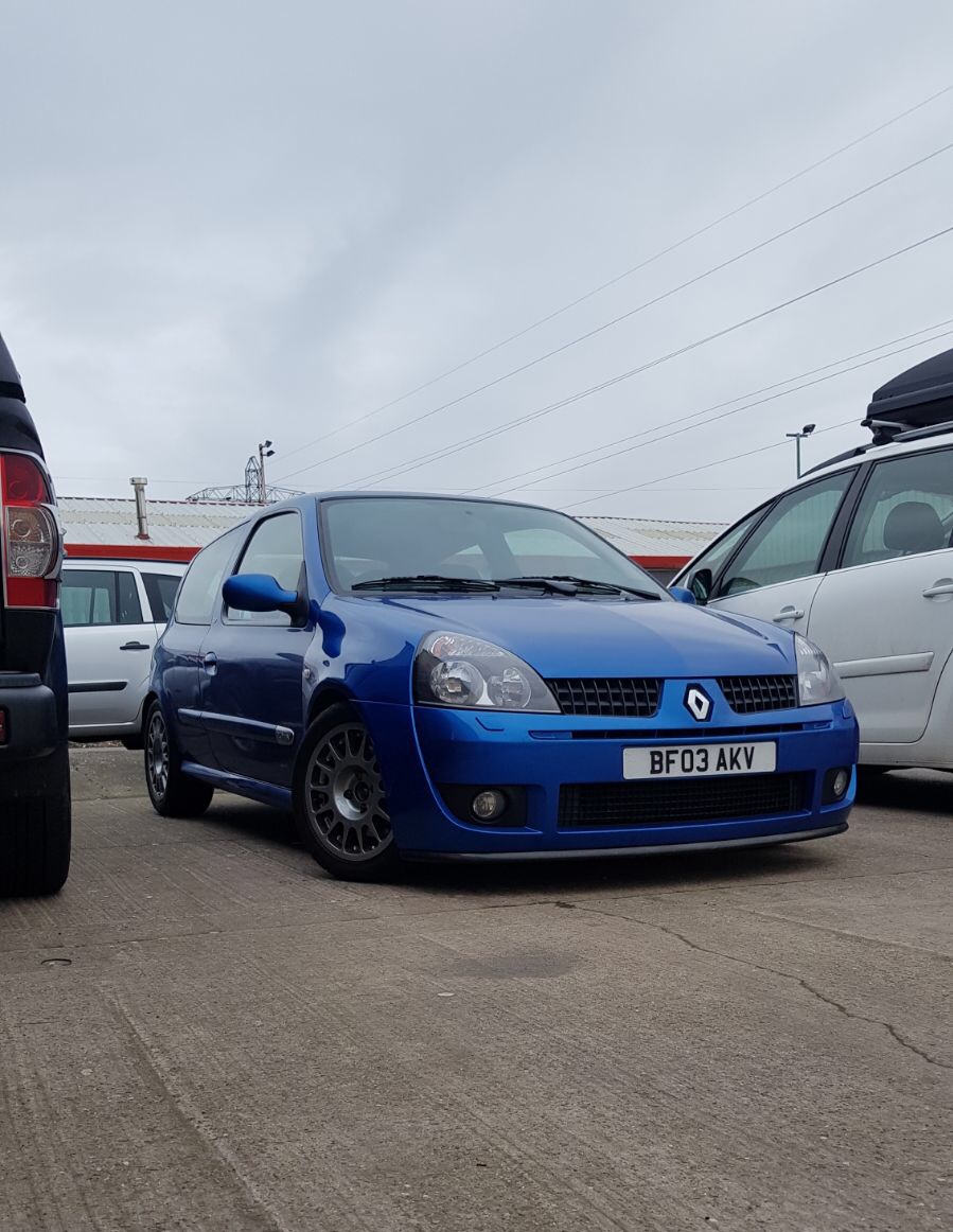

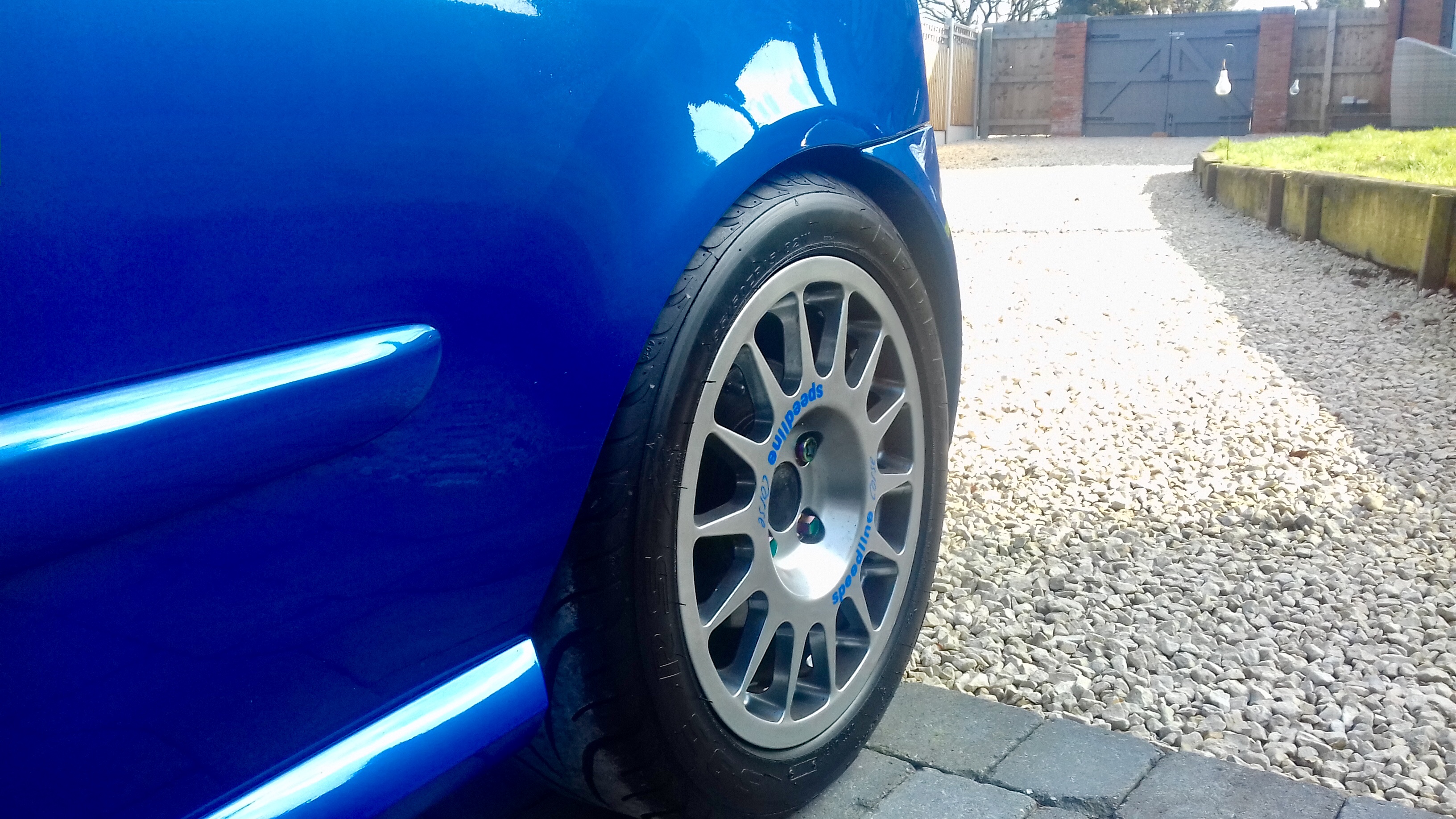

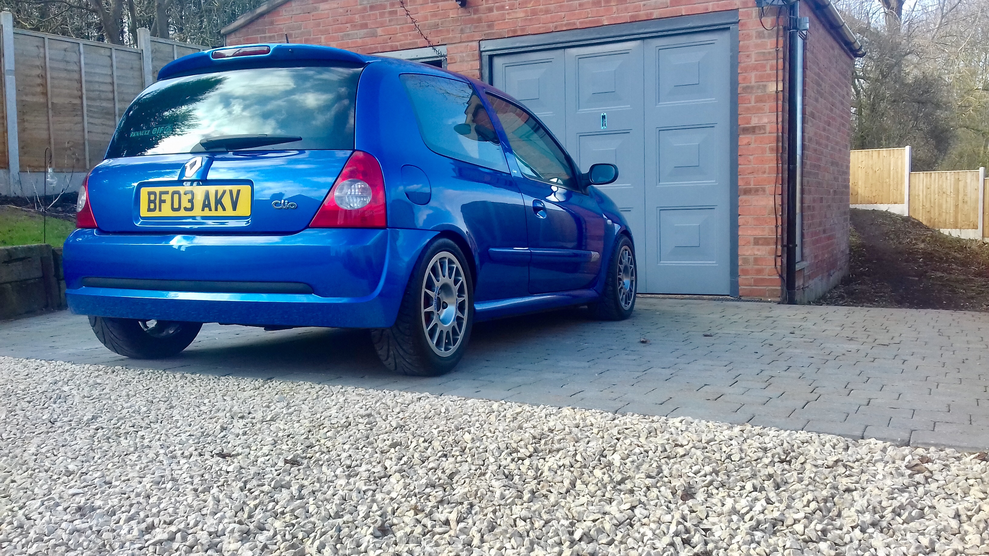

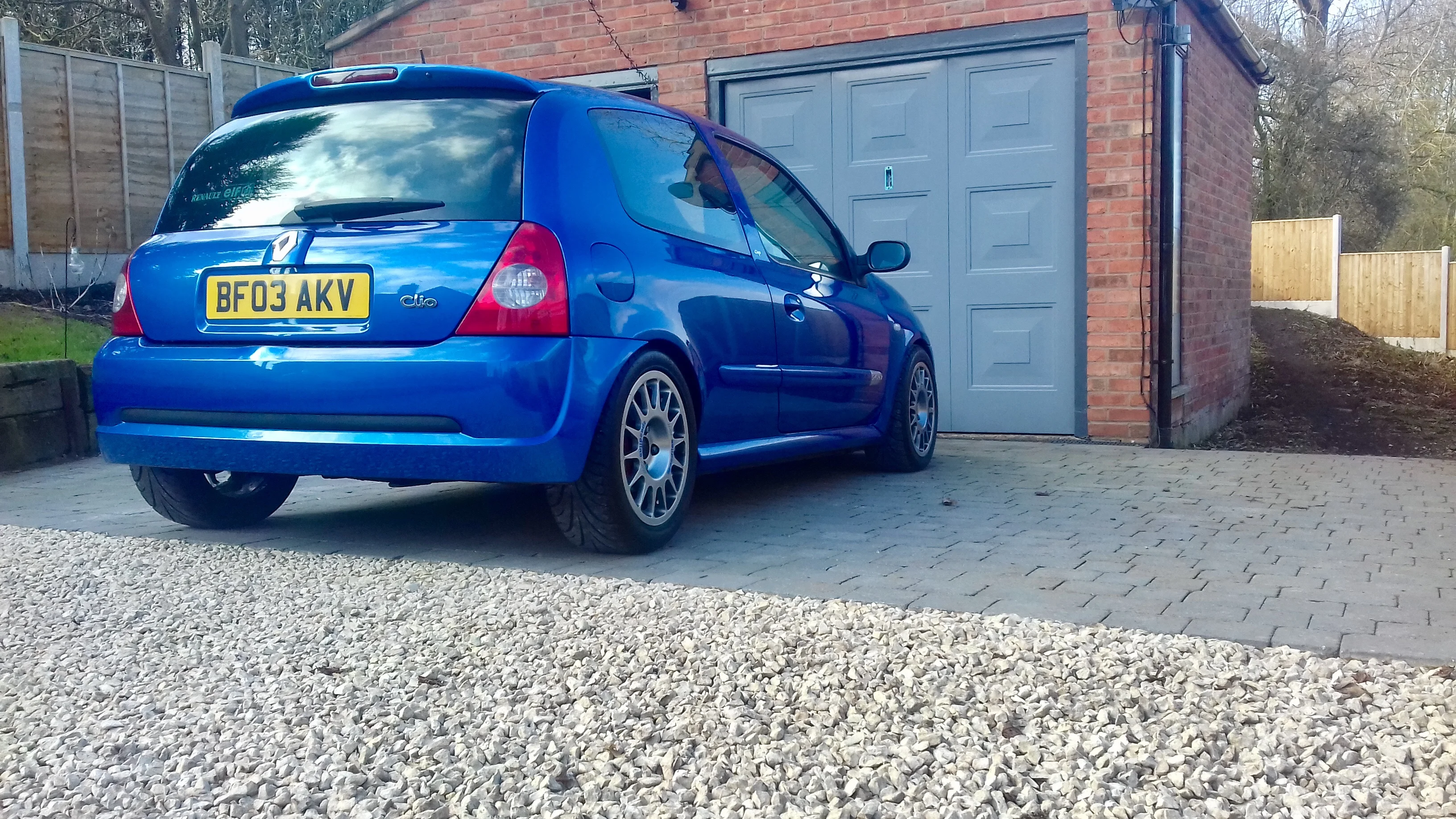

On day off today so thought i’d get her out the garage and take a few pics. I’m going to try my PMS 5mm spacers today to see the difference as the current 25mm ones are rubbing a little on lock. Does anyone know the smallest bolt to hub spacers you can get so i can keep my polarised bolts. I have read 16mm but can’t find any for sale....
Anyway some pics:
I’ll post another up later on with the smaller spacers on to see the difference. @MrBlonde - the wheels pictures you requested are above.
