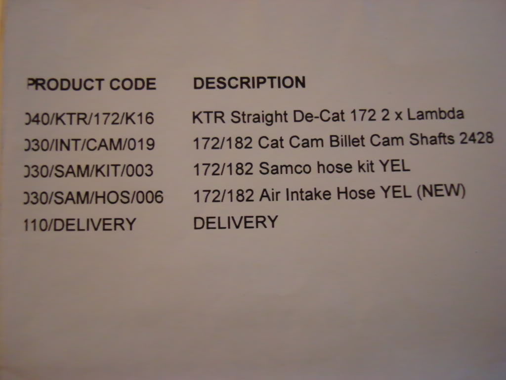

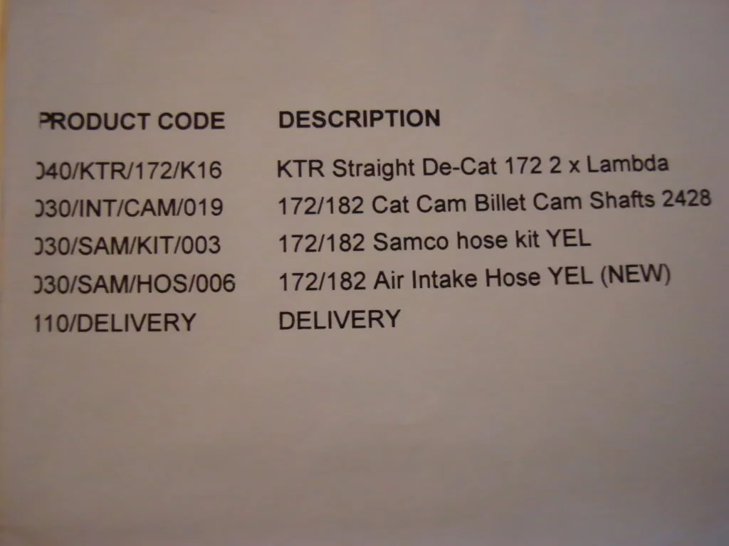

Im almost certain too that the vvt actuator should click. I'm almost certain as well that if these are 428s they should be timed up as per OEM.
Are they DEFINATELY 428s?
so a car going in with 250 bhp at the wheels...and coming out at 270 makes no diff to the actual flywheel figures??
i see. the map miraculously just gets rid of transmission losses.??
I think you are both making the same point.
As in the ratio won't change. for more power you will have more losses, but it will still be the same scale.
yes defo 428's , they only cost £498 back in 2007 as well , lol
