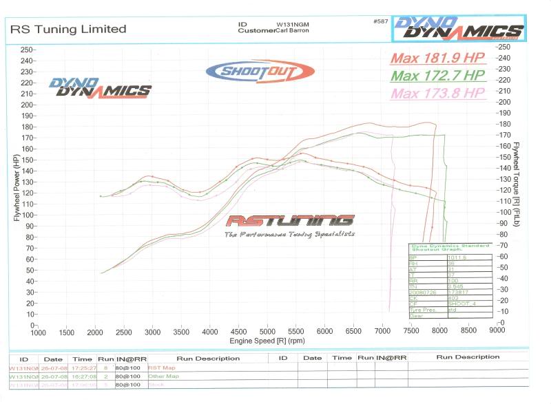

Go to RStuning you will see similar to ours (standard PH1 make like 160 there)
Go to somewhere like motorscope you might see +190
