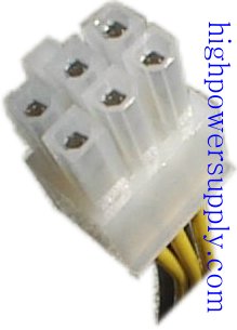

Has anbody got a pic of a 6 pin power cable running from the psu which powers the graphics card?
The reason i ask is that i have connected 2 standard power supplys to the graphics card addaptor that you would use for a hard disc/cd rom.
Is this the correct connectors or are there a special express power cable which a psu comes with?
yep, i've built my new system today and it has 2 x seperate 6 pin PCI-E power connections from the PSU going into it.
the graphics card has two of these on it :
and the cable connections look like this :
hope this helps.
i'd imagine your supposed to connect the molex (white connections) to your PSU and then the black 6 pin connector into the graphics card.
