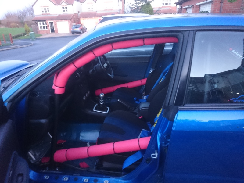

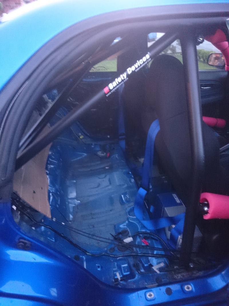

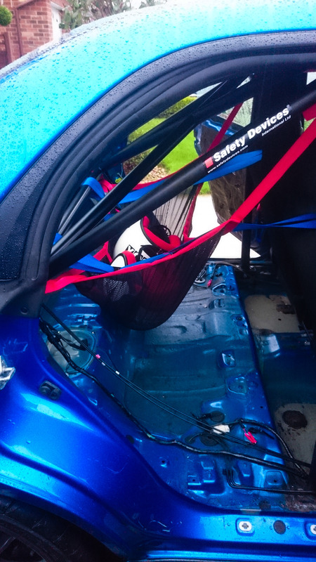

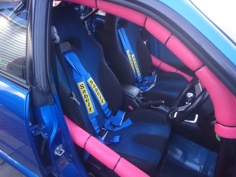

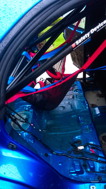

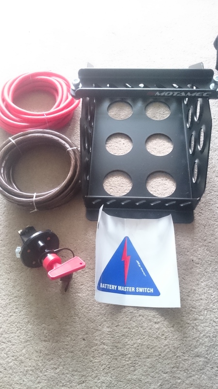

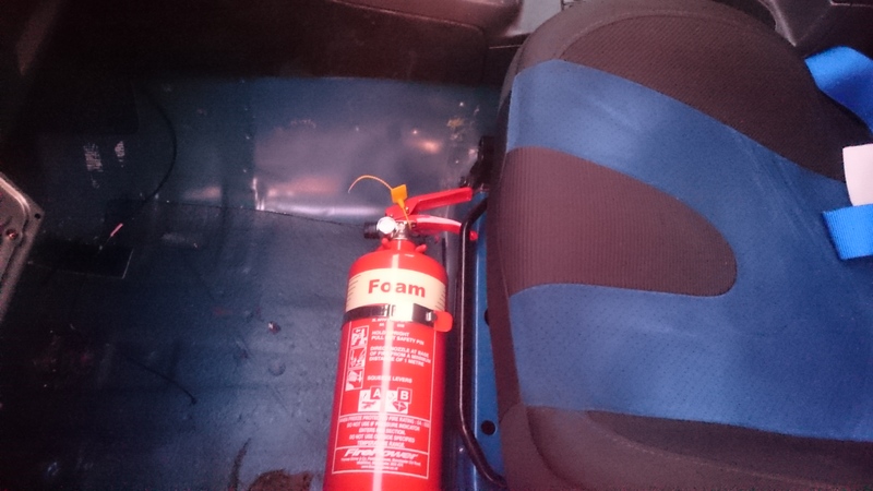

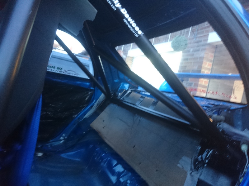

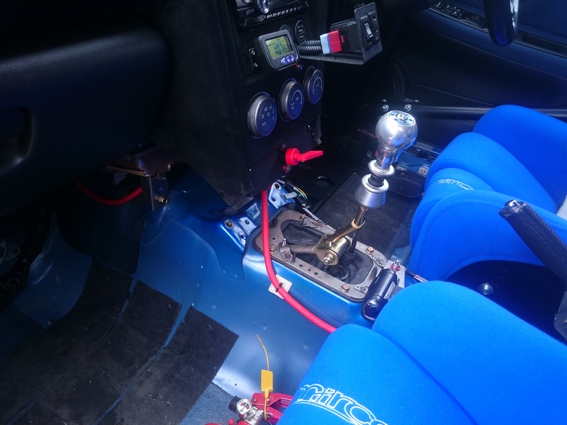

6 point safety devices rollcage modified for double diagonal and harness bars added
New 4 point sparco harnesses fitted with spreader plates
Larger fire extinguisher added
TRS helmet net
Changed horrible orange side stickers for blue/white versions
Hoping Santa brings some more goodies so there is just the power to increase and seats to replace when funds allow.

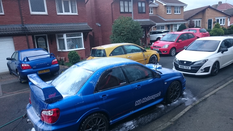

The R27 clio and Fiesta ST are the neighbours. Mine is the STI impreza, brother has the R26 Megane, parents have the Wrx and a mate has the Seat.
We had been out for a boost out and the cars were disgusting

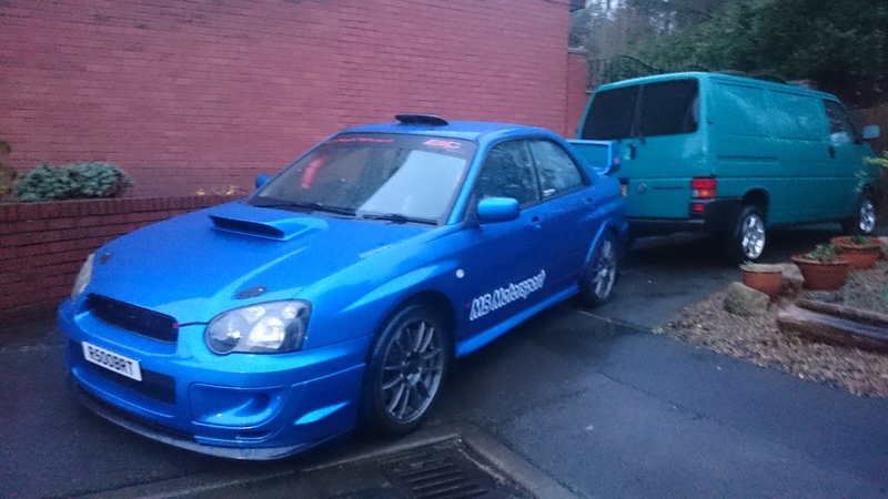

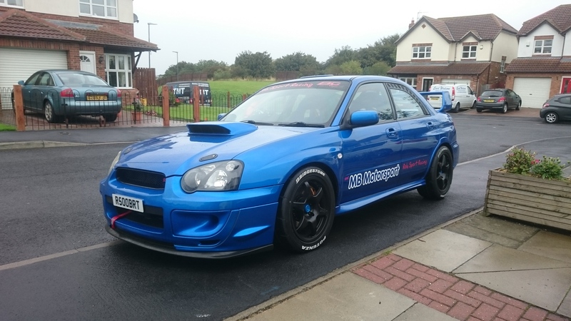

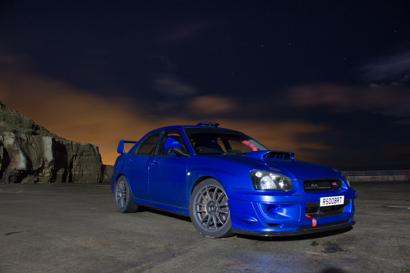

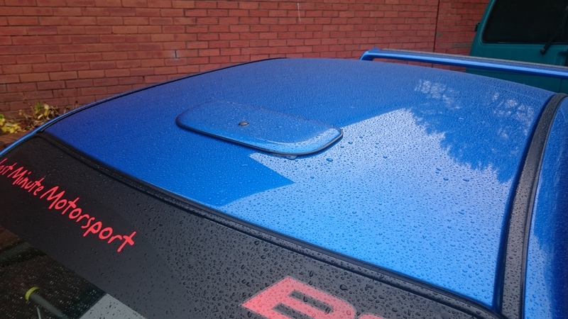

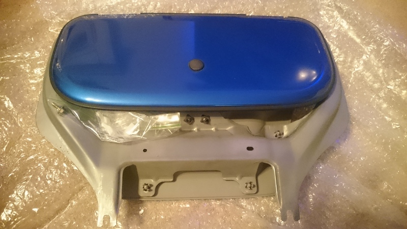

Well got even more done so am quite happy. Used the car everyday over the Festive break and never missed a beat.

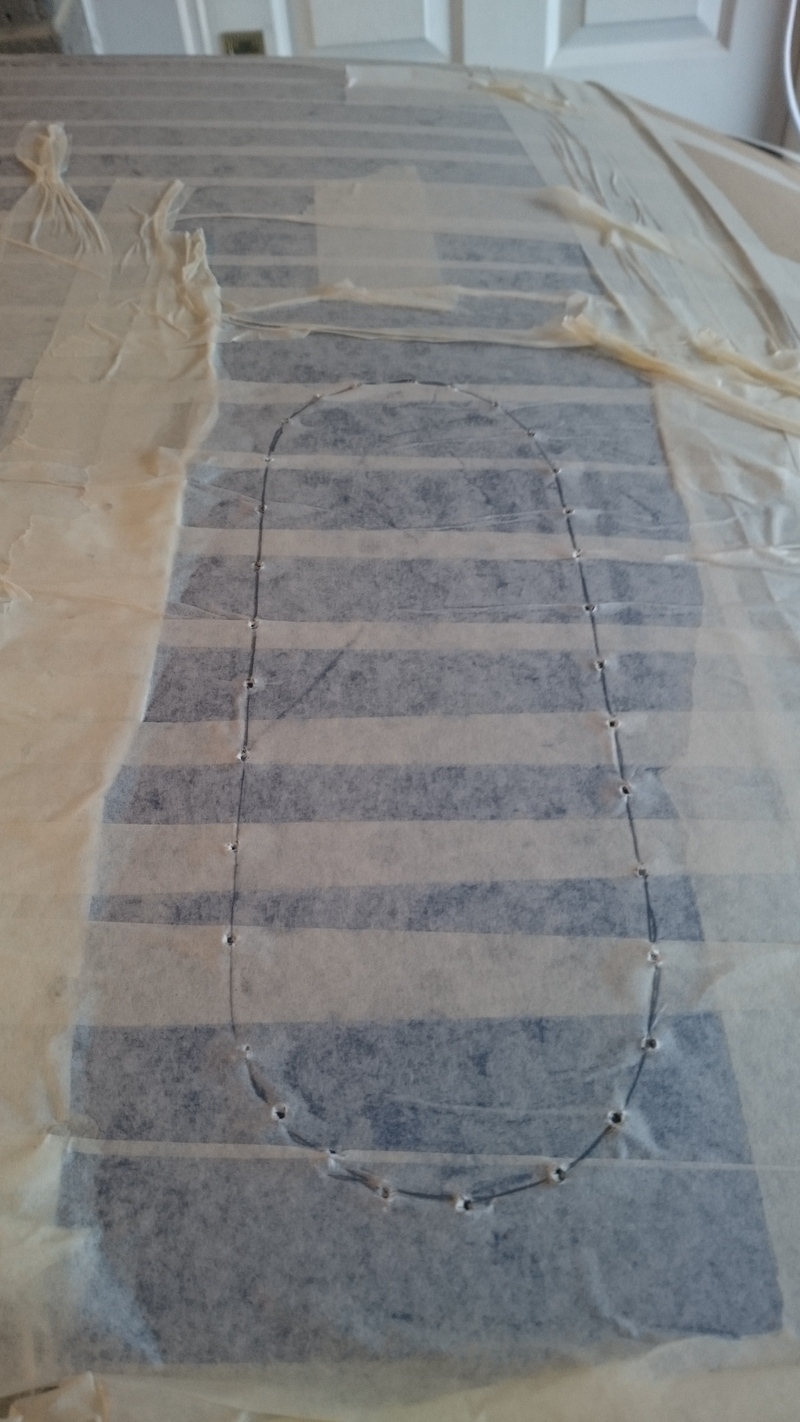

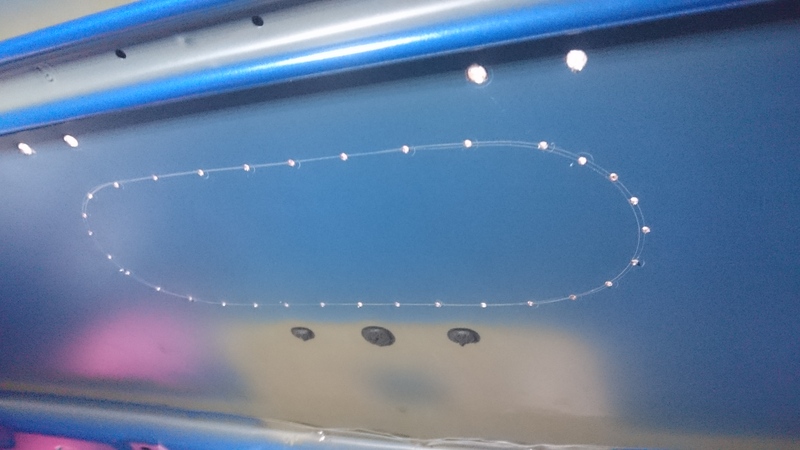

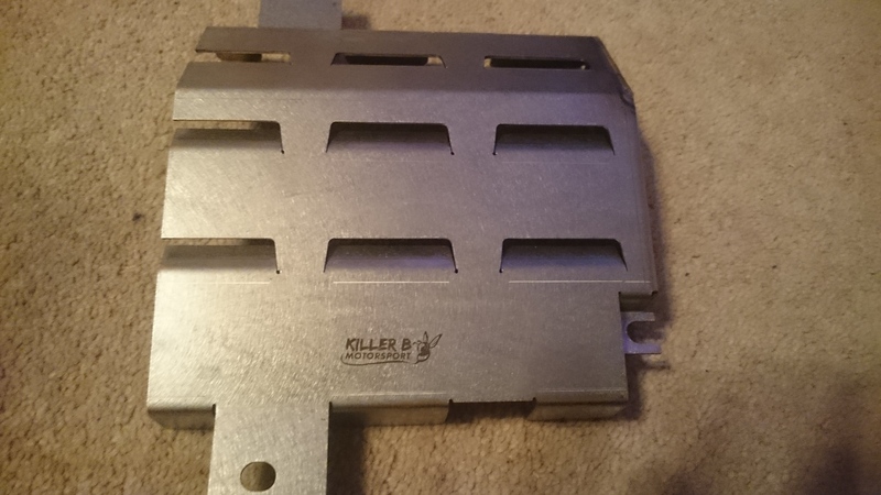

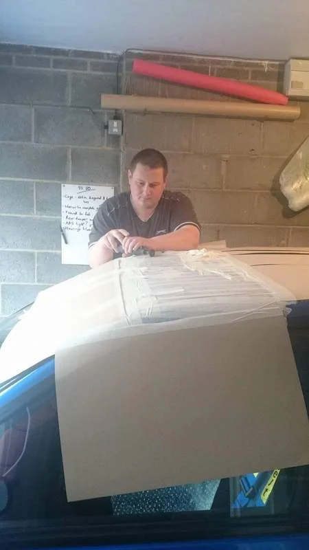

Santa (Girlfriend) brought me a genuine Spec C roof vent kit and Killer B windage tray for the sump:

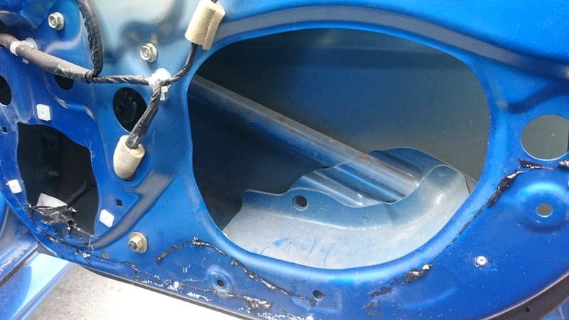

So on the morning of Boxing day I got the dremel out and cut the roof for the vent ;) the Girlfriend lent assistance even though she looked concerned haha
Vent works a treat and no leaks ;)
  A special one.
Great work bud, scary s**t cutting the roof.
The vents work really well, surprise how much air come through. I keep mine closed above 40 mph as my mate's one had the plastic clip break, the flap went back and dented the roof.

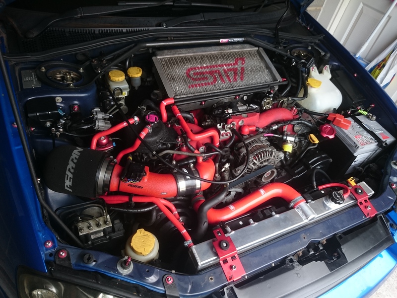

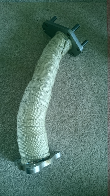

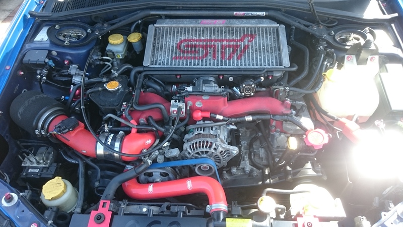

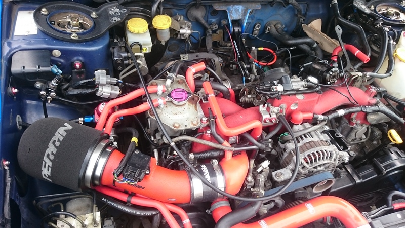

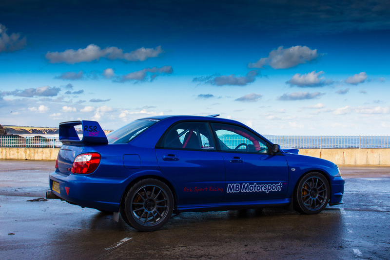

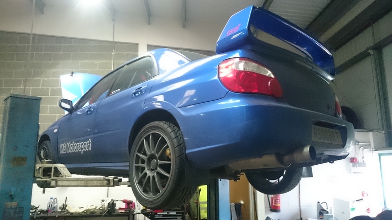

Well since Christmas a few things have been progressed......

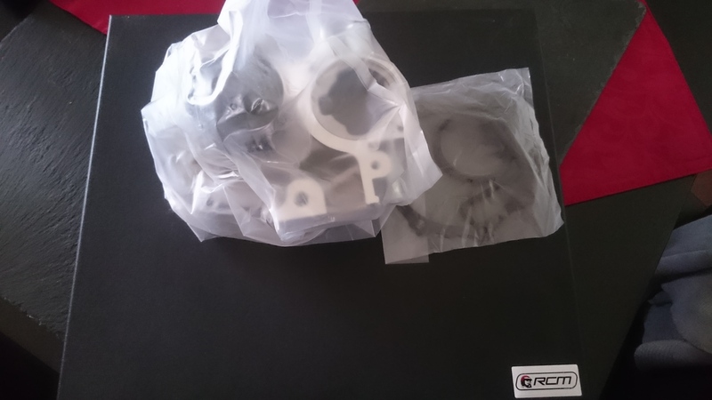

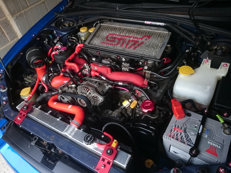

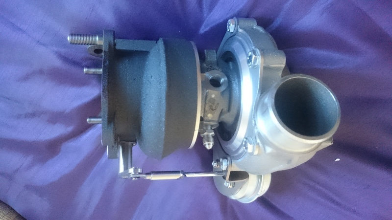

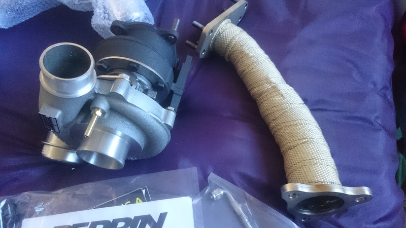

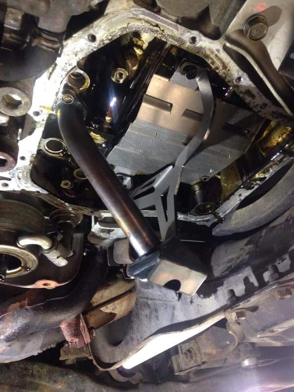

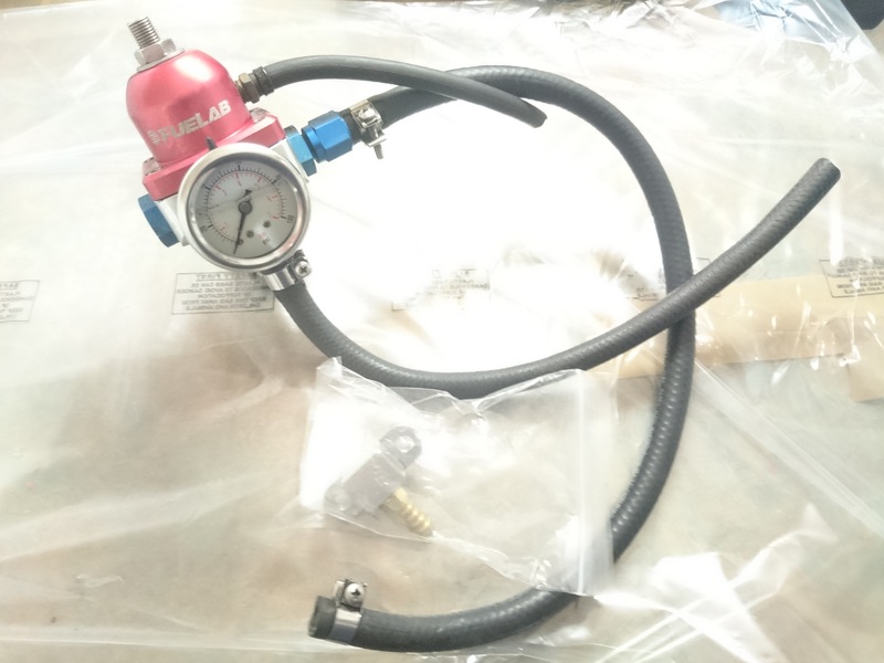

Car came back from MB Motorsport on last Monday with the following added:
- TD05-20G by Jonny Gav
- RCM headers
- RCM uppipe
- RCM 340 fuel pump
- Perrin turbo blanket
- DEI heatwrap
- Fuelabs FPR
- Killer B windage tray
- Killer B oil pickup
- Group N sump gasket
- HKS oil filter
- Fresh 10w60 Mobil motorsport oil
View attachment received_10153902796703486_zpsy7l2n5oe.jpe
View attachment received_10153902796653486_zpsl08on9hs.jpe
View attachment received_10153902796468486_zpsm1stxv8g.jpe
Car is now fuelled up and sat waiting to go in for the fuel injectors (820cc) then mapping this Friday so fitted up my new stickers:
Also got the citroen mist washers fitted and started working out the front tow point:

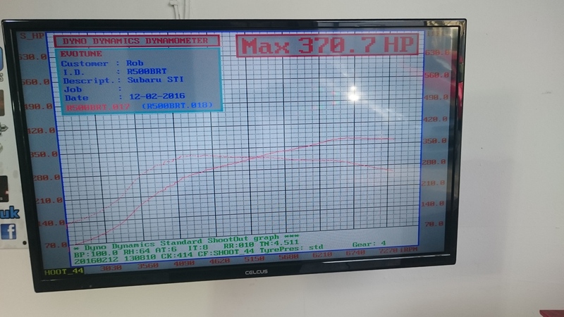

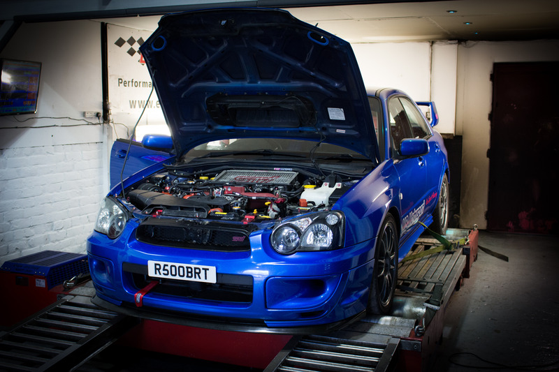

Then had the car mapped at Evotune last Friday and the map is superb. Made 371bhp and same torque so clutch is still perfect.
Didn't use the 800cc injectors in the end so will be selling them on now.
RSR Rob Sport Racing Impreza making 371bhp on rolling road - YouTube
Got a pair of bucket seats to sort then will be looking for a different turbo as the one fitted now isn't perfect but delivers what I wanted for the time being. Looking at a MD321, sc40 or sc42 then remap again.

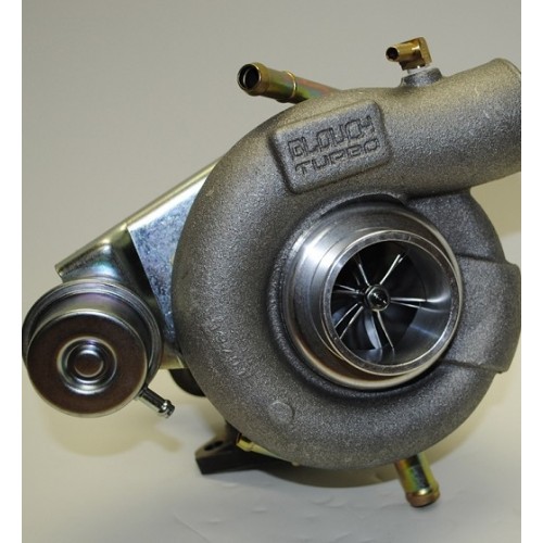

I wouldn't buy a turbo from SC mate.
I'm going to give Alyn @AS performance a call when I'm ready.
Cracking work mate, car looks great. [emoji41]
Cheers, the Blouch turbos that Scoobyclinic sell are absolutely superb. Wouldn't go back to Scoobyclinic now for work but will happily use the mail order service for stuff like this.

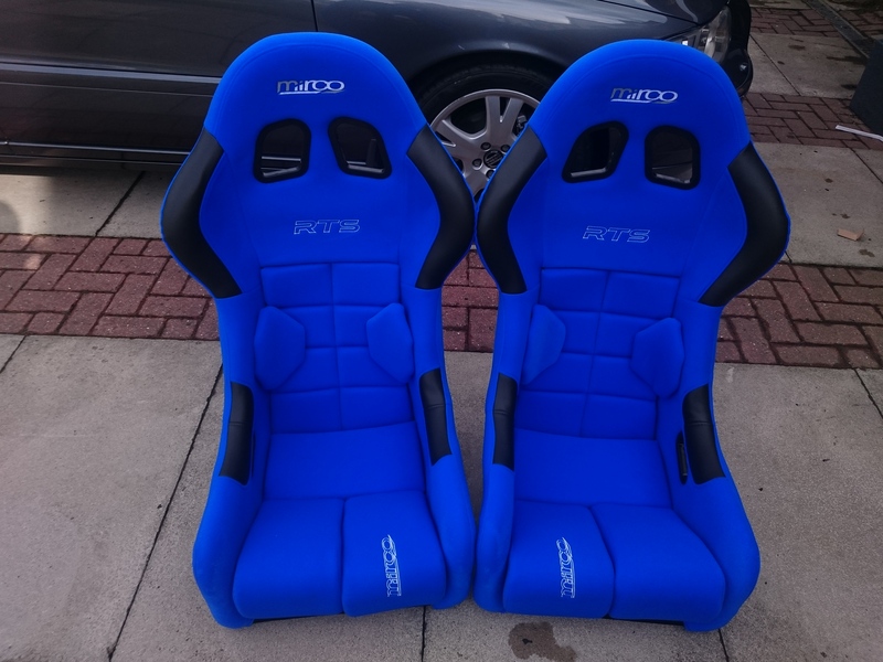

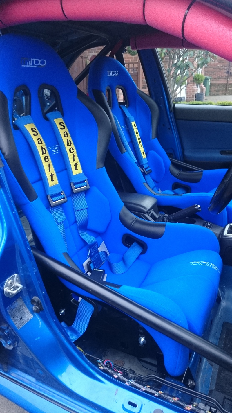

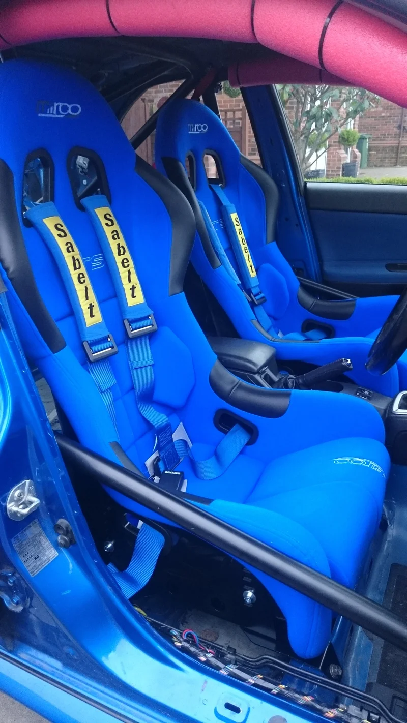

Seats are here and fully installed in fixed positions - love them!

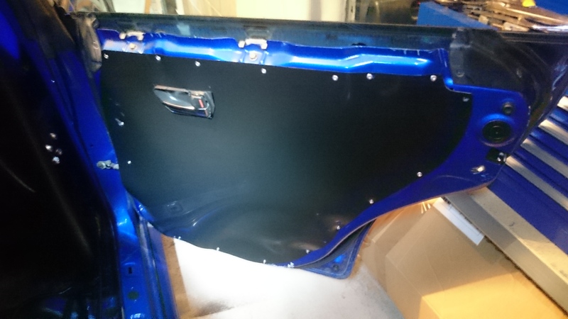

Also knocked up a pair of rear door cards as a temp measure - don't look to horrific haha

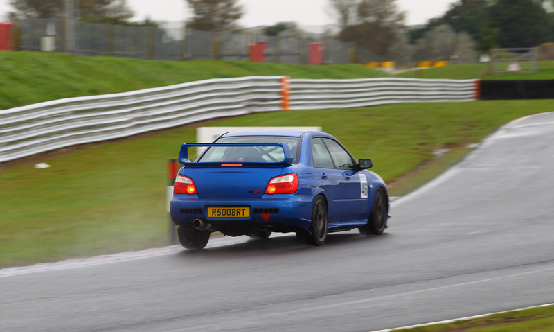

Well had my first race and got 5th in class and 29th out of 70.

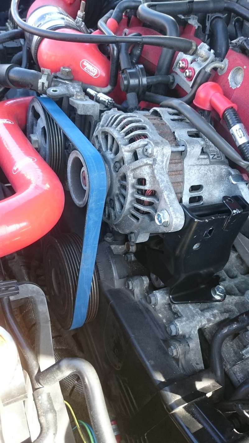

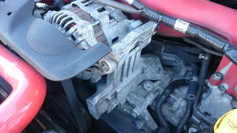

10kg more removed including undertray, rear door crash bars, alternator cover, various brackets. Still loads more to come off haha.
Also fitted the lighter non aircon alternator bracket and a new CDF racing aux belt.

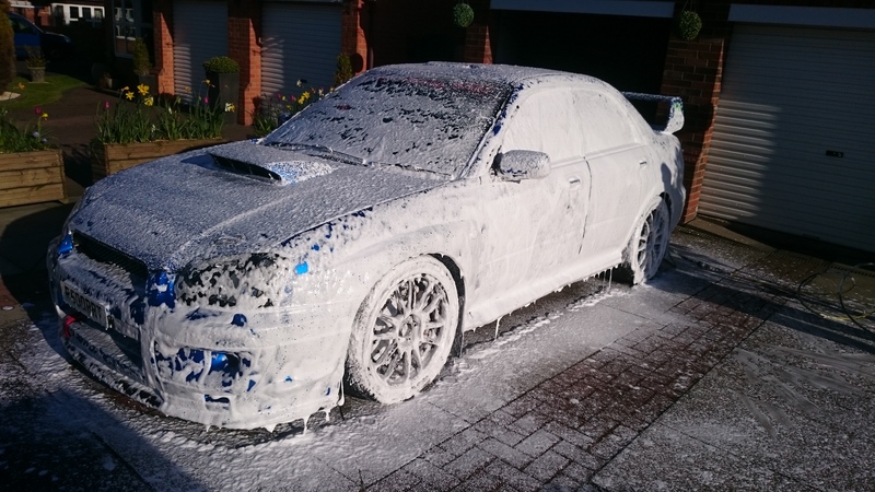

Had a nice drive out and about today then back home to test out my new snowfoam lance....

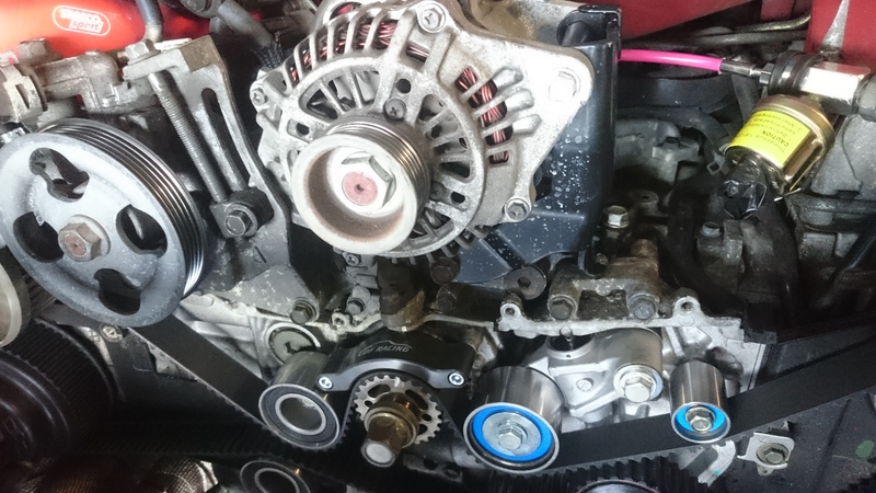

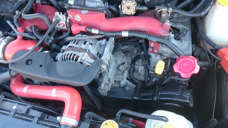

However the Impreza cried off haha - flat battery meant expense for the new one. Sorted this then expansion bottle cap blew off emptying coolant all over the engine bay, since then a slight squealing noise was present in the timing belt/water pump area.

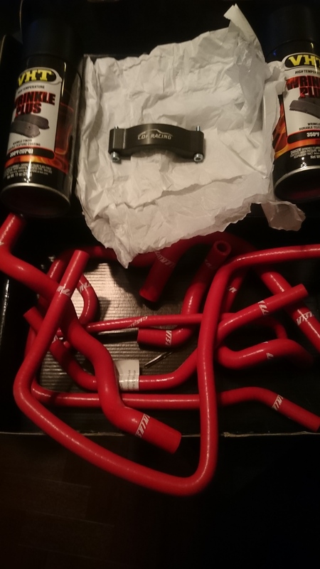

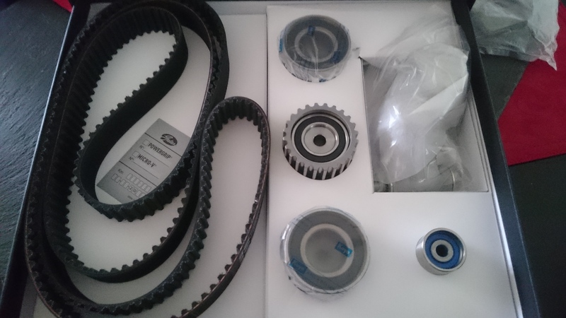

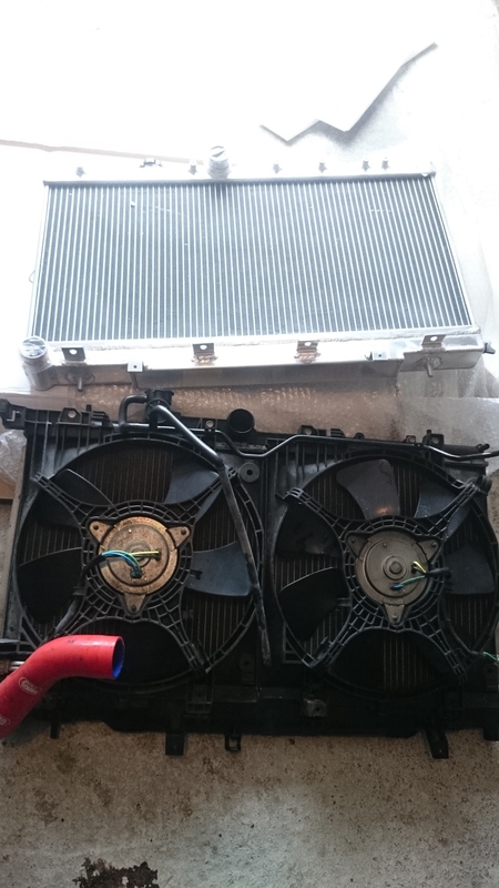

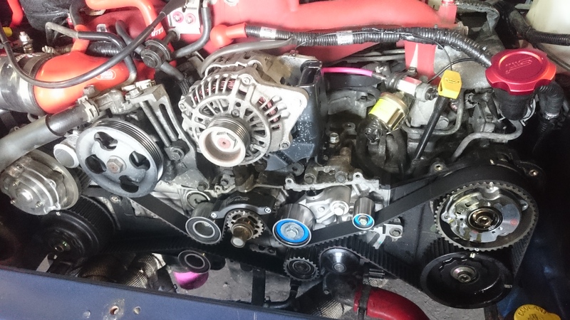

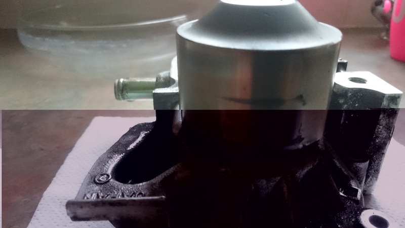

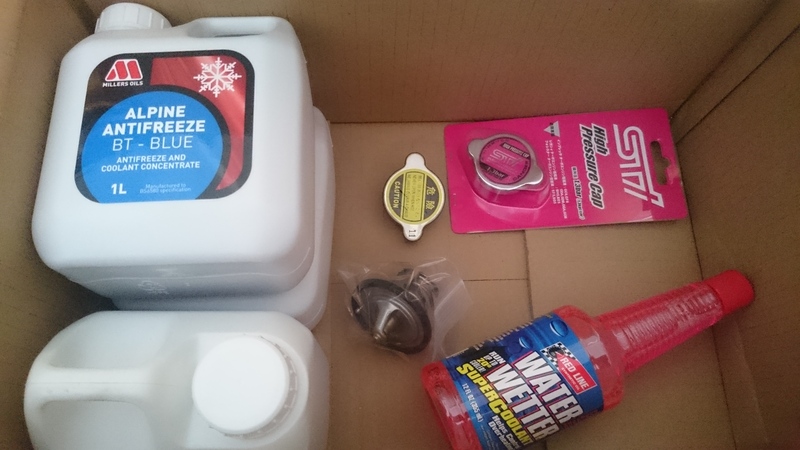

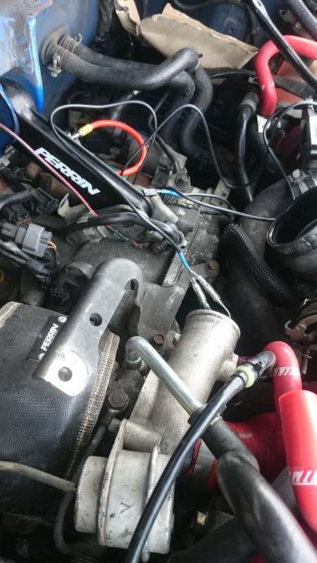

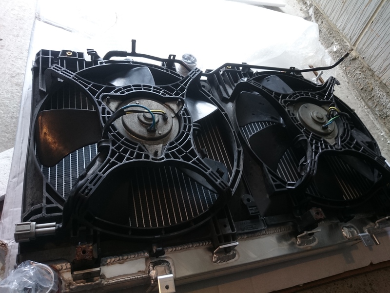

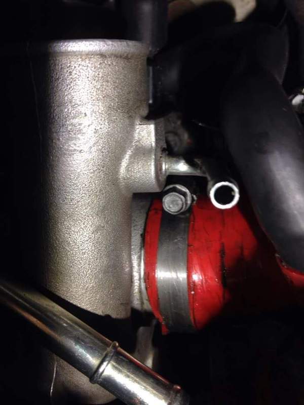

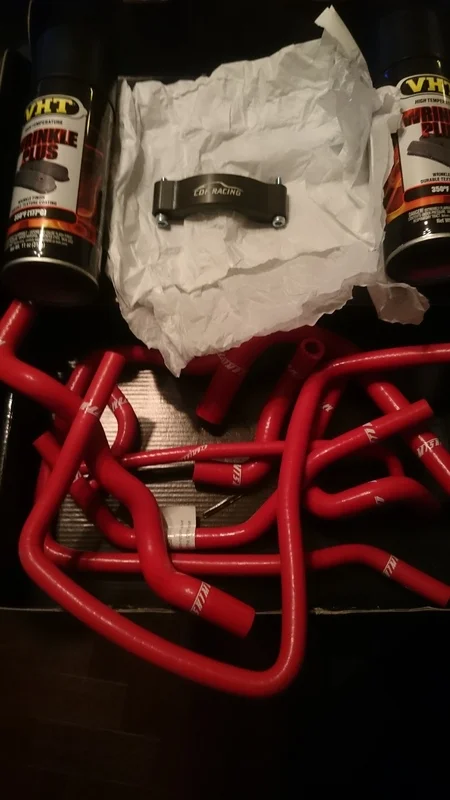

So after ruling out headgasket issues the following has been completed:
- Alloy radiator
- Mishimoto ancillary hose kit
- Forge header tank
- Expansion bottle from the fmic kit I have
- STi header tank cap
- Timing belt kit with Gates belt
- CDF Racing belt guide
- Water pump
- Thermostat
- Millers coolant
- Water Wetter

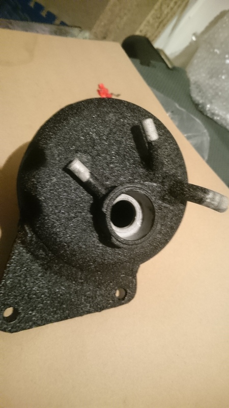

Also modified the radiator ready for fmic later in the year

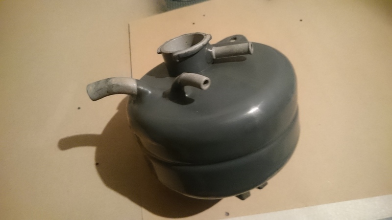

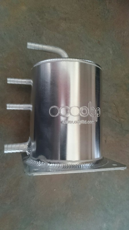

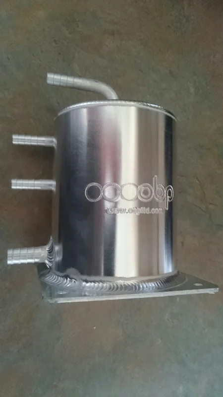

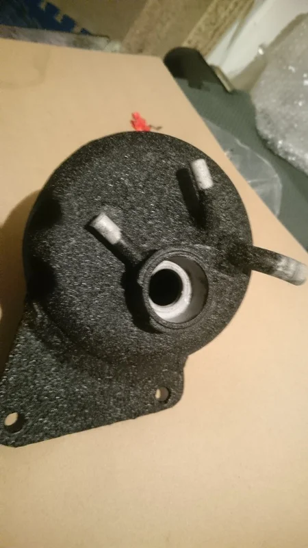

The header tank came grey but I didn't like it:

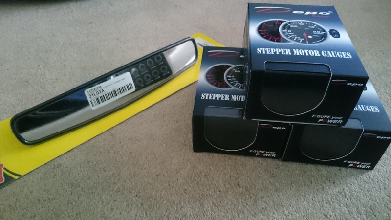

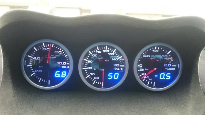

My partner, Lisa, got me some Depo 60mm gauges and my brother a 14" curved racing mirror for my birthday which I promptly fitted:
The water pump had been the cause of the rough running and issues - bearing was seizing up and locking completely causing idle to drop to 400rpm.
So had plenty boosting about and the car is now perfect!

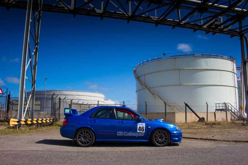

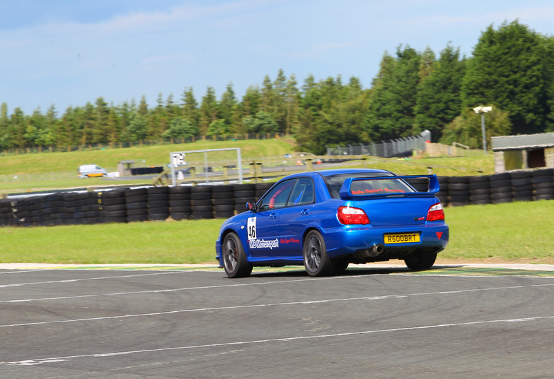

After having all the issues with the car sorted I managed to make my Croft race......
Finished third in class with 11th out of 67 overall which I was very happy with, the car is around 320-330bhp at a guess due to the turbo problems so I was around half the power of the Evo that came ahead 0.7 seconds of me so was exceptionally happy haha.
Wheel alignment still hasnt been touched in 18 months so shows the car still has even more potential.

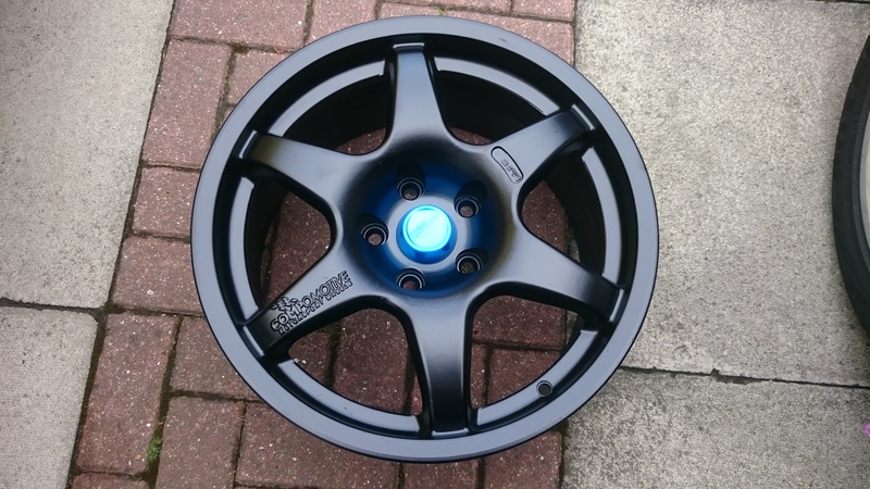

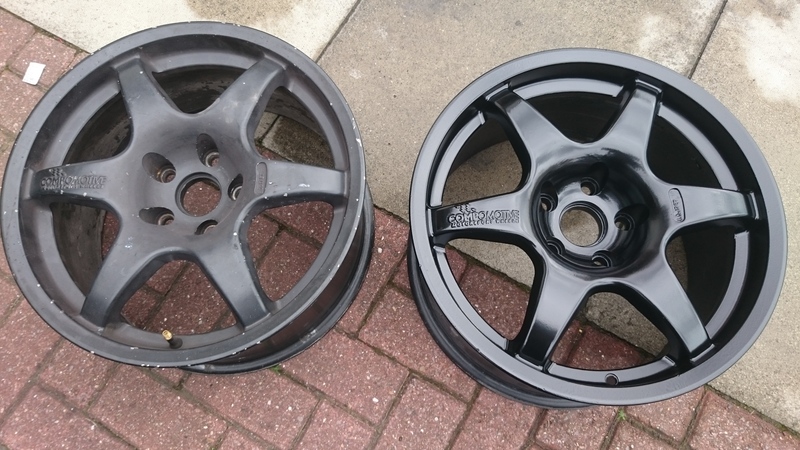

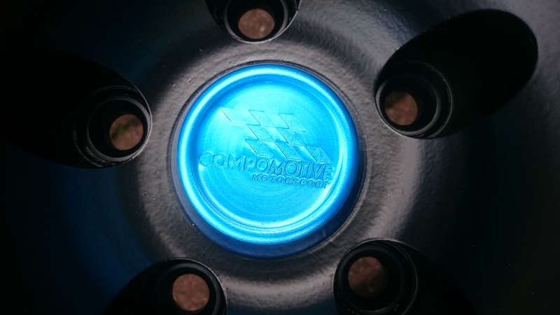

Got these M06 cheap so did a DIY refurb and got some new blue genuine alloy centre caps....... just keeping my eye out for some cheap track rubber.

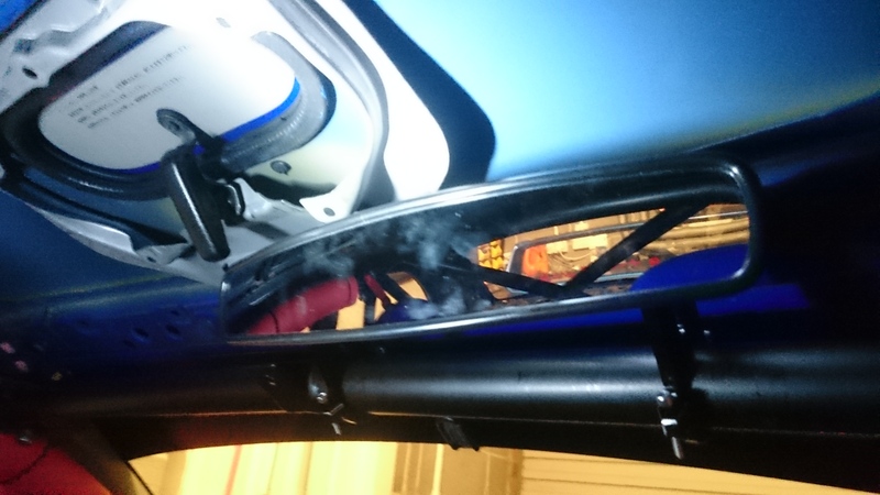

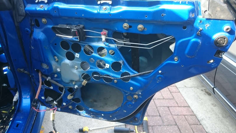

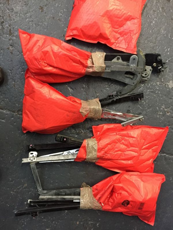

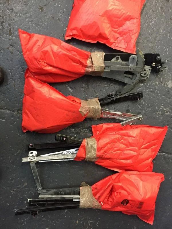

Spec C manual window conversion:
539_96cb_440c_aa45_f9c8f2ca346f_zpsk1dtidg7_ec811a3df708893dbf15a02fd0edbea14cbfd98c_zpstosby7gj.jpg

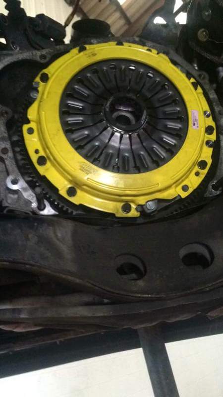

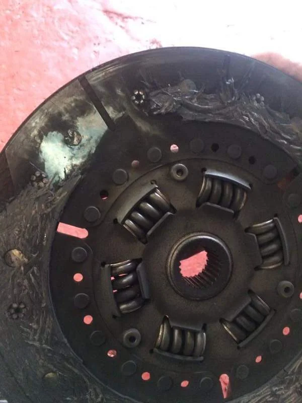

As well as these bits the Clutch has decided it doesn't like working so an ACT Extreme 6 puck is being sourced

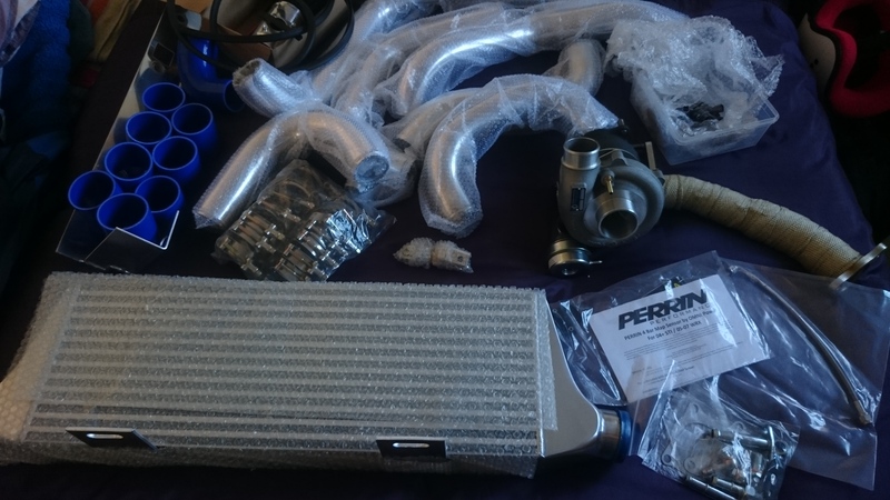

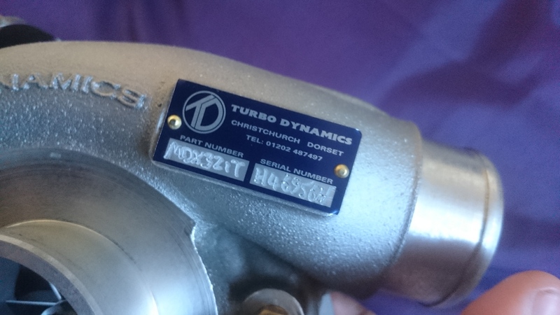

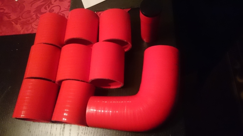

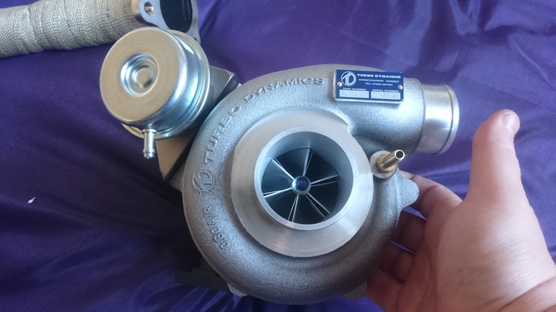

All the hardware is now here for the next power upgrade a well:
800cc Injectors
Billet MDX321T turbo with ceramic coated hotside
Trick uppipe
Japspeed FMIC
Red pipework for above & DV blank
Perrin 4 bar map sensor
This will all be going on over the winter before going to Evotune for mapping.

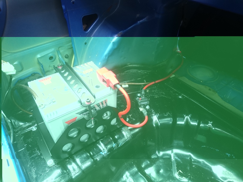

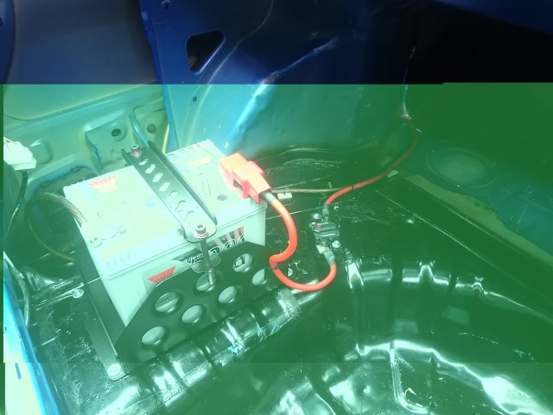

Battery is now in boot and converted the intercool sprayer into the screenwash bottle instead.
New clutch is in and much better - old Exedy was trying to kill itself after Croft haha

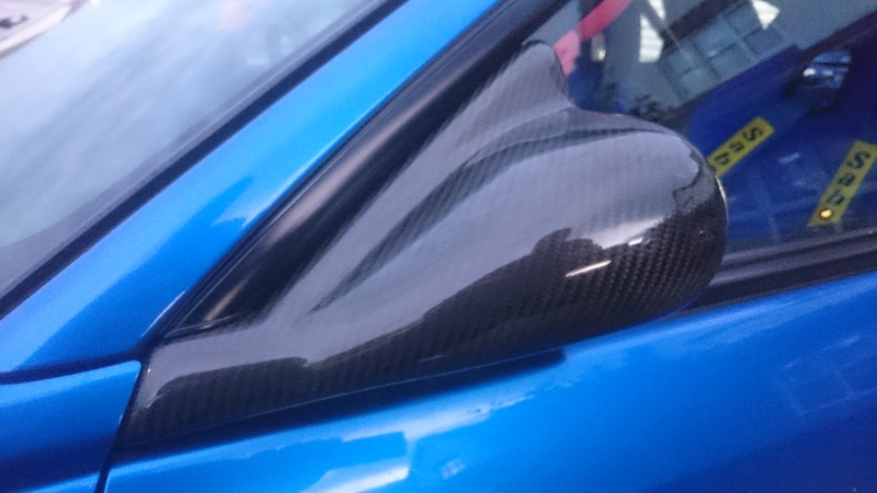

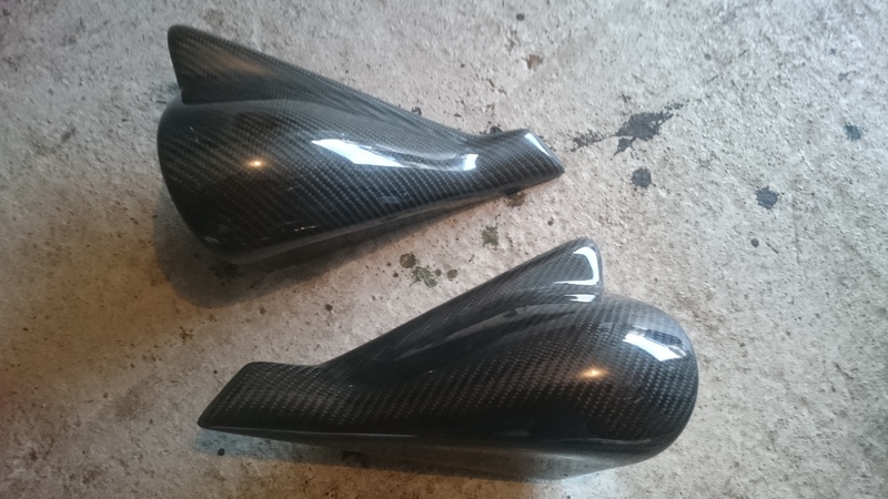

Lastly was carbon mirrors and some nice photos to get some practice in....

Cool up date bud, how comes you changed turbos from the SC to the TD unit?
I actually ordered the SC42 but after waiting a month nothing turned up from USA to Scoobyclinic let alone to me.
Got me concerned that if I did have any problems with the 42 it could take months to sort.
Got a 2 year warranty on the MDX321T and it's the upgraded Motorsport spec
  A special one.
So what kind of power are you hoping to make bud, what boost will it run?
I wanted a new turbo for mine but don't want to run a FMIC so im limted. Im going to buy a new VF34 and TD billet it, that ill do for me.
I was told that you should only run 1.5 bar on standard head studs anyway.
Aiming for 420-440bhp at 1.5-1.6bar. Don't want to push for more as it's still standard internals.
You not want a VF35 with billet wheel - response is superb then with scope for 380-390bhp
