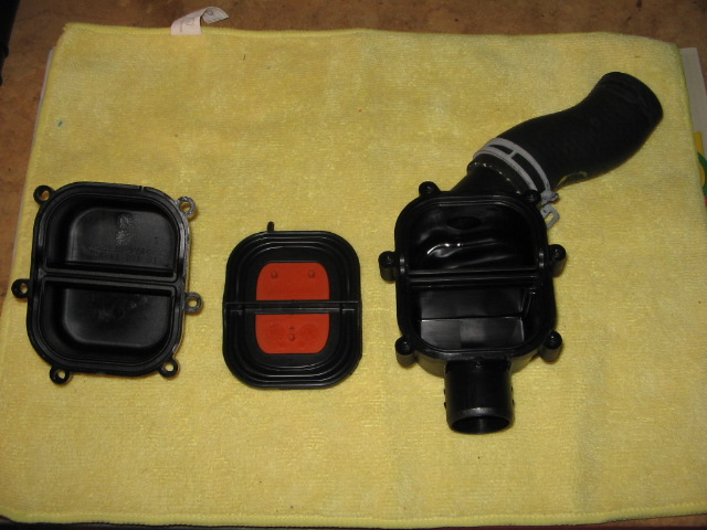

The sound symposer is little more than an enclosed plastic box with a plastic and rubber diaphragm sandwiched between two halves and some torx screws to secure it. It is fully enclosed on the intake side (and it resonates on the cabin side to generate the sound), but under boost it seems some can leak beyond the rubber seal of the diaphragm.
My symposer had stopped making noise, it has been like it for a while, but I though nothing of it as the car still felt the same. The recent Surry Rolling Road day showed I was a good 10bhp off where I should have been...and my boost clamps all needed a little pinch up...then I got thinking about the symposer.
I've heard that they're a weak point but no one has ever said exactly why or how they fail. I bought the Mountune delete kit as I though seeing as mine was making no noise at all something must be wrong with it.
As it turns out I was right.

Yes, well, sort of...
Imagine a box which is divided into two halves with the wall separating them being a rubber membrane.
One half of the box is connected by a pipe to the intlet tract right next to the throttle body, the other half connects to another pipe that routes into the passenger footwell.
Energy pulses back from the throttle body make the membrane vibrate causing sound to go from the other non pressurised side of the box into the cabin.
So, in theory at least, it is actual induction noise...

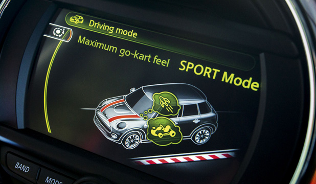

Am I reading that graphic right...goes/sounds like a rocket?
Is it a sound symposer like the Fiesta or artificial through the speakers?
I'm going to clean up and re-attach mine this weekend, see if I can bring it back to life and making noise again as I miss the sound.
God only knows, i just lol at the "maximum go-kart feel".
Probably speaker based knowing BMW these days, the R56 has a "noise pipe" like the ST iirc.
