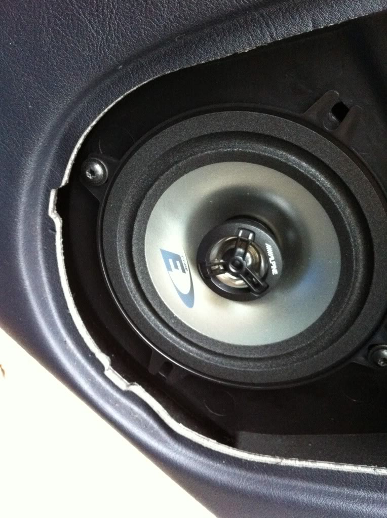

i have fitted alpines, direct fit and much better, only 40 quid i think too...
  182 Trophy #196
They look good. With the risk of sounding like a r****d.. What did you have to do with the wiring?
  Mazda 3 MPS Mk1
just cut off the renault block, fit speaker spade terminals so they slot on to the speaker terminals, literally a 2 min job, just get a crimping set from halfords for about a tenner and you get the terminals you need to crimp on to the speakers included
