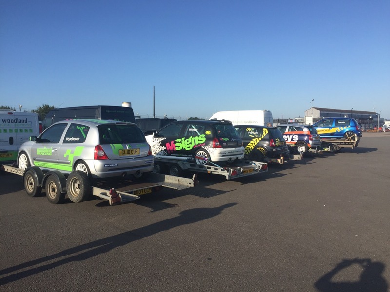

Another 2 top tips:
1. Automatics tow best - much smoother, and low-speed manoeuvring is greatly enhanced.
2. If using a 4WD (theres a Range Rover in your picture), use Low Ratio for very low speed/accurate reversing manoeuvring, also when towing away from wet grass/dirt.
