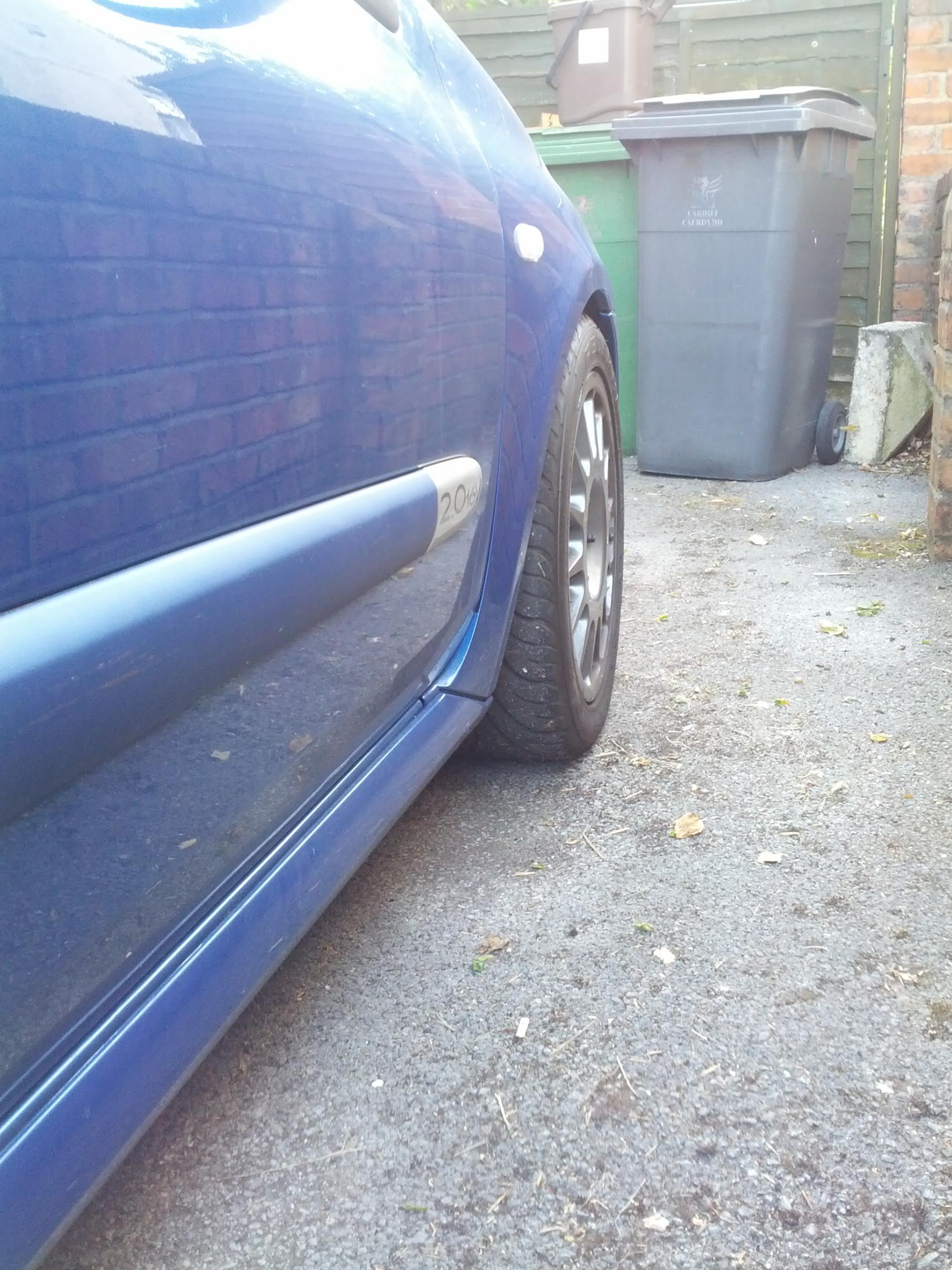

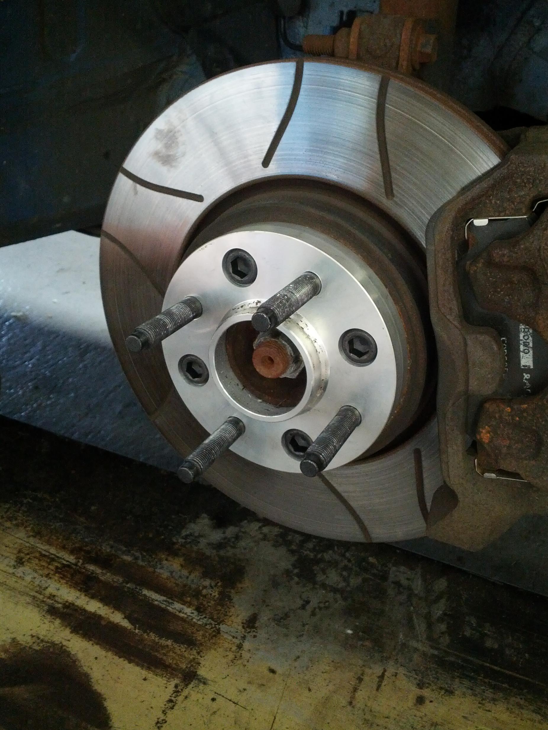

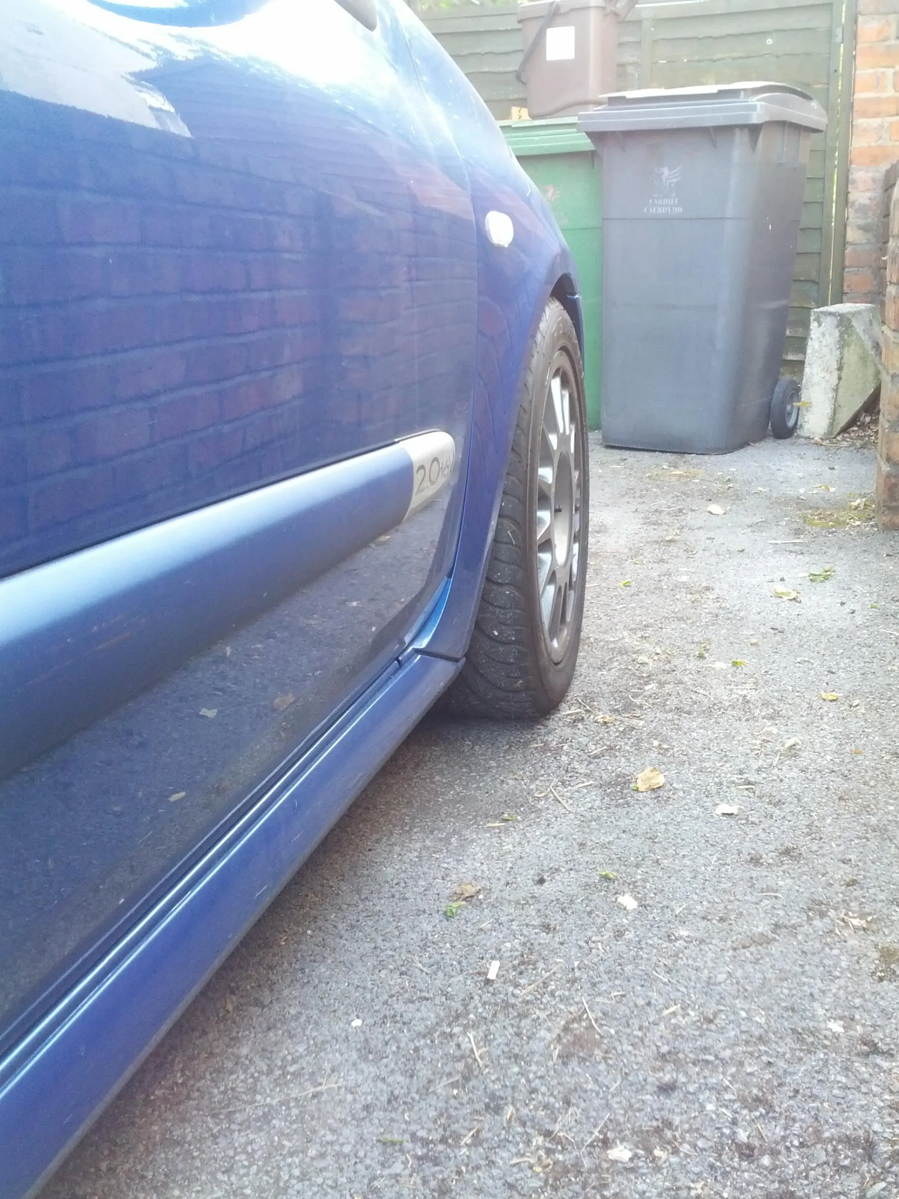

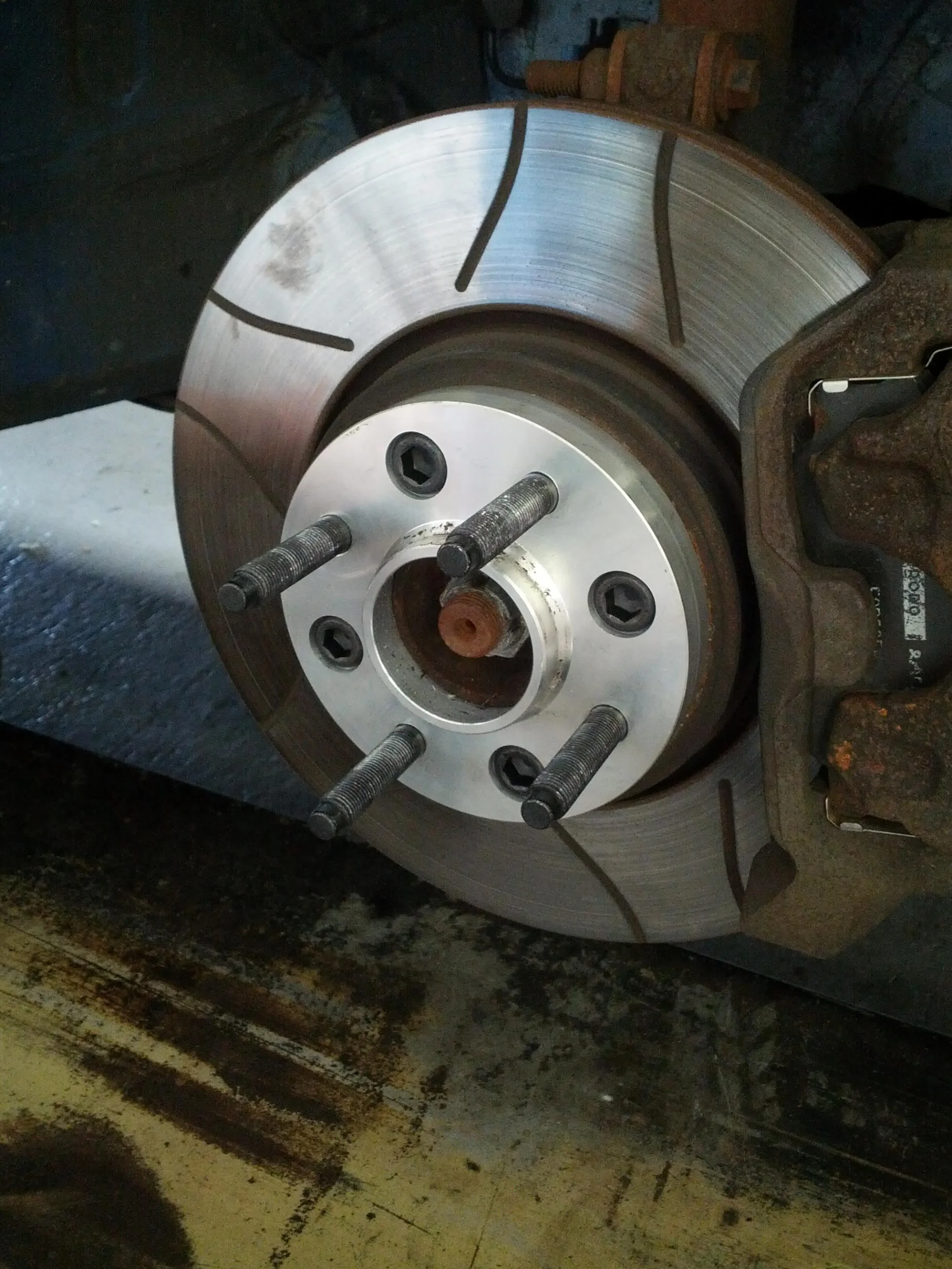

Hi All - fitted spacers all round today, I was quite conservative... went for 20mm hubcentric up-front with 15mm hub/stubaxel spacers at the rear.

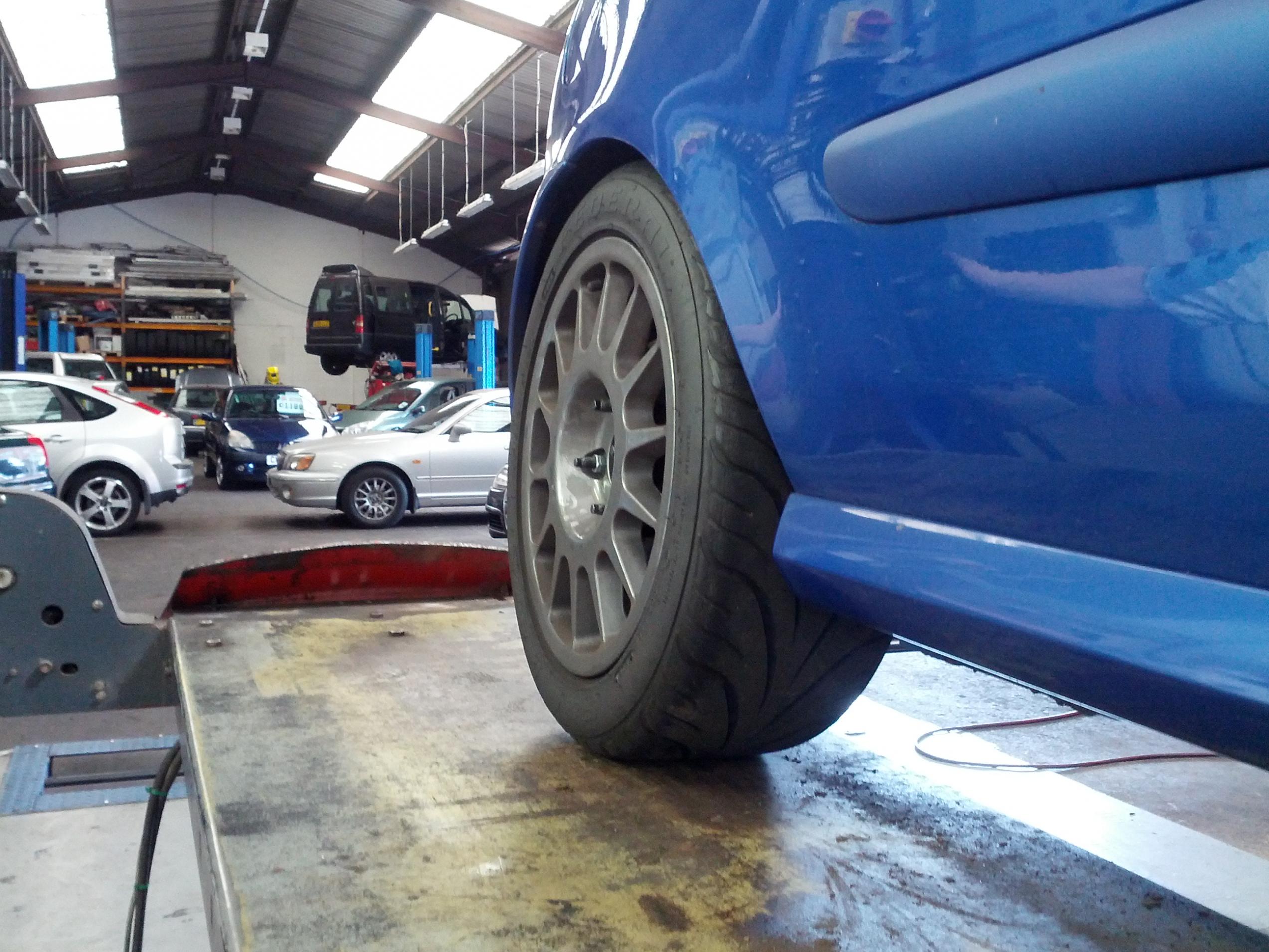

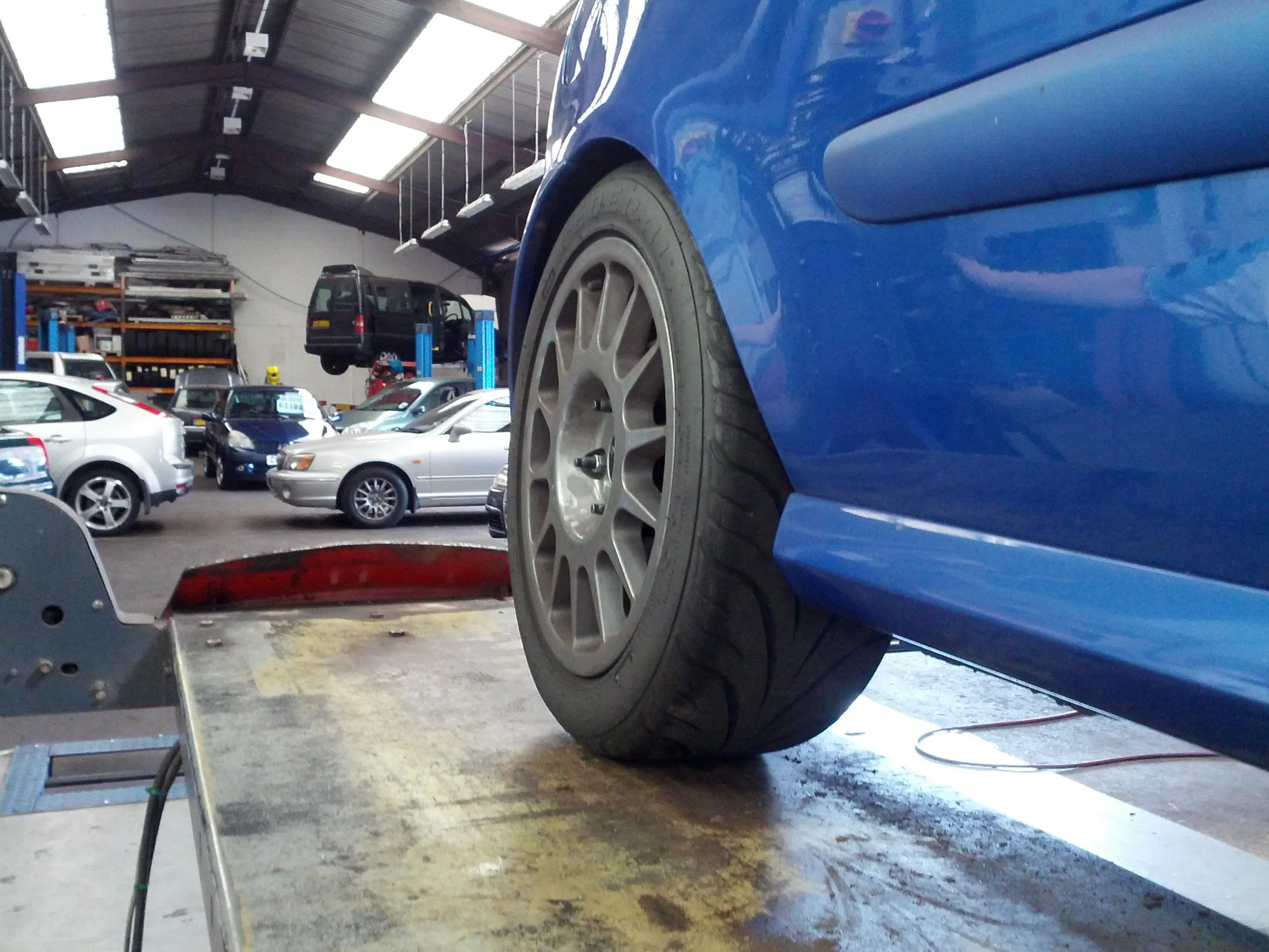

The car is a 172 Cup on ET43 2118's, the backs are perfect but up front it rubs a LOT! Perhaps I need to raise the car or add more camber or just stiffen up the coilovers considerably... I'm currently running -1.5 camber up front. This car will eventually be for track-only so more camber is not a concern.
What do you think? Cheers.
If you have arch liners its behind the bit that has most likely been rubbing/rubbed away at the bumper wing joint. You could try raising a little first though if you don't mind going higher.
