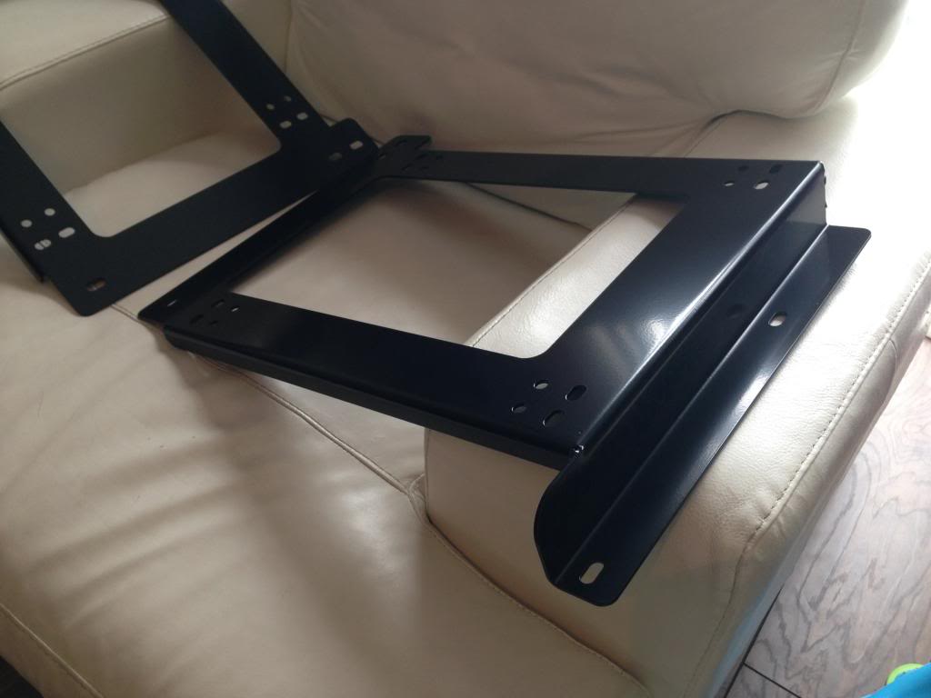

I've got some brand new subframes for 172/182 that would bolt straight to your floorpan allowing you to bolt aftermarket seats in
They are £80/pair collected

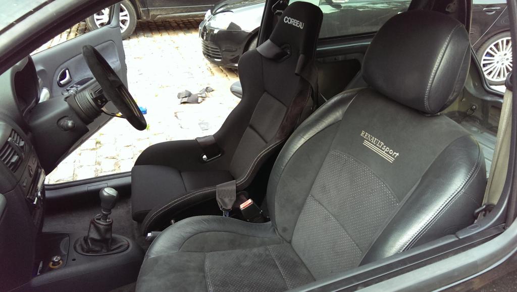

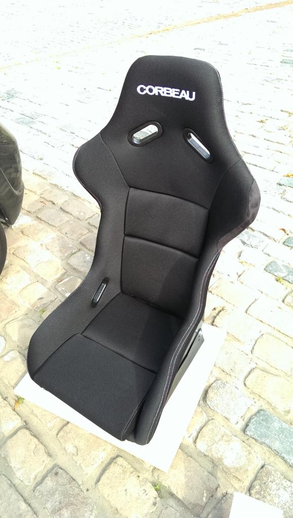

I have just fitted one to my 182! I needed a OMP Subframe and that was it..
Amazing seat, really has transformed the car.. Here is a few photos
Really was easy to fit, I can get more photos of the subframe fitment if anyone wants.. but it is very self explanatory
What at modification did you have to make to the omp subframe to make it sit level? And does the seat slide forward enough to allow limited acess to the back ?
More pics would be great if it's not too much trouble!

Hi mate, it was just the case of moving the original spacers around and getting it perfect.
I took the rails off the sidemounts so that it sits lower. So there isn't any adjustment!

I see! Any chance of some more pics of then fitted as I'm trying to find pictures of them to gauge size and fitment !
How much lower are they than standard without the rails?
What size did you order ? And how do they fit ? Waist size wise?

I will get some photos after work!
They sit a lot lower, but not ridiculously low.
I ordered the normal slim seat and it is very slim.. tight on waist and I'm not big at all. Many of my friends have no chance on fitting in them lol

Just fitted mine with OMP subframes.
Removed the sliders, however had to space up the centre side as the subframe sits off level, can't understand why it would be made like this!

I run them in mine, i fitted them onto OMP sub frame's and have the regular size (upto 34" waste) . Cant fault them tbh. If you order the luke harnesses with them i'm sure there's a discount.

The subframes will only sit wonky if you remove the standard spacers below the carpet. Otherwise they will sit on them perfectly straight. I run both driver and passenger seat without sliders, Got both sides to a position I am happy with! Took about 5 minutes to unbolt and bolt into the right position for me.
Nope I oRiginally had the old spacers in place and was the same, still not level. You must of been lucky or never used a spirit level as most others have this issue. They don't look too bad until you out the spirit on.
