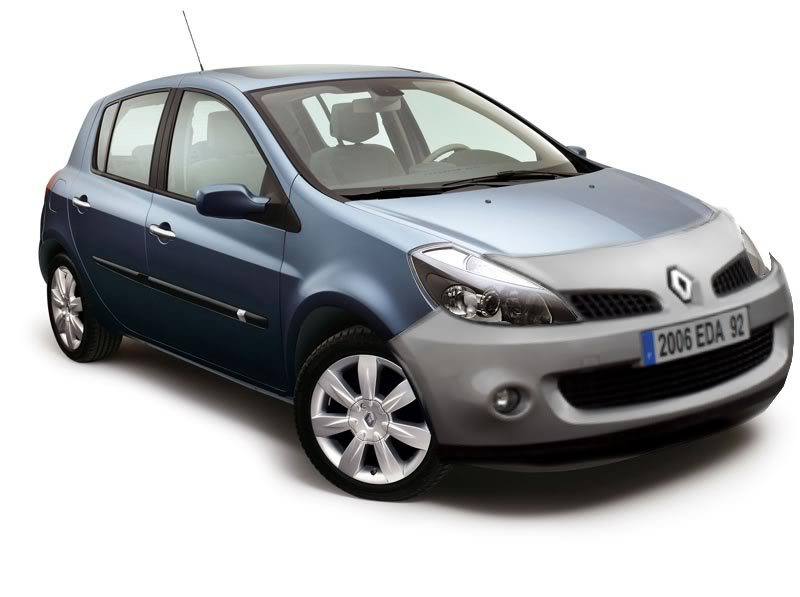

Quick chop
Looks like it'd need to be cut to bend round the lights and join the corners up... I matched the bonnet, lines on the wings and lights up from two pics.
Not sure how flexible it would be but it doesn't look like an easy fit
