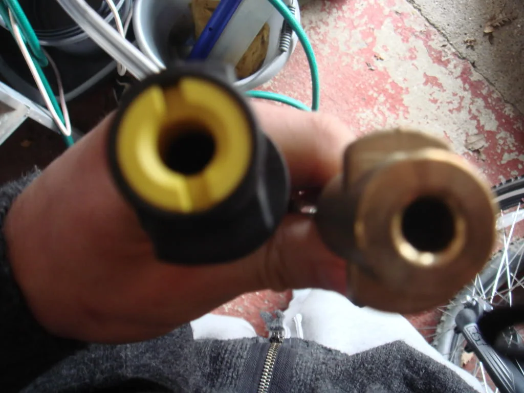

Ok I know there are meant to be issues with the fitting of these to Karchers, but it just doen't seem the same shape/size as the existing one and if they think I am going to spend hours f**king around drilling/ sanding/ using papier-mache to solve it then Autobrite can go suck lemons.
A shot of the Karcher lance compared to the Autobrite one (sorry about the poor focus). The Karcher one has the two indented bits on the yellow ring bit you can see, the AB one doesn't...
Matt (who I ordered from, not who made it!) kindly send me some instructions for if it is tight but I'm not going to start drilling and grinding myself to get this fixed, it just plain doesn't seem to work.
Any suggestions? This is really f**king me off!
Just tried again and still doesn't work...severely pissed off right now and thinking should have saved the money, feel like I am going to break the Karcher gun or foam lance trying to fit it :mad:

Have you actually tried fitting it or are you just judging from the fact that the ends don't look the same?
Yeah mate have been waiting for ages to get one and wanted to do my mums car for her with it as a late mothers day present. I tried connecting it, it goes in but you need to rotate it once its in (assuming its fitted the same as the original Karcher lance it comes with) and it just doesn't rotate. I have tried some WD40 to try and reduce the friction but still no look. I don't want to force it because I am scared of breaking either the gun or the lance. The sheet Matt supplied me with recommends opening the gun and sanding part of it down but a. I don't have the right tool to remove the screws and b. For a piece of metal piping and some plastic it is bloody expensive and I don't see why I should have to do this.

cant see properly on that pic. Whats the yellow bit?

Its in my car, i'll go get it and get you a pic in a min, might be able to see the difference.
Cool cheers Revels, just tried again and no luck. Looks very similar to the Karcher fitting but must be slightly larger as its not working. How long does sanding down metal take?!?

Yeh no twisting...scared of snapping it by forcing it and don't want to sand in case the standard Karcher fittings don't work...yeah I do want it to work thats why I am getting so annoyed with it! Suggestions?

I tried that though. When you say the lance twists do you mean twists in the Karcher gun or the top bit of the lance (it seems to twist around a bit? Not sure if its meant to?)
Its not an AB lance, we just use the same supplier.
In fact all of the Karcher foam lances available (both std and HD) use the same brass connector, which I understand the manufacturers are now looking into.

Just spoke to Matt at i4detailing and he has a possible cunning solution...which will HOPEFULLY work. If it does then could mean this problem is solved once and for all, just a shame the manufacturers of the connection don't do it themselves!

Update: After speaking to Matt on the phone (bloody nice guy) a tin of WD40 and enough muscle to make Popeye jealous, managed to get the lance on and decided to have a practice on the mum's Golf. WOW. Literally so much spunk started coming out I cracked up and had to get my mum to show her that the black Golf was now white...I stopped laughing when I realised I had sprayed our neighbours windows and our garage! :S
Anyway, brilliant little device once you get it working. I think it is expensive for what it is made of but it is really good.
10/10 to Matt and i4detailing though too, package arrived quickly and he is even fabricating a slightly different adaptor which should fit easier. Thumbs up!

Sure mate...I sprayed some WD40 onto the lance connector and some more into the Karcher gun bit...then put the lance into the gun, then whilst holding the butt of the gun into your chest firmly but slowly push it RIGHT down into the gun, then when its as far as it will go slowly rotate it right. TBH my lance seemed slightly mis-aligned (probably my fault trying to push it in!) so when it was in the bottle wasn't hanging straight down but I just didn't twist is 100% but still stays firmly in.
