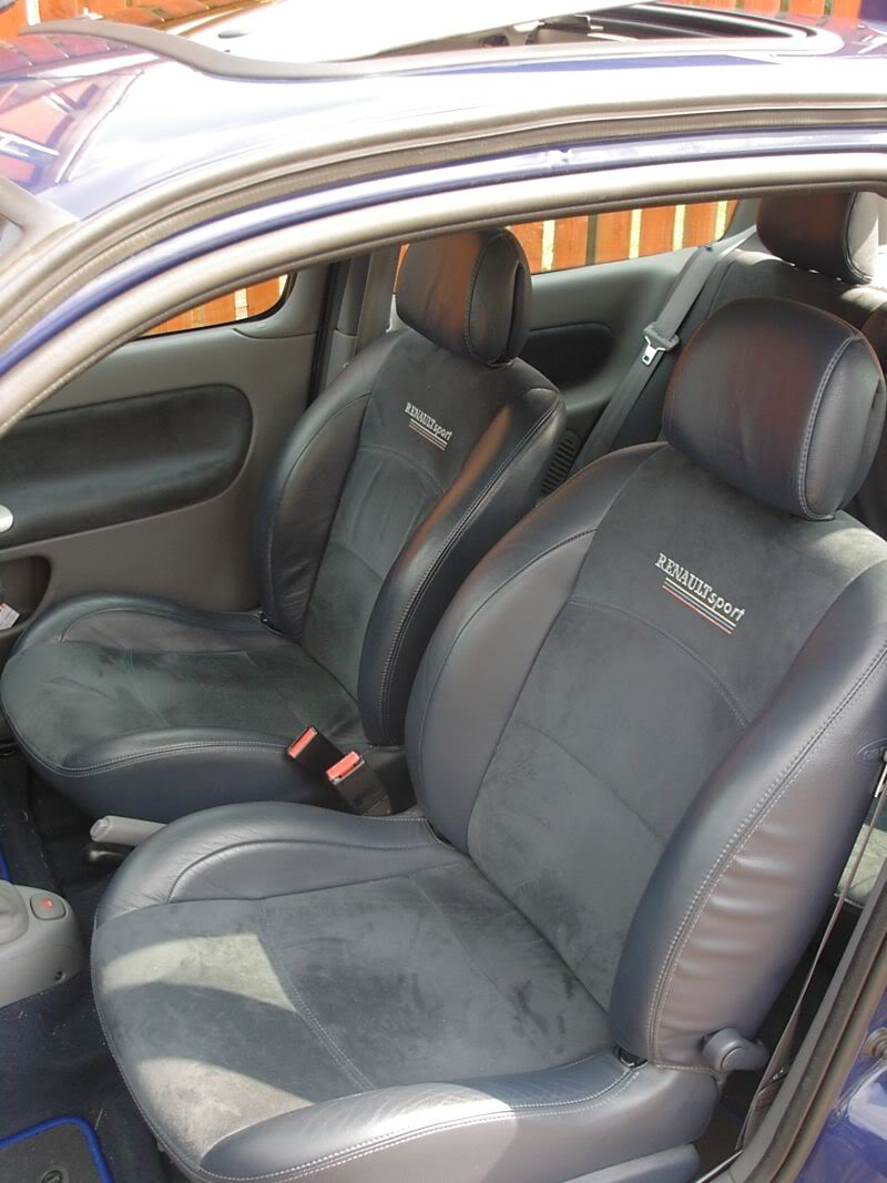

My girlfriend has just bought a 1.2 16v MK2 PH2 (2002) for her first car and the interior was the only thing letting it down, I found someone selling a good condition Cliosport MK2 PH1 Interior, I have bought it and went to fit it but the wiring is different from her orginal seats, her orignal seats also have airbag same as these.
Same as these
is it possible to wire theser into her car successfully without any issues? if so has anyone got a wiring diagram for the front seats?
help would be greatly appreciated :)

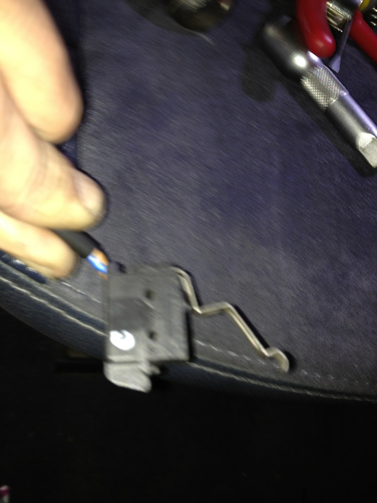

All fitted, just one thing when I removed the old seats this little switch came out and not sure what it is any ideas?
Its still connected but it's just loose under the seat any ideas what to do with it?
Just the new seats don't have one so not sure what to do with it :-/
does anyone have a picture where this actually goes tried looking today but couldnt find where its come from :(
