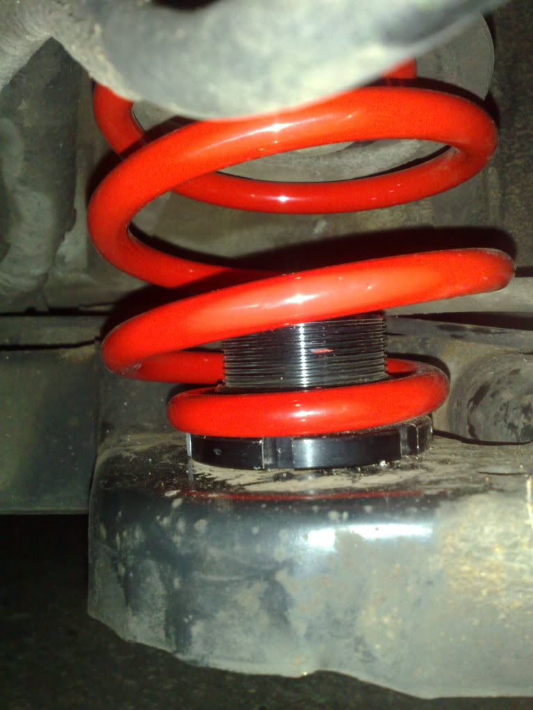

have i fitted the spring correctly? - i fitted with the adjuster at the top

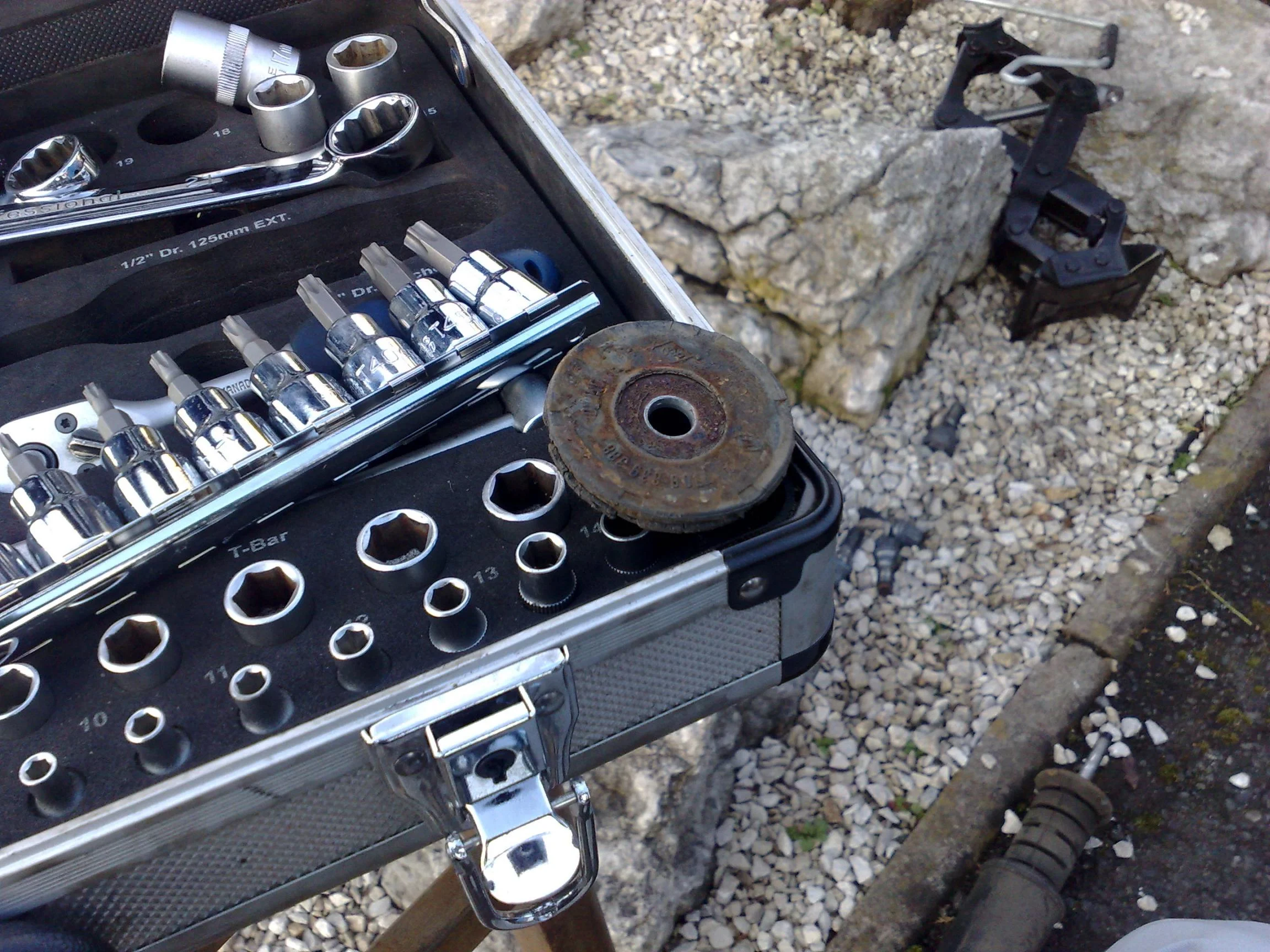

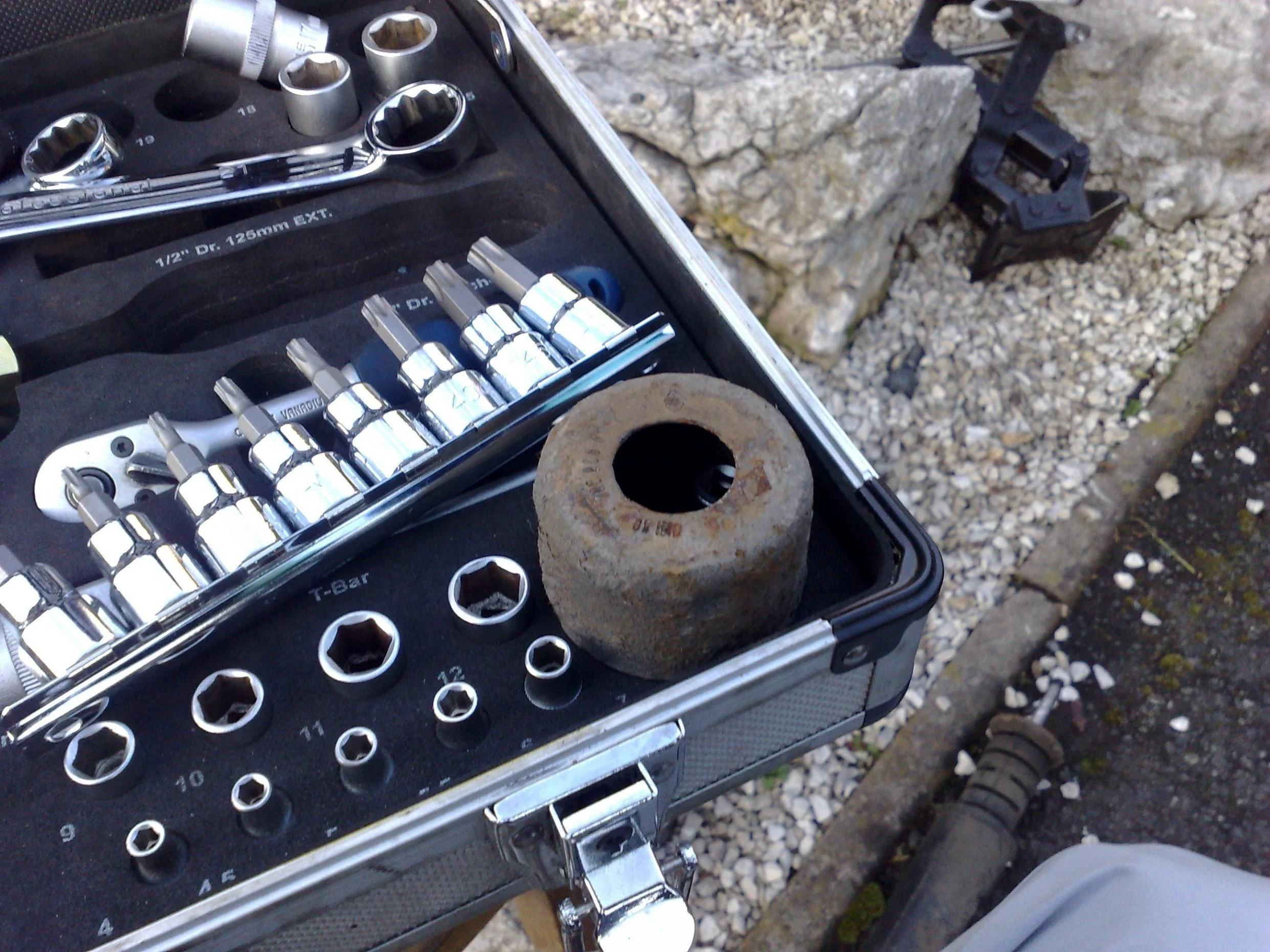

Also took these pieces of the old shock but didn't use them on the new shocks, just want to check that should be ok?

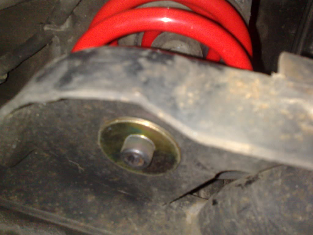

and one last question / concern, the bolt that holds the shock in place won't tighten fully??

The height adjuster on the back is incorrect.
Height Adjuster should go on the bottom. The Bolt and washer go through the axle and bolt into the adjuster to keep it in place.
Quite difficult to explain, im sure someone will come alone with pictures soon :)
The allen bolt holds the mount to the rear beam, the adjuster goes ontop of that (screws up/down) and the spring then sits on that.
Basically the rear platforms are upside down!
Which bolt wont tighten?
It's meant to go at the bottom of the spring, the other way round.
The bolt and washer goes through the hole in the Suspension beam.
What are those random rusty things?
The bolts that hold the shocks on?
Do you mean the ones in the boot?

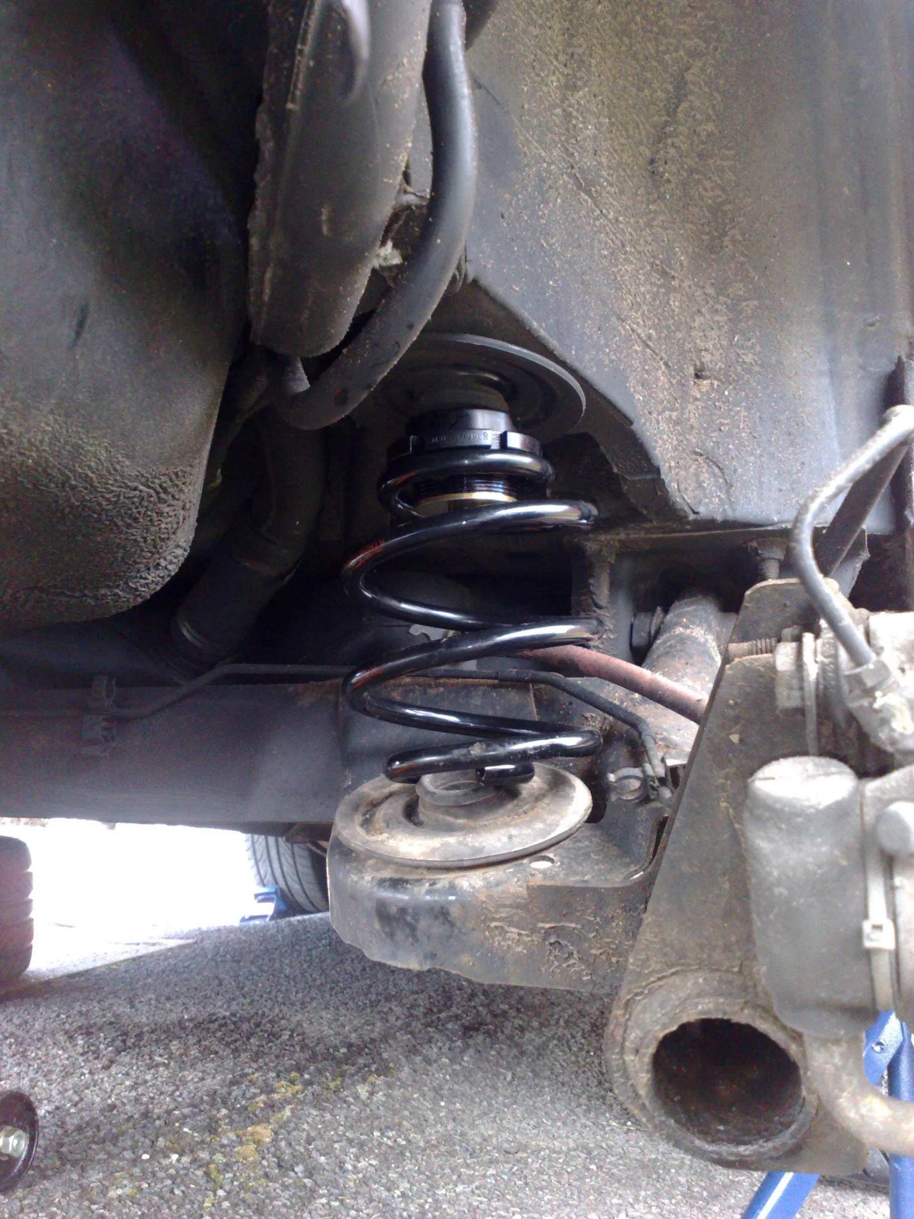

Edit: Just re-read your 1st post, are you driving it with the springs how they are on pic 3?

Da - originaly fitted them with adjuster at bottom, then tried other way around then left as was getting dark....will switch back again tomorrow and i think you know what you mean with the allen bolt holds the mount to the rear beam
Da - DrRollo - the bolts in the boot yes at the top of the shock! if that makes sense?

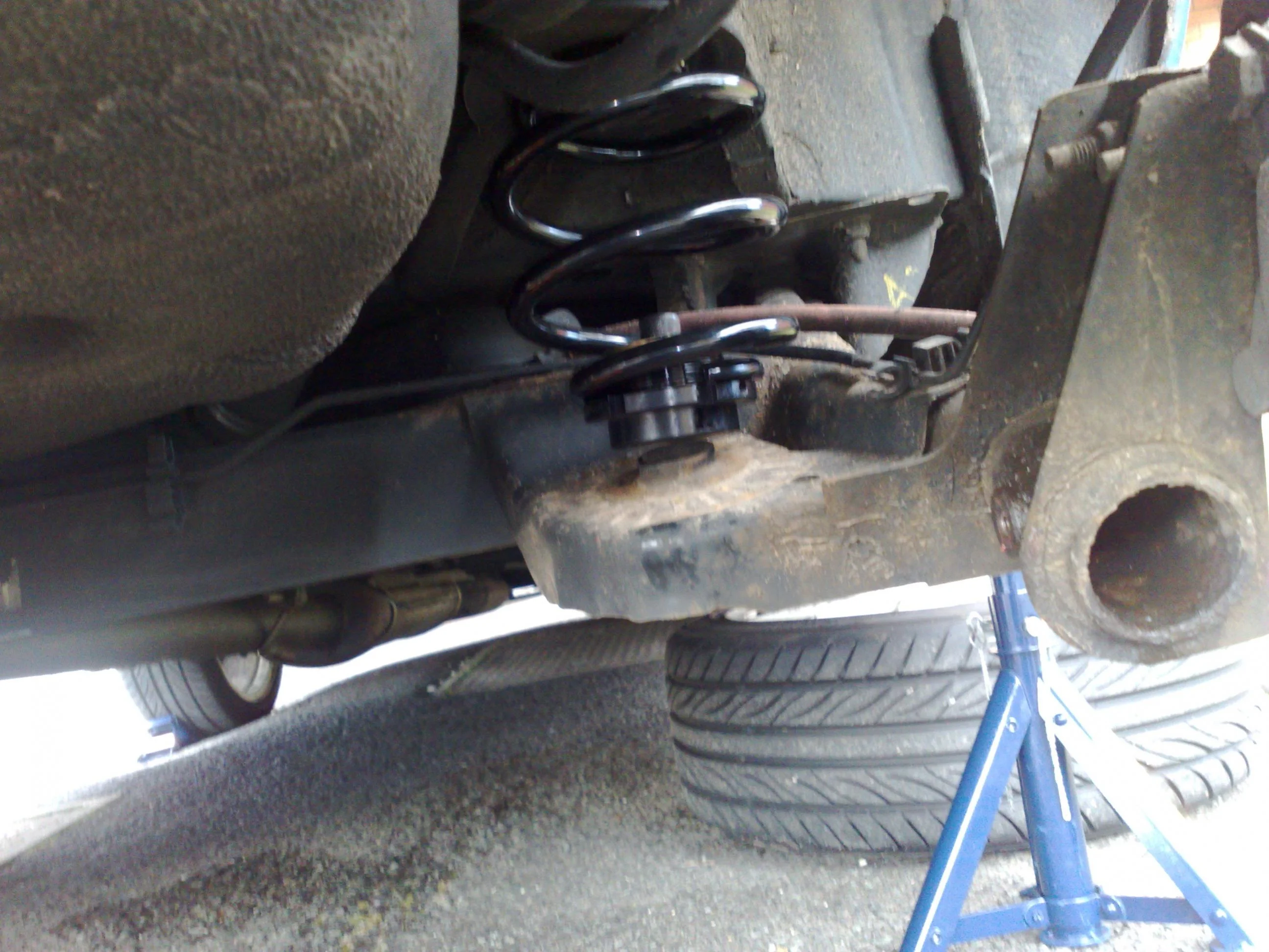

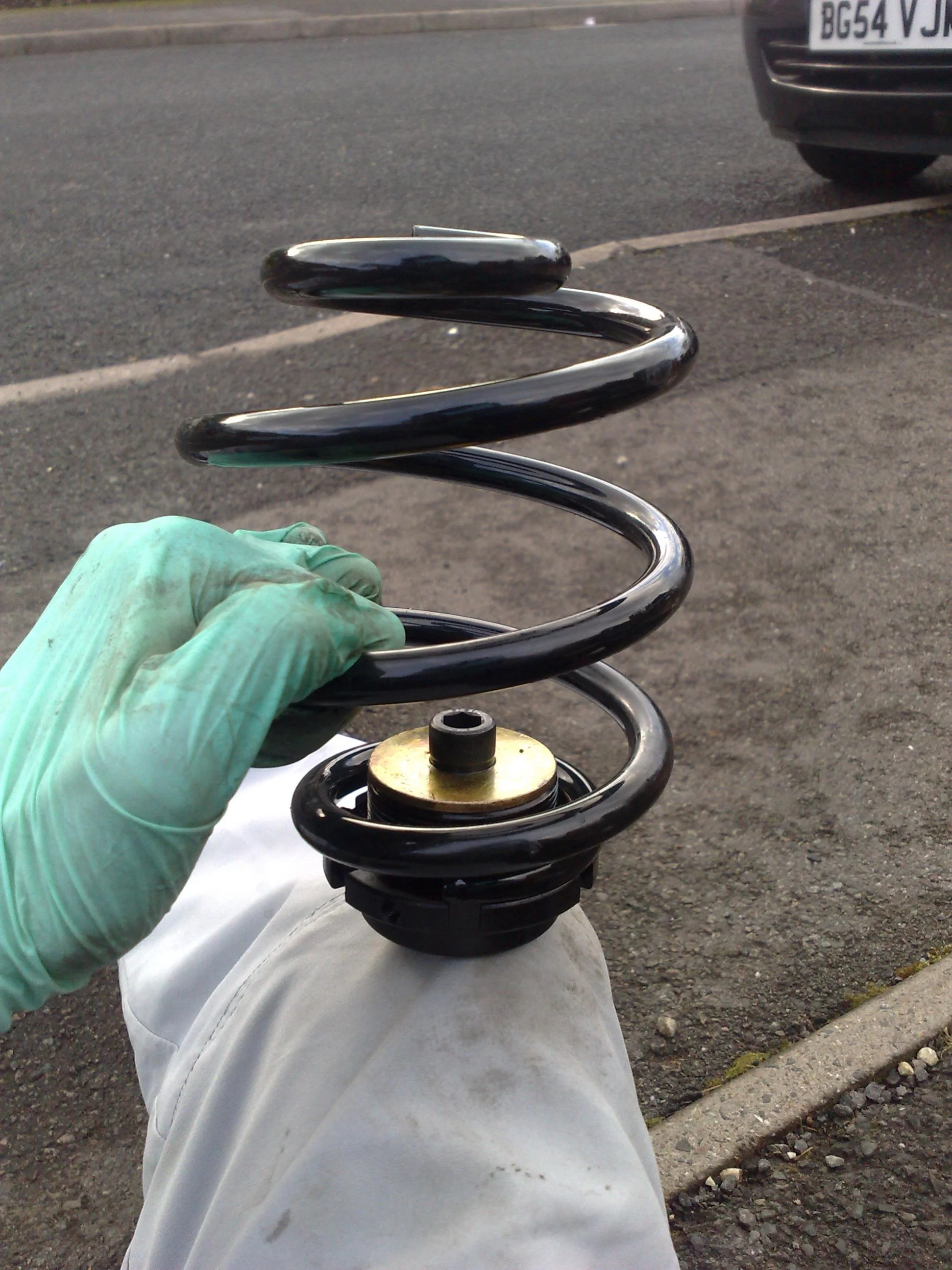

Kris , Da - big thanks for these pics, especially if you've taken the time to go and take them now! ....
this makes much more sense now!
